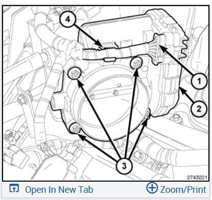

Electronic Throttle Control (ETC) Warning Light and not starting.
Jun 3, 2025 at 5:58 PM
  • 55,711 POSTS

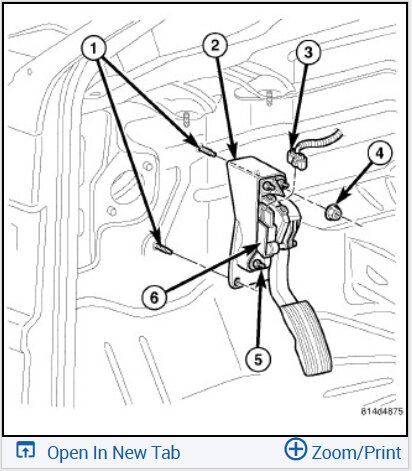

Yep, this is a failsafe warning due to a bad throttle body or accelerator pedal sensor failure. We need to run the codes to figure out which.
Most of the time shops will replace both at the same time FYI, here are the parts I am talking about. Check out the images (below). Please let us know what happens.

my best guess is the valve on the throttle body is closed and not being able to open because you can hear it wanting to start it just can't.
Jun 5, 2025 at 6:45 AM
  • 55,711 POSTS
Yep, in limp mode the butterfly will be closed. Let me know how it goes.
