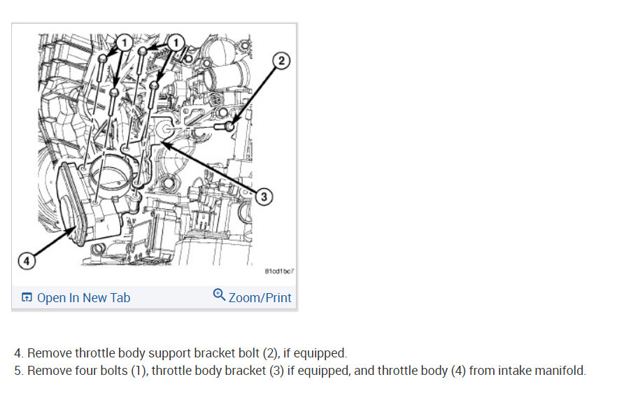

I recently changed the electronic throttle body about 2 months ago and here recently when I turn on my car it starts flashing and idling funny. I let the car warm up a little bit turn it off then I turn it back on and it works fine.
Dec 22, 2022 at 1:53 PM
  • 55,770 POSTS

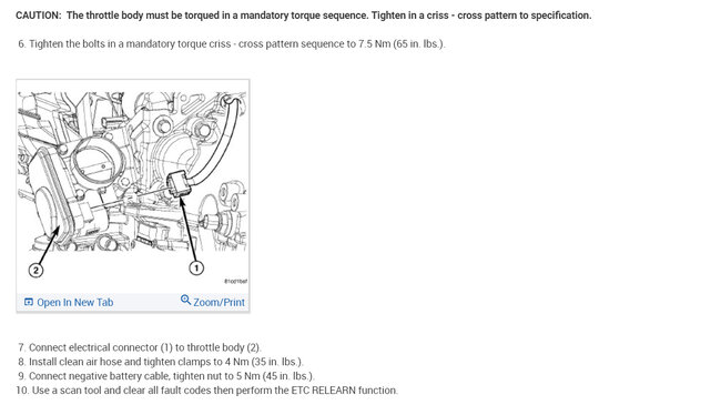

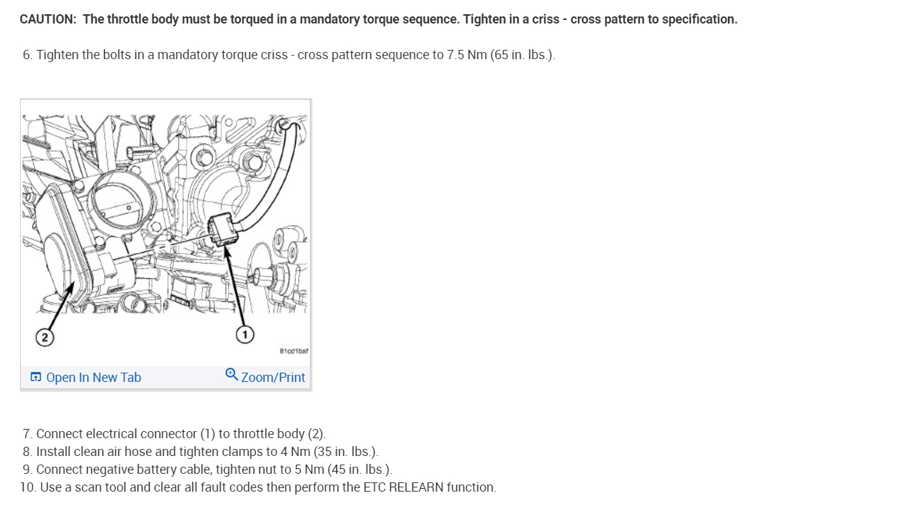

It sounds like you have a defective electronic throttle body. Was it an OEM replacement? We should run the codes to see what comes up.
Here is a guide to help:

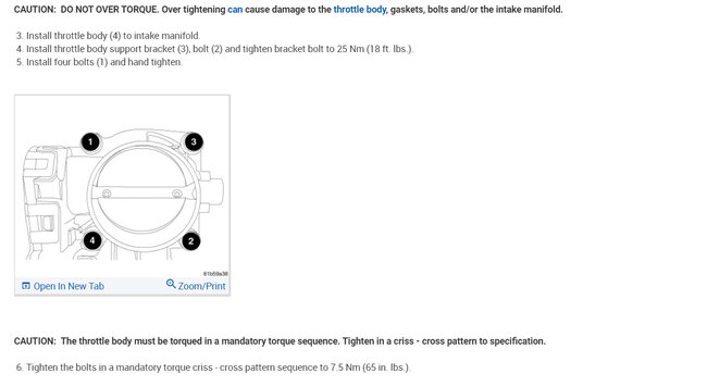

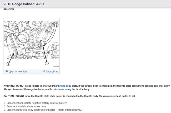

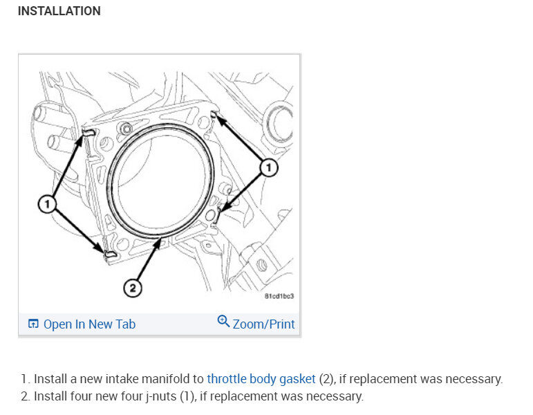

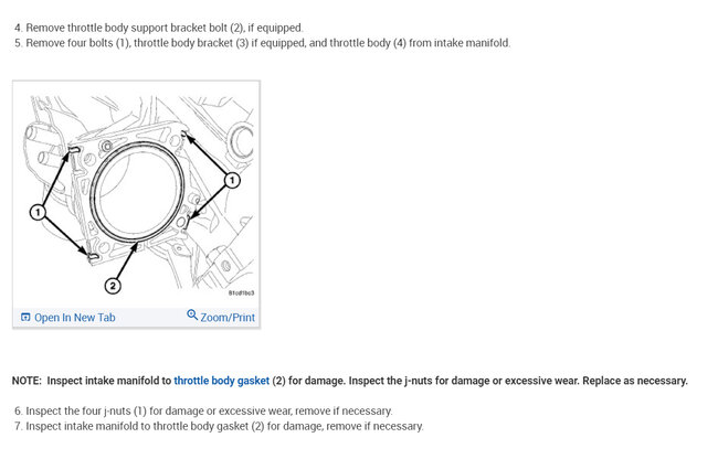

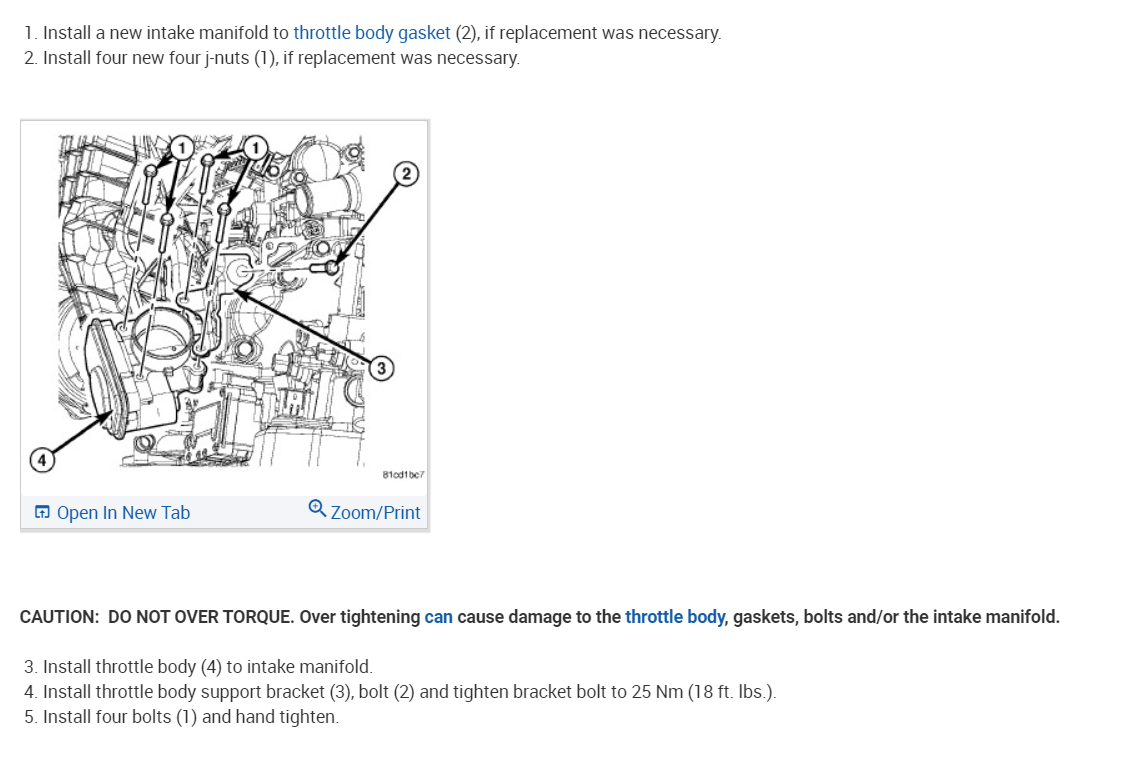

Here is the instructions on how to replace the throttle body in case you need them. Check out the images (below). Please let us know what happens.
