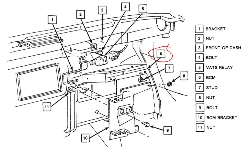

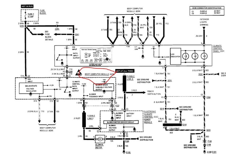

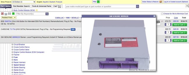

The body control module is the most common cause of this issue. It was very common for it to fail and the displays would go blank.
https://www.2carpros.com/articles/how-to-replace-a-bcm-body-control-module
I attached the diagram of it and the procedure for replacement. Rock Auto has the part and I attached that as well.

6. Glove box module.
7. Nuts securing passenger compartment discriminating/arming sensor pigtail wiring and resistor module to Diagnostic and Energy Reserve Module (DERM) / Body Control Module (BCM) bracket and position aside.
8. Nuts from BCM studs.
9. Screws from DERM/BCM bracket and bracket.
10. Electrical connector and body computer module BCM.
