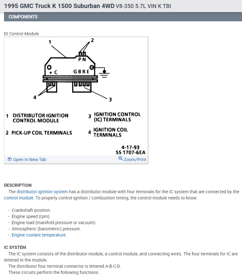

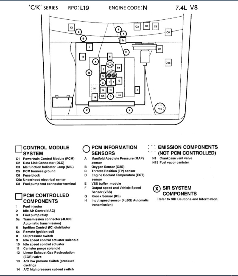

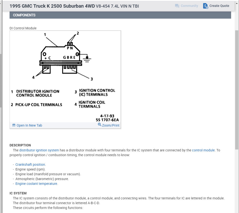

I am trying to find this part and I don't even know where it is located on my vehicle.
Oct 15, 2021 at 12:42 AM
SQM
  • 6,383 POSTS
The ignition control module is mounted next to the ignition coil. You will have to remove the intake tubing from the throttle body to access it.

I have a 454 engine and a k2500 4wd Suburban not a pickup and definitely not a 350 engine.

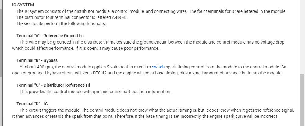

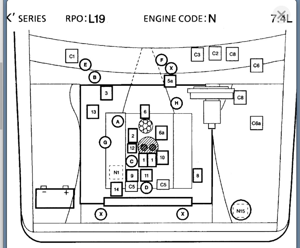

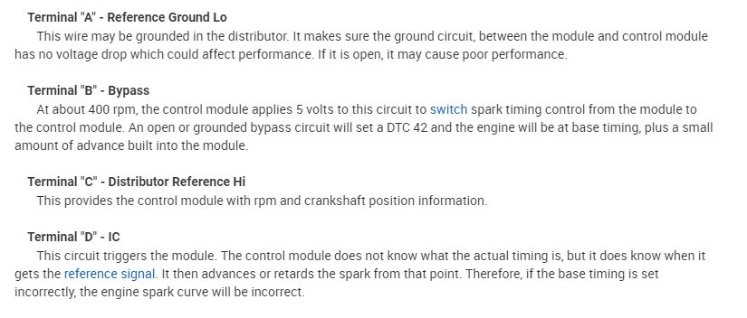

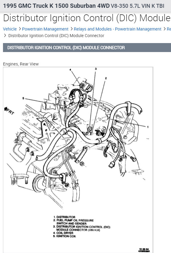

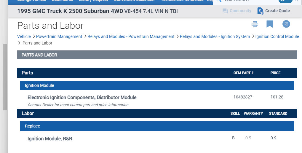

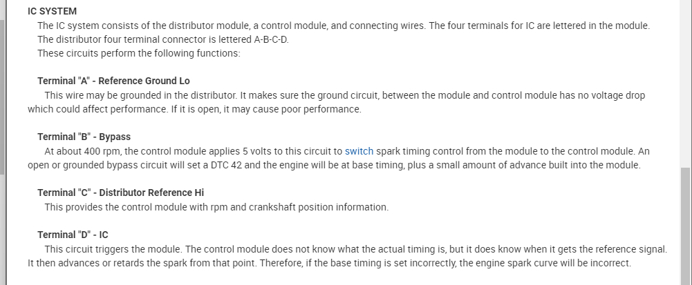

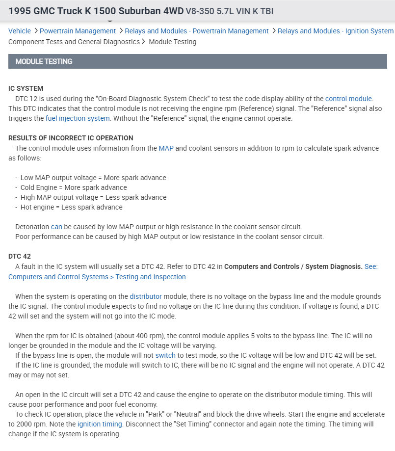

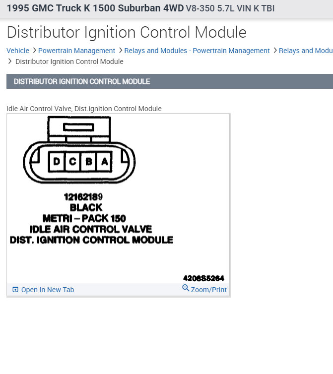

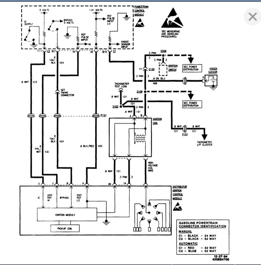

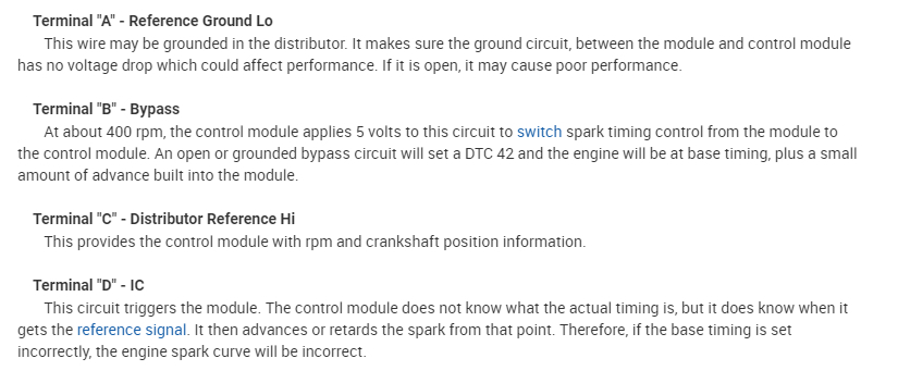

I am attaching the info needed for this engine. Please run through this material and let us know if you need more.
Thanks
