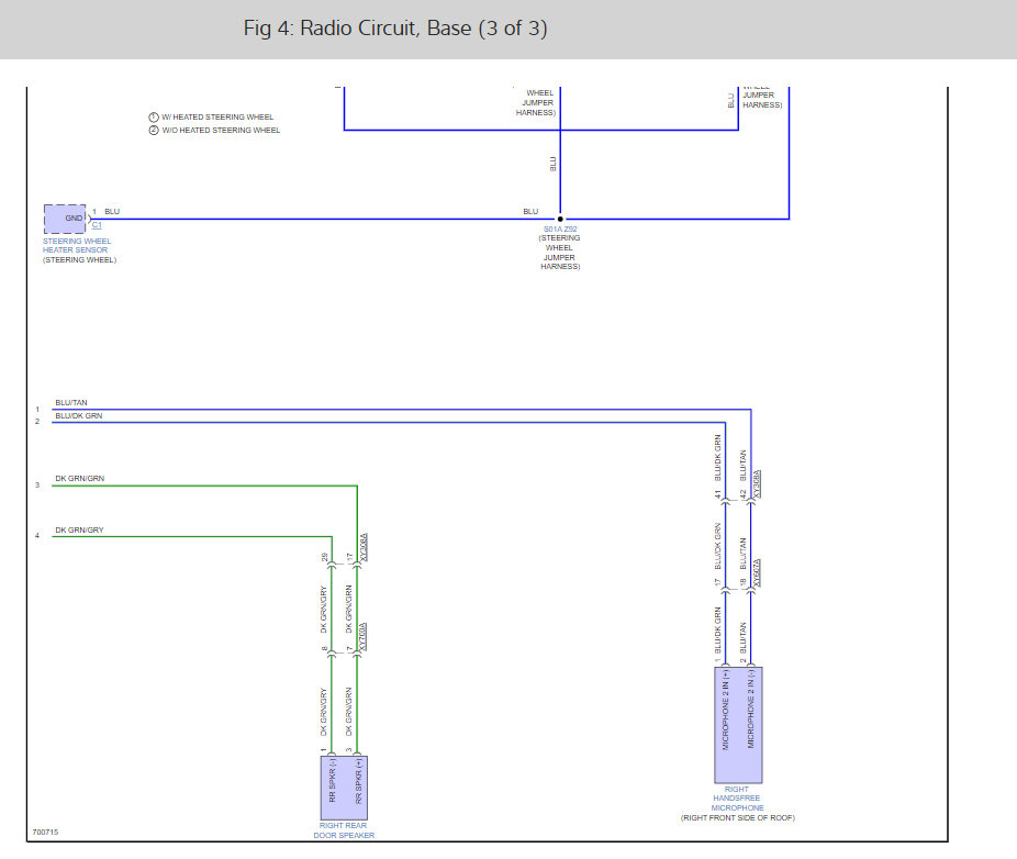

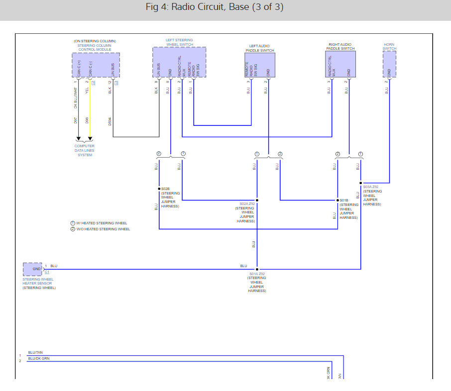

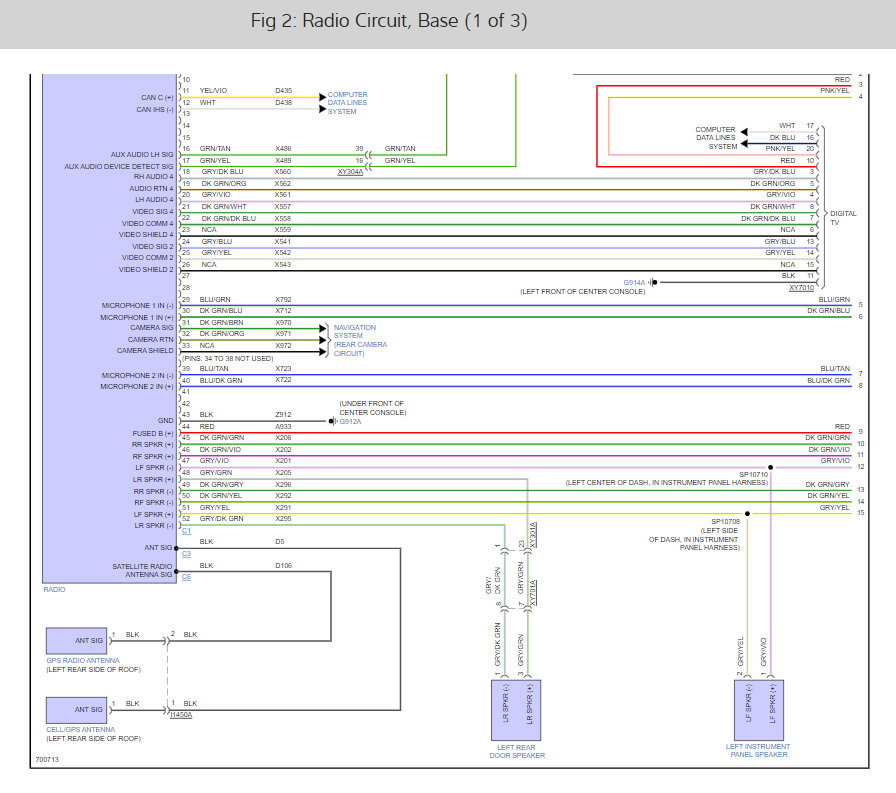

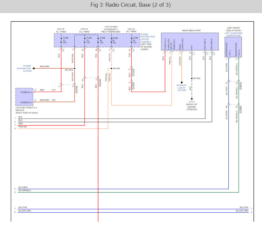

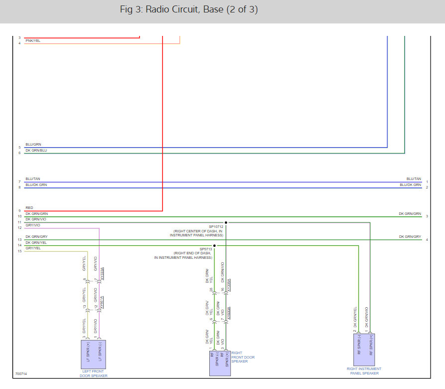

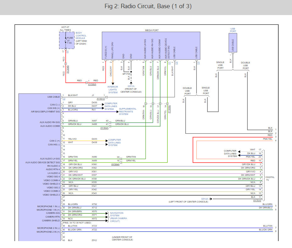

Hey, it happens. Newer cars don't like to alter their systems because the Media Port or CAN (controller area network) is included in the radio so now the system is disrupted. Do you have a radio wiring adapter for the car and does the radio say it will work in your car with the correct year? If not, it will be difficult to get the radio to work. Here are the radio wiring diagrams so you can see how the system works and what I am talking about. To find out what is going on though you can do a CAN scan which is easy, you can get a CAN scanner from Amazon for about $30.00.
