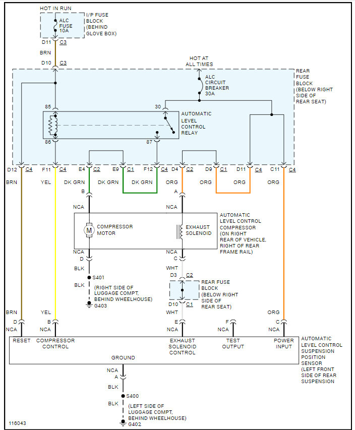

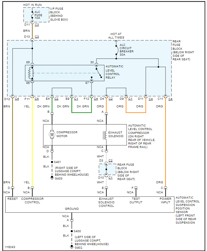

I'm working on my car listed above Base. except for the supercharger on the Ultra model, all items on the Base are basically the same.
I need Electronic Level Control "compressor side" female wiring schematic, as well as vehicle side schematic.
I am replacing my wiring connectors to the air strut compressor motor assembly, and mistakenly cut the compressor side connector off before realizing there are two white wires so now, I don't know which white wire goes to which factory wire.
Vehicle side male connector has: Blk, Grn, Org, Whi wires.
Compressor has: Blk, Blk/Grn, Whi, Whi wires.
I believe the two white wires on the compressor go to the exhaust solenoid. I need to know which to connect to the orange wire.
The factory harness male connector side.

Sure, here is the wiring diagram for the autoride system for your car. Also, this guide can help you test the connections:
Check out the images (below). Let us know if you need anything else.
