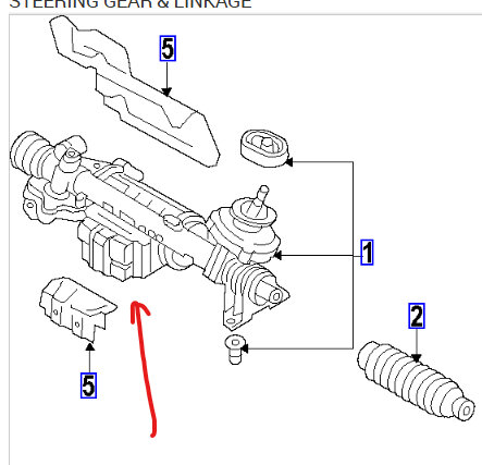

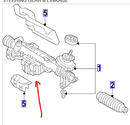

Hi I had a crash with my car. After fixing, the steering wheel is stiff and can't remove steering warning
Oct 1, 2025 at 11:58 PM
  • 55,604 POSTS
Yep, an accident can take out the EPS system which is very common, here is the part you need to replace. Check out the images (below). Let us know if you need anything else.
