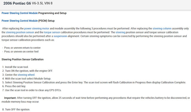

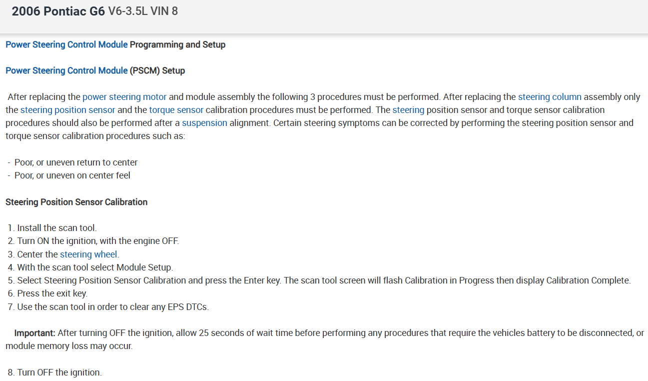

Steering wheel is locking up. Electronic power steering issues, steering wheel is locking up?
Dec 4, 2024 at 6:28 AM
  • 55,711 POSTS

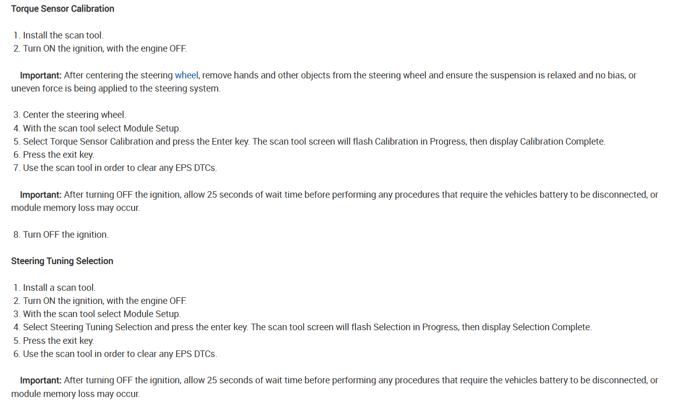

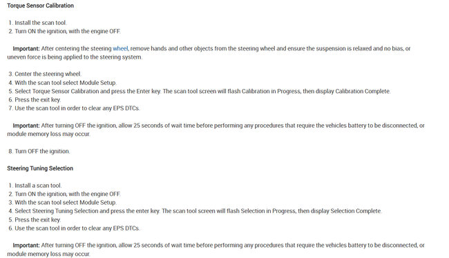

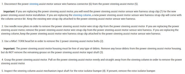

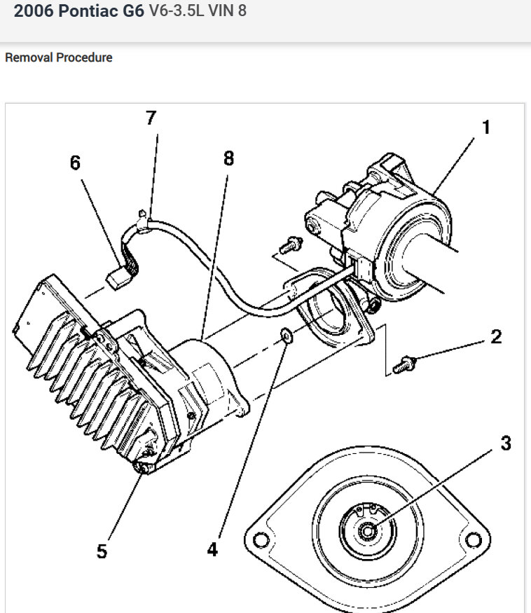

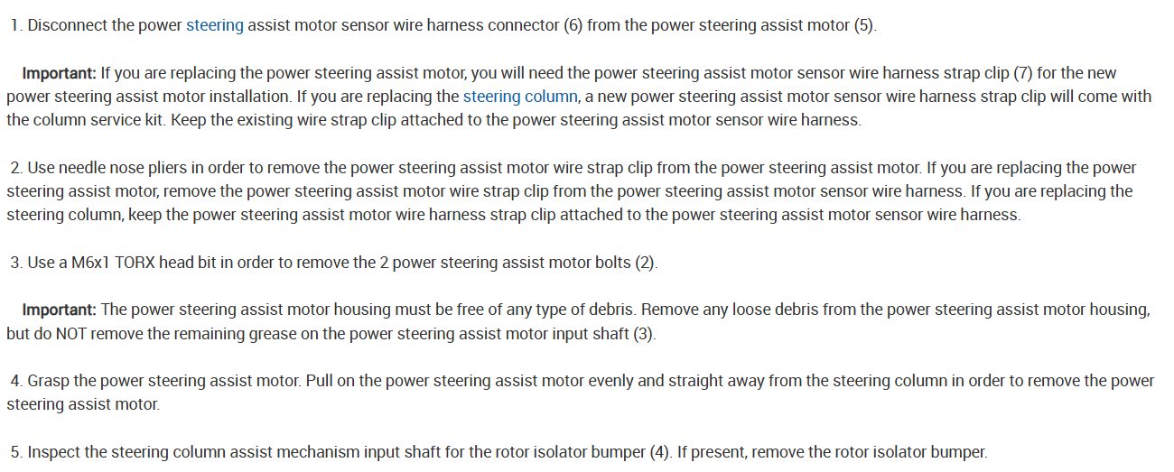

Yep, this is common when the power assist motor goes out, here is how to change it out and program it to help fix the problem. Check out the images (below). Let us know if you need anything else.
