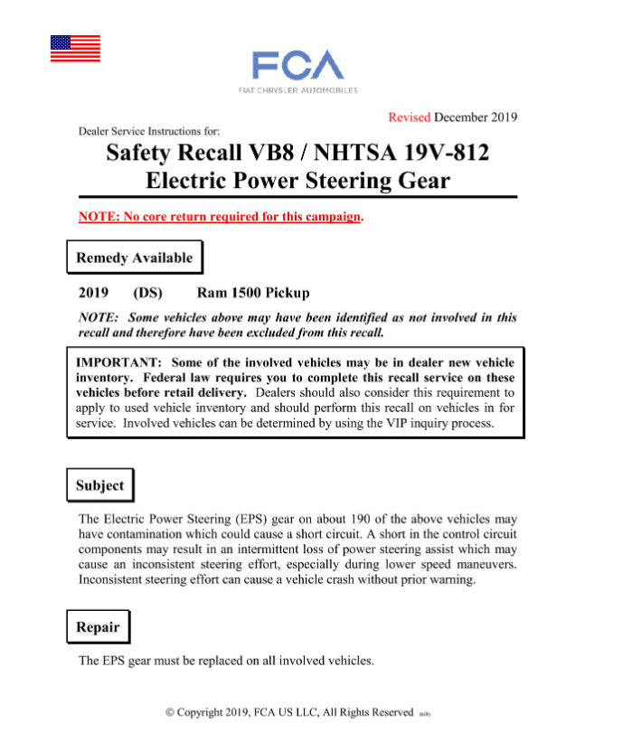

The problem is continuous and not intermittent. Loss of power steering occurred while sitting still.
Nov 30, 2022 at 4:38 AM
  • 55,694 POSTS

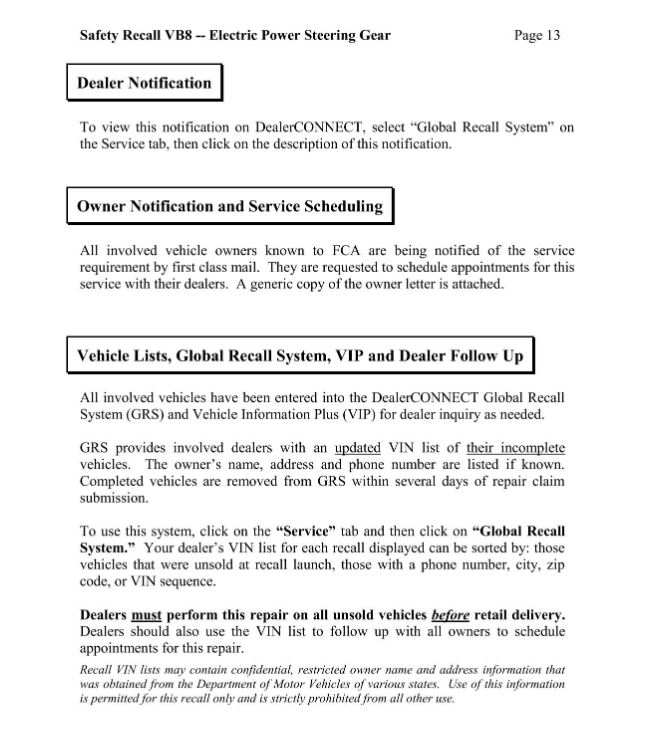

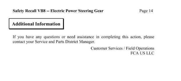

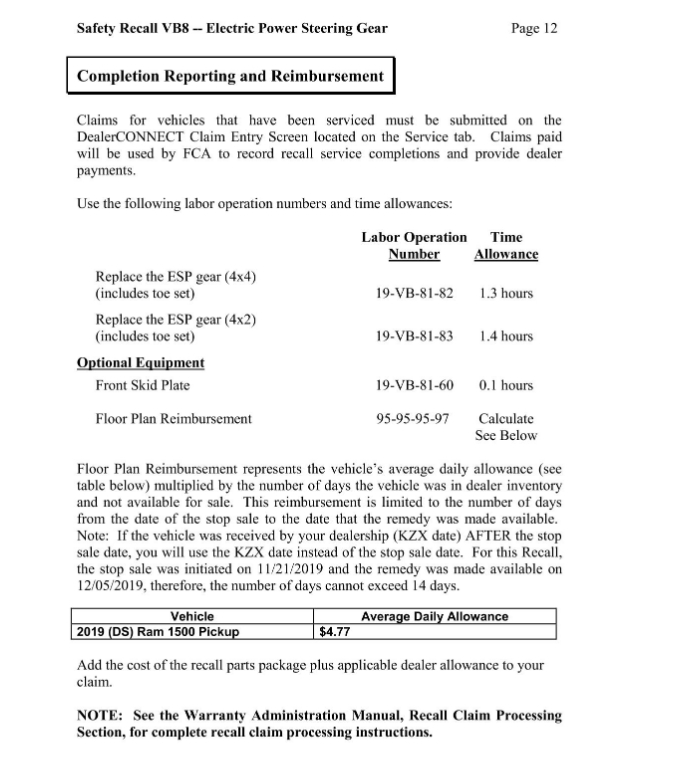

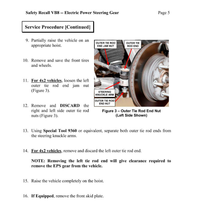

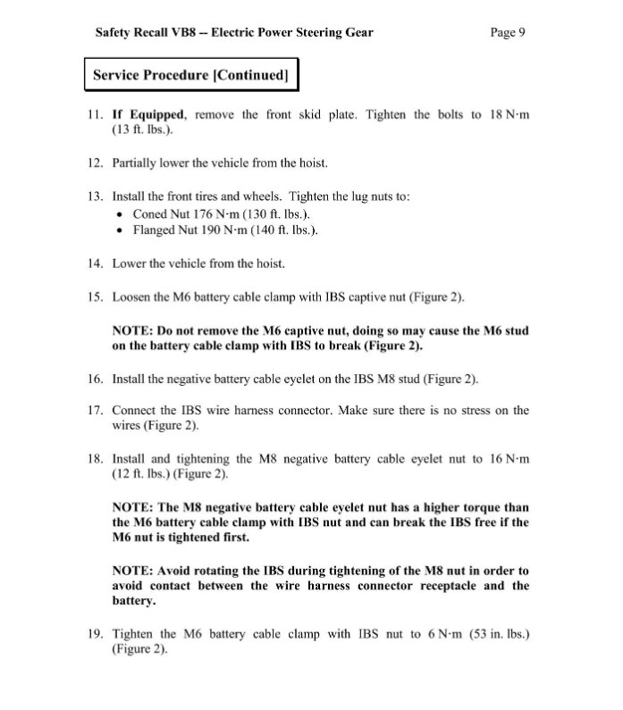

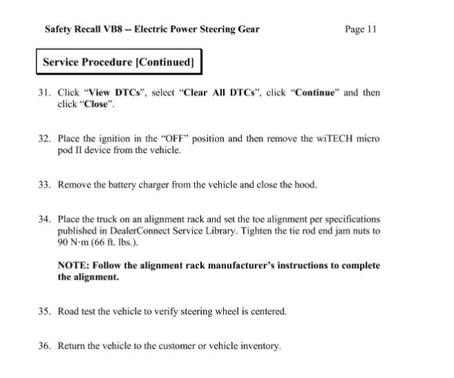

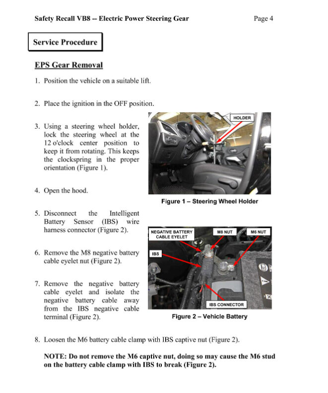

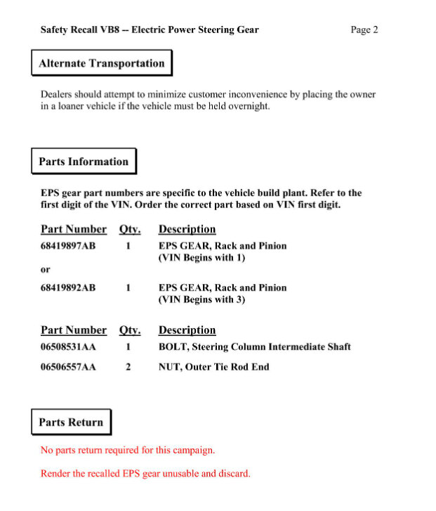

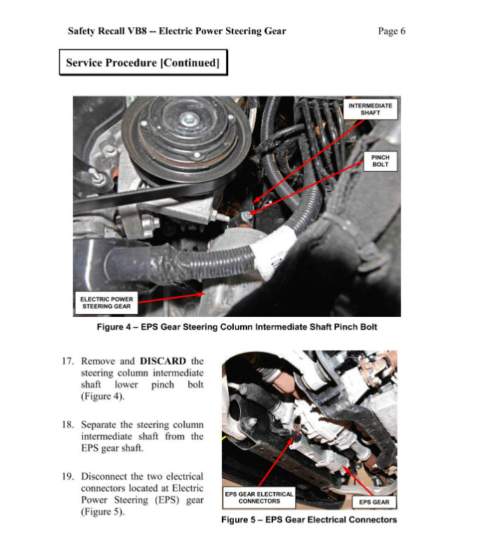

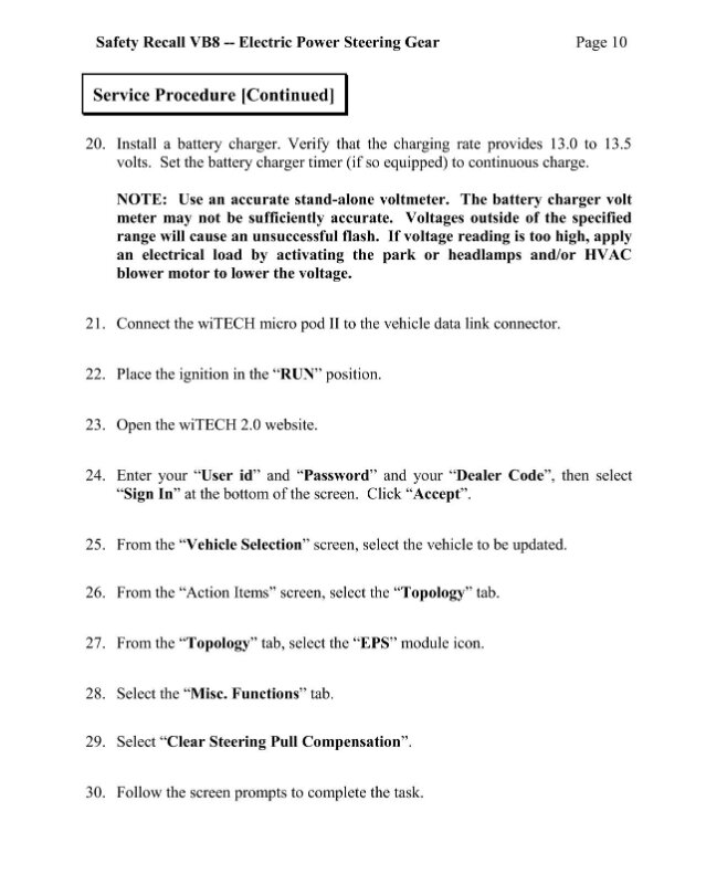

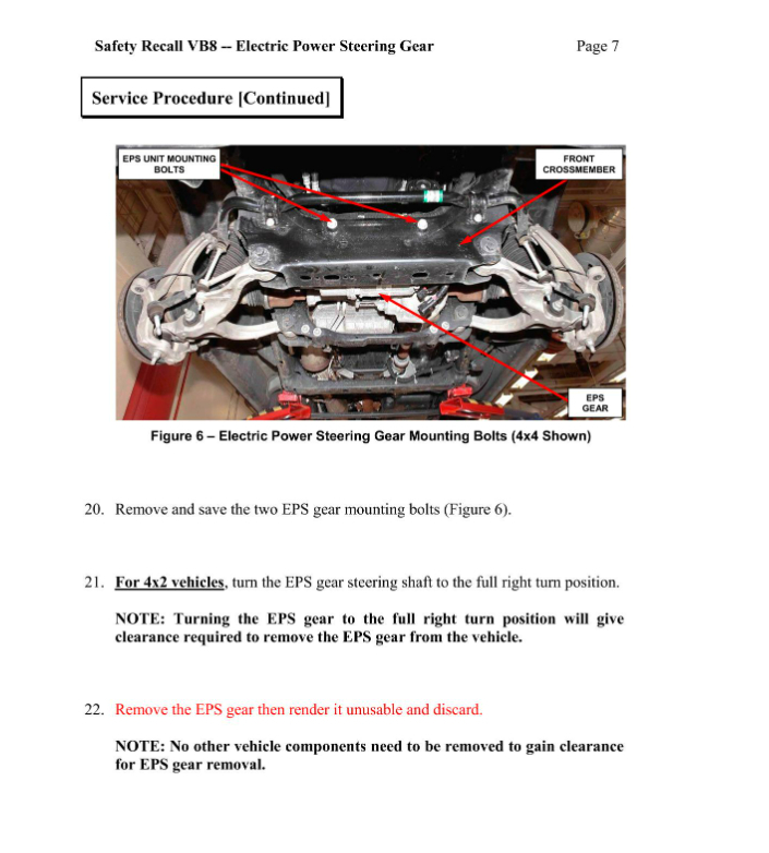

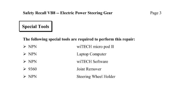

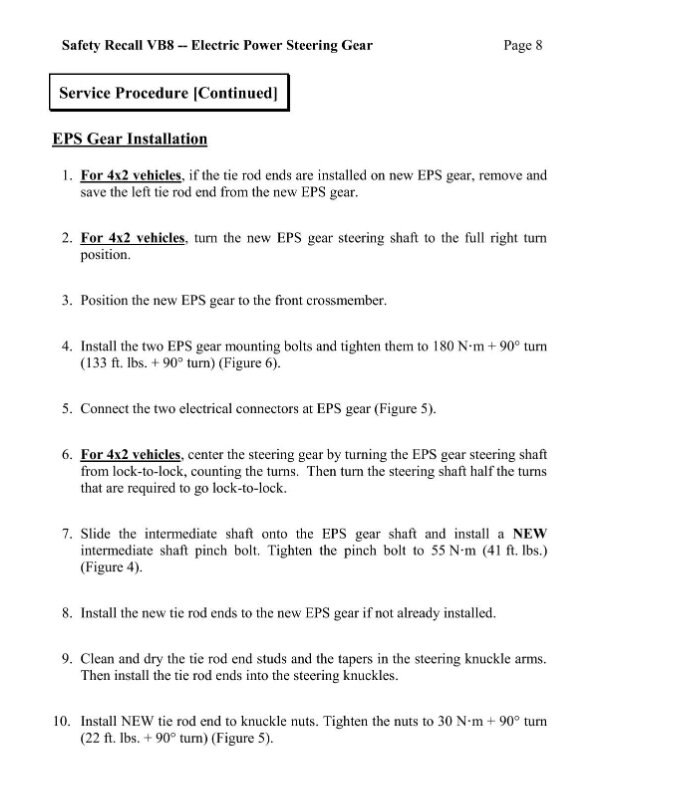

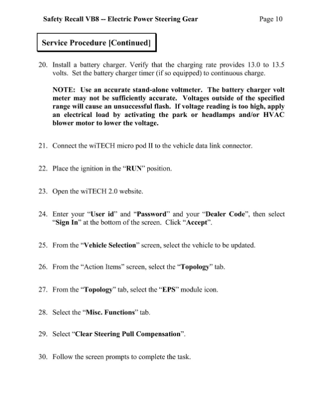

It would be best if we ran a CAN scan, but it sounds like the steering gear has gone out. There are even three TSB's (technical service bulletins) that are out for the dealer to fix for you by replacing the steering rack for free. You can get a CAN scanner (Controller Area Network) from Amazon from about $32.00.
https://youtu.be/u-4syLc-ifQ
and
Check out the bulletin in the images below. Check out the images (below). Please let us know what happens.
Dec 1, 2022 at 7:59 AM
CWHITT877
Thank you for your feedback. Unfortunately, this truck isn't on the recall list. Will look into purchasing the scan controller.
