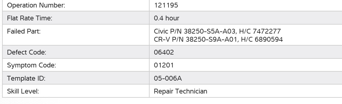

Hi, I have a code P1298. Can I just replace the ELD instead of the whole fuse box? I ask this because on my model Civic witch is the LX 2 DR Coupe they only list the fuse box and not the ELD separately But I do have the correct part # for the Civic 38255-S5A-003 What do you think? Thanks for your time.

there was a tsb on this which said to replace eld as the old one had a faulty solder joint. here is number we have but may be same thing.

Thank you! I found the bulletin for the Civic 05-006 for your future referance. Thanks for your help,have a great day.
