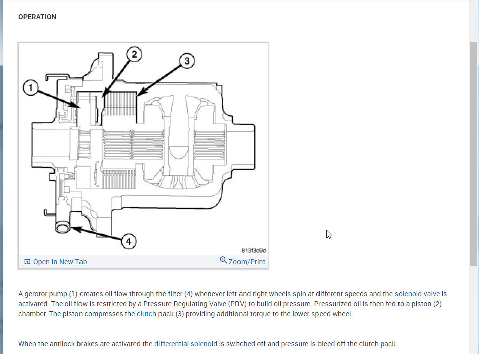

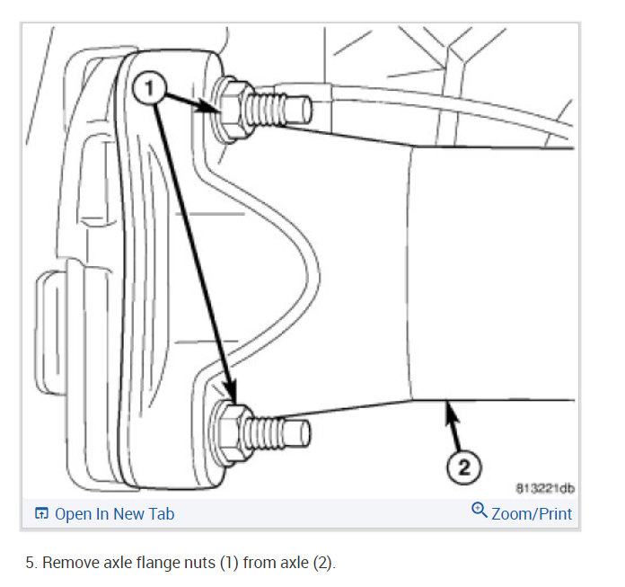

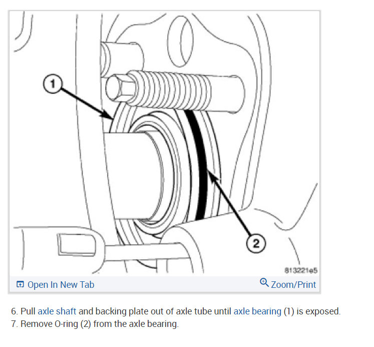

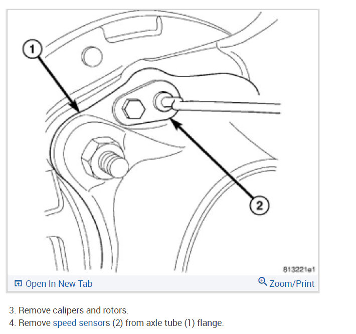

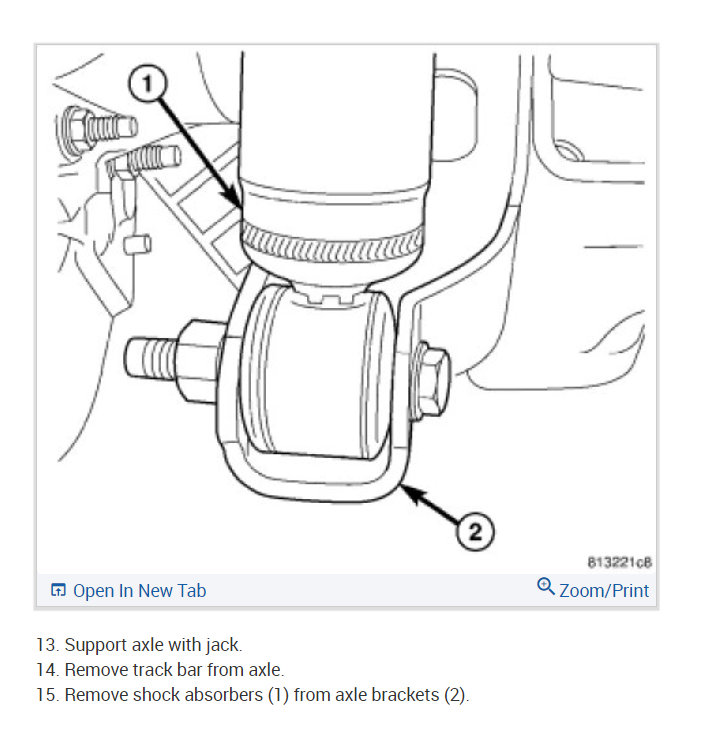

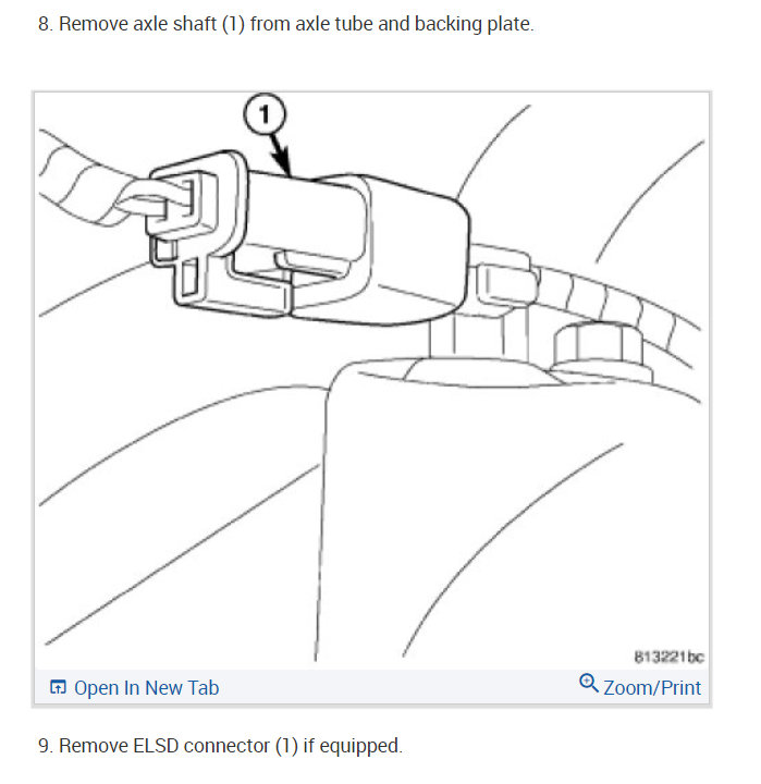

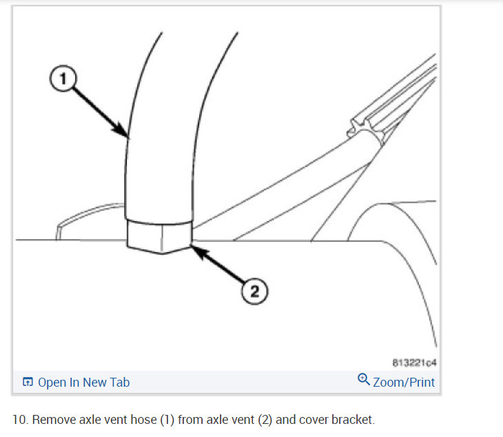

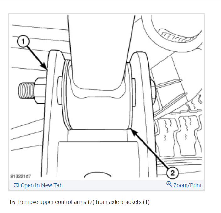

Can an electronic limited slip rear end be replaced with a non electronic limited slip rear end without messing up the computer?
Jan 17, 2021 at 11:23 AM
  • 55,433 POSTS

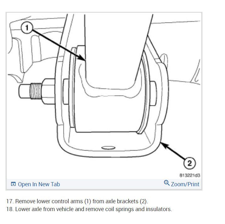

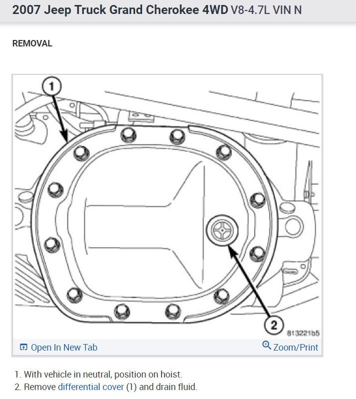

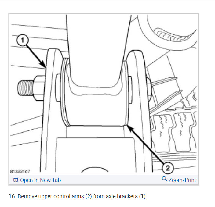

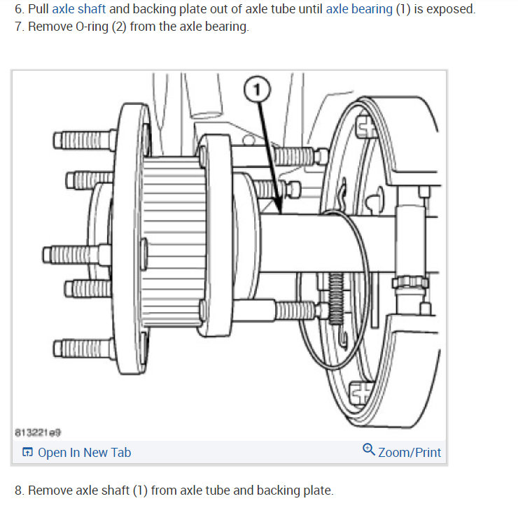

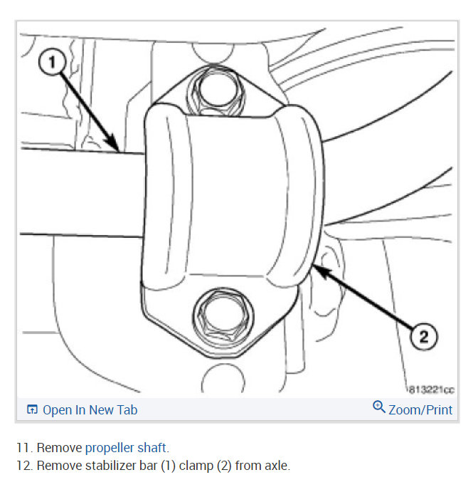

Nope, you must have the same type or there will be a non stop trouble code in the car. Here are instructions in the diagrams below on how to change out the rear differential. Check out the diagrams (below). Let us know what happens and please upload pictures or videos of the problem.
Jan 18, 2021 at 11:37 AM
It will not mess the computer up but you will have a check engine light on. You will not have the solenoid to plug in so you will have an open circuit.
Is there a reason that you don't want to replace this with the same rear that comes in it?
I attached the info below on how this works and that may better explain what could happen.
Let us know and we can go from there. Thanks

The rear ends that I have found are a lot more expensive with the E LSD. That was the only reason I was asking.

MARCUS
rear end removal
Jan 20, 2021 at 5:07 AM (Merged)
  • 110,244 POSTS
If you are refering to the rear axle and differential, jack the car up and secure it by the frame. Next, you will need to remove the drive shaft, all brake lines, any wiring... from the axle. Finally, remove the U-bolts that hold the axle to the leaf springs. NOTE: Suppot the axle assembly when removing the U-bolts. It will drop when the bolts are removed.
