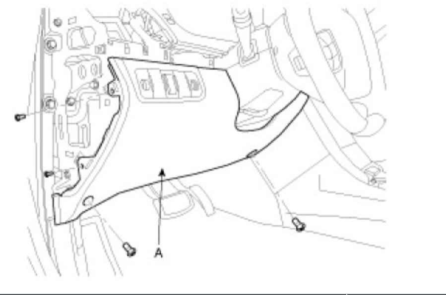

I'm trying to figure out why the switch doesn't turn back after car cranks and it keeps trying to start after but if I slightly touch it myself it will stop. I tried spraying in the switch a few times but sometimes it still does it. I want to know exactly what part do I need to change. Is it the whole switch assembly or a certain part?

Good afternoon,
You will need the switch assembly itself. The issue is internal.
https://www.2carpros.com/articles/ignition-switch-wont-turn-stuck
I attached the procedure with some pictures for you to view.
Replacement
1. Disconnect the negative (-) battery terminal.
2. Remove the crash pad side cover (A).

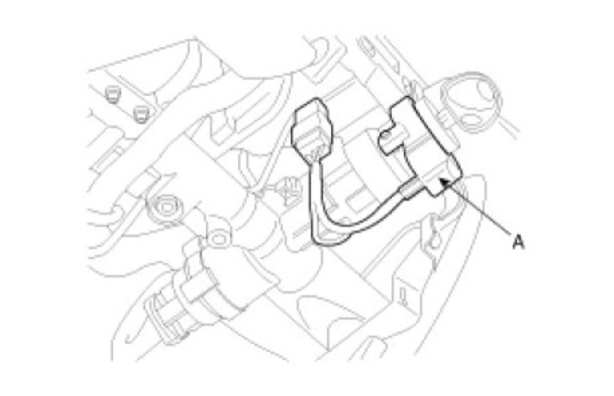

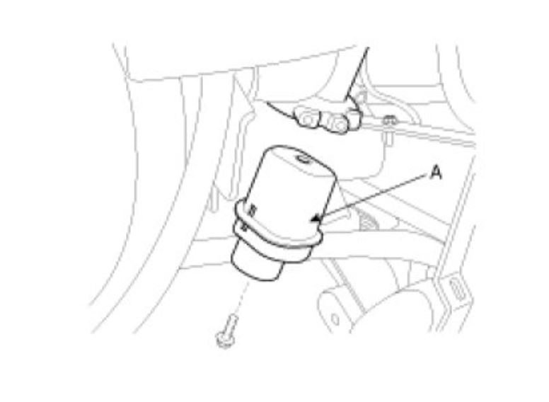

3. Remove the ignition switch (A) after loosening the screw and disconnecting the 6P connector.
4. Remove the steering column shaft .
5. Remove the key warning switch and key illumination lamp (A) after loosening the screws and disconnecting the 6P connector.

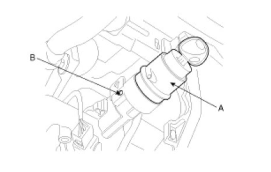

6. If it is necessary to remove the key lock cylinder (A), Remove the key lock cylinder (A) after pushing lock pin (B) with key ON.
7. Installation is the reverse of removal procedure.
