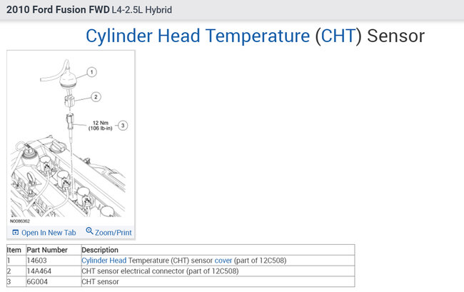

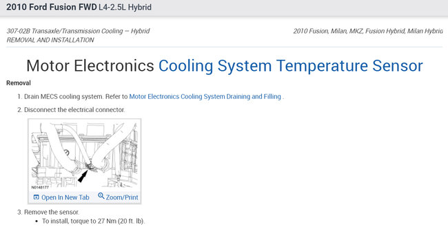

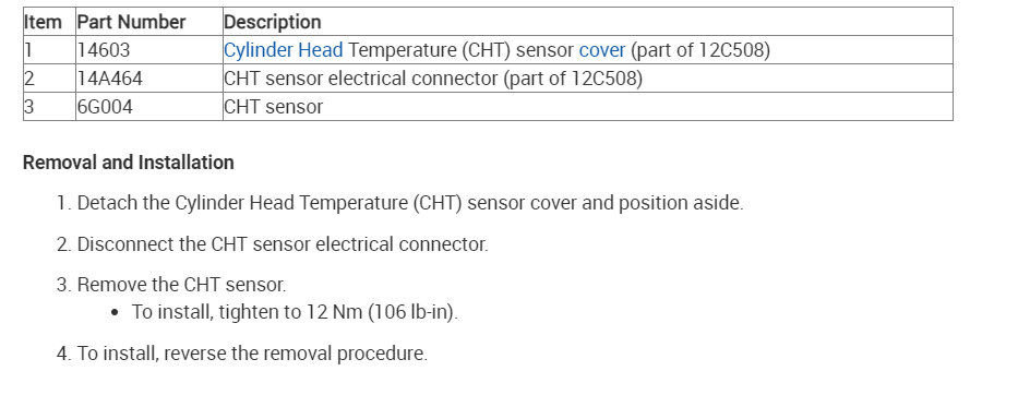

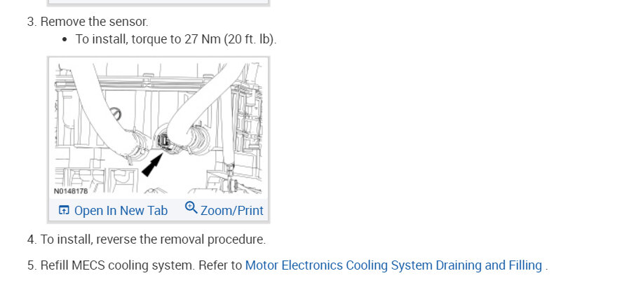

Where is the electronic coolant temperature sensor located?
2010 FORD FUSION HYBRID
150,000 MILES • 2.5L • 4 CYL • 2WD • AUTOMATIC
TJVR4
I'm looking for the location of the Electronic Coolant Temperature Sensor (Part# 3F1Z-12A648-A) and I believe it's the sensor for the auxiliary motor/Electric.
Jul 31, 2023 at 1:07 PM
  • 55,433 POSTS
Here are both coolant temperature sensors so there is no confusion on the location of the sensors. Check out the images (below). Please let us know if you need anything else to get the problem fixed.
