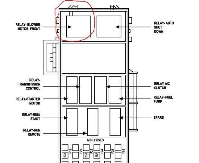

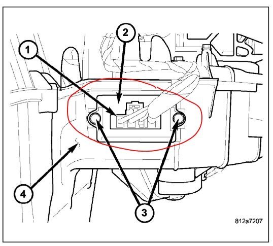

A bad motor can cause it. However, if the resister was bad, under normal conditions it will still work high. Also, the relay could be bad as well.
I attached two pictures. The first shows the resister and the second the relay location.
Here is a link that explains how to check a relay:
Let me know what you find.

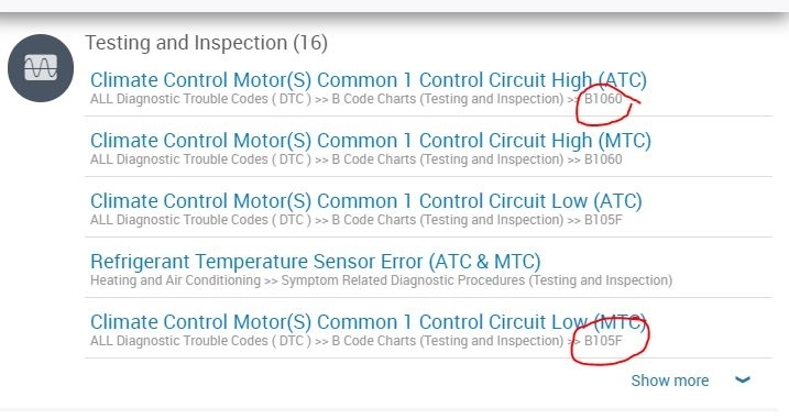

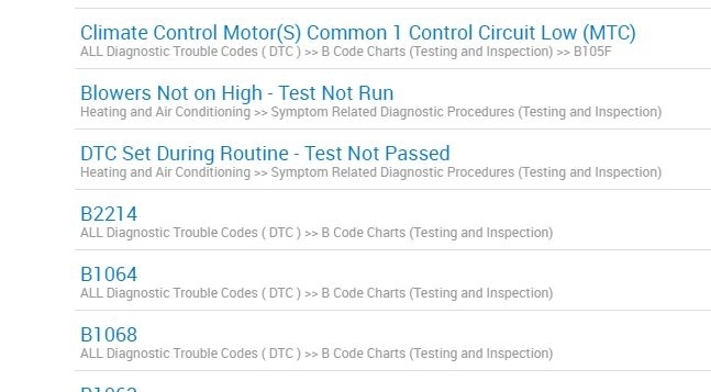

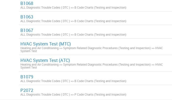

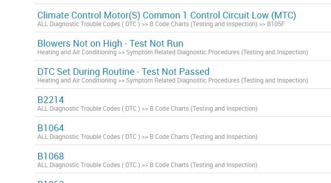

Welcome back:
It is possible. I hate to say it, but I feel the computer needs scanned for codes. This vehicle will provide codes related to the HVAC system. They are different than the typical P type engine codes. The problem is a scanner that can read all codes is needed. By any chance can you gain access to one? My concern is although I feel you may be right, I would hate to see you replace the module and find it isn't the issue. If I recall, it isn't a cheap item. Just to let you see what I see, look at the attached pics. They are specific climate control concerns. Each one is related to a different code. If you see anything there you feel fits what you are dealing with, please let me know. I'll be happy to provide the diagnostics for it.
