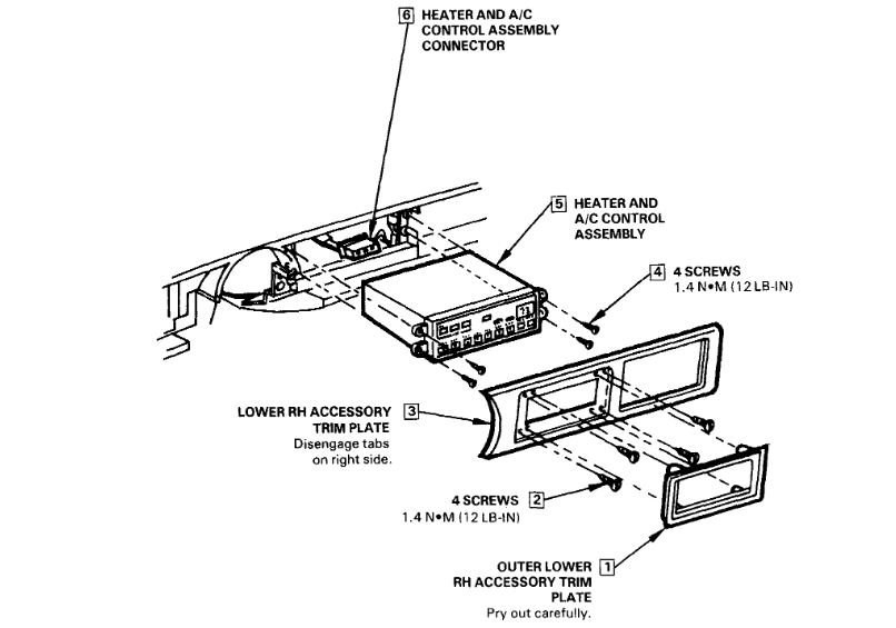

Hi, hard to set to specific temperature. can get hot or cold but in between temperatures are difficult to regulate.
Apr 13, 2019 at 8:15 PM
Good morning,
The lights are internal in the control head and are not serviceable. The control head would have to be replaced.
I attached a picture of the control head and it is not hard to remove.
