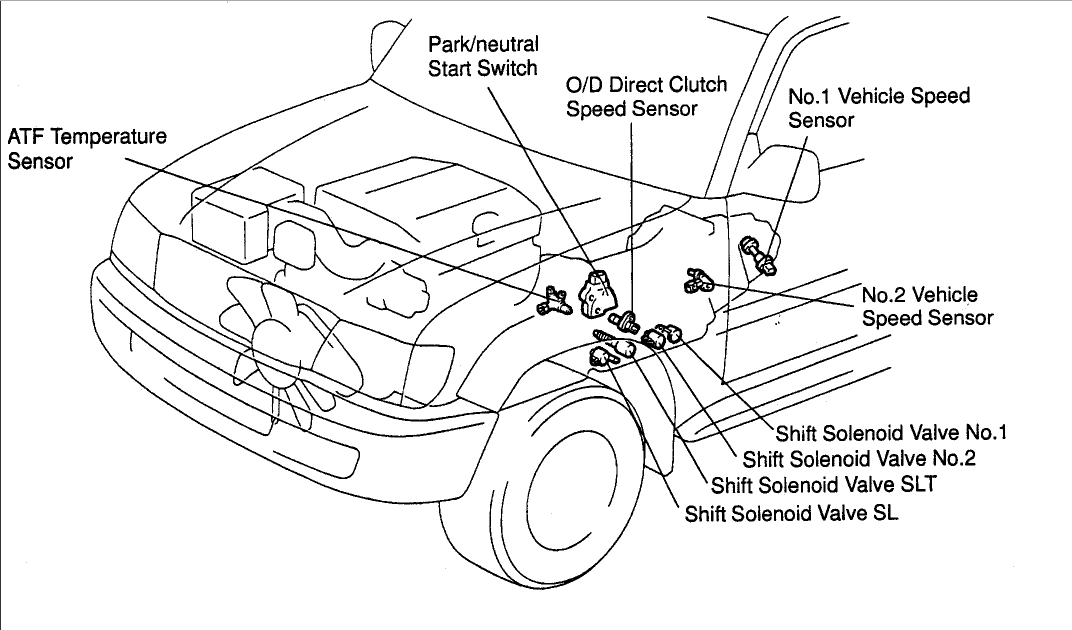

Transmission jumping first to third mostly. Sometime works properly. I think it is electric component failed, could be solenoid or one of sensors.

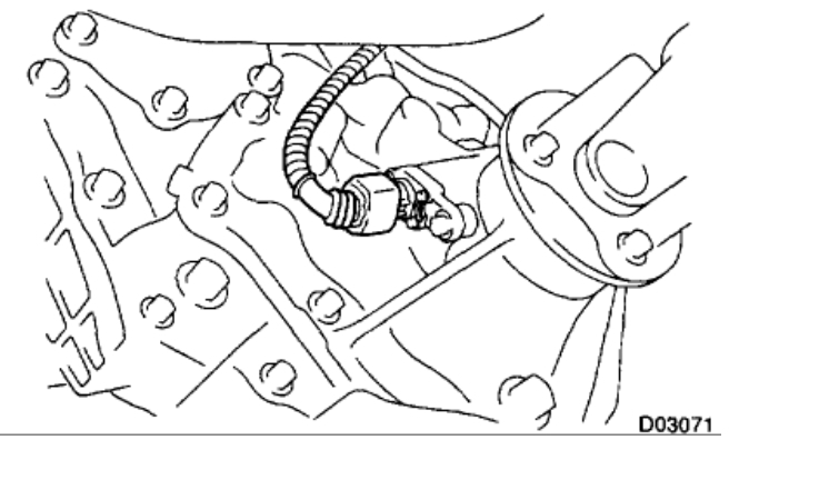

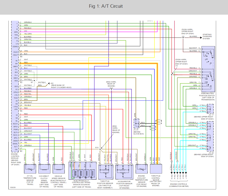

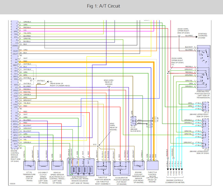

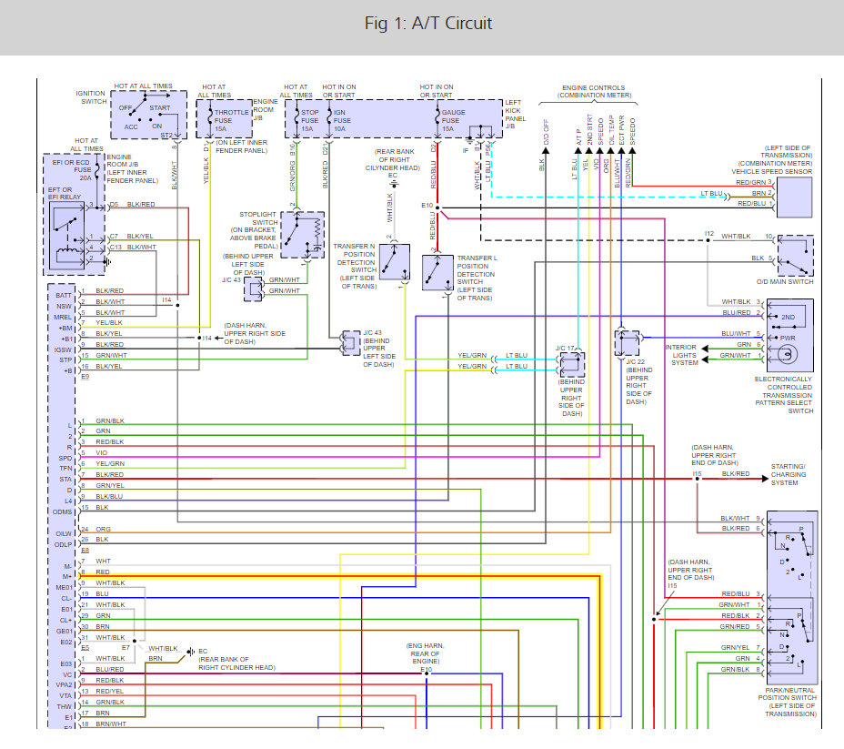

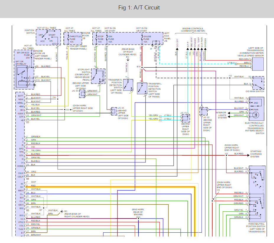

It sounds like you have a shaft speed sensor that is going out. Here is the locations so you can check it out. Also the shift solenoid could be shorting out as well. Here is a transmission wiring diagrams so you can check signals to the shift solenoids.
and
Please run some tests and get back to us.

GUEST037
Wiring connector was failed
