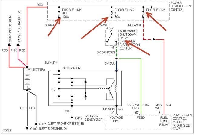

I hav 94 dodge ram 5.2,I changged the 4 relayI in front
May 15, 2013 at 12:11 AM
HMAC300
Experienced Mechanic
48,601 POSTS
what is the question
May 15, 2013 at 12:29 AM
JLOBAINA
MEMBER
18 POSTS
would like to kno why there is no electricity from distribuidor to the ignition coil when I turn ignition switch?
May 15, 2013 at 12:45 AM
HMAC300
48,601 POSTS

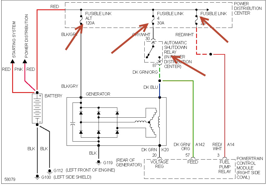

check the fusible links in power dist center along with links 2 &3 check your automatic shutdown relay pic enclosed.
