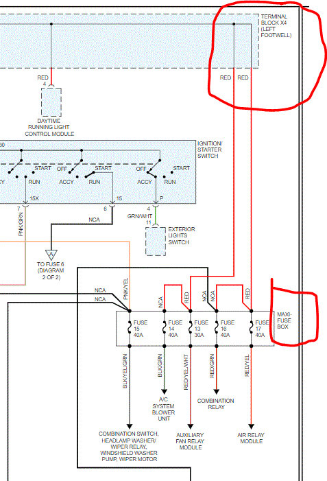

after charging a dead battery (less than a year old) and reinstalling it in the vehicle, the engine wont start the anti theft system is engaged (i used to be able to use the key in the door to lock and unlock the car resetting the anti theft system this no longer works either). The key fob nor the key will unlock all 4 doors and trunk. The horn also does not work. Tested all fuses with a multi-meter all fuses seem to be in working order, battery has juice, i am able to turn the cabin light on and off, the turn signals and emergency blinkers also do not work.
any suggestions as i am completely lost?

If the only thing working is the dome light, it sounds like a fuse issue or connection issue. The immobilizer won't shut down everything.
I looked through wiring schematics for power distribution and it shows the power from the battery goes directly to the left footwell and then distributed from there. See pic 1.
Are you getting power to the maxi fuses shown in the picture?

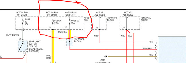

I charged the battery for 12 more hours, The battery didn't have enough voltage apparently, now everything is working fine, however the ABS and SRS lights are now on. Cars never just work do they, lol.

Now, just do some basics testing. Make sure the fluid is full and nothing appears disconnected. There should be a fuse for the ABS. If you look at the attached pic, it shows two fuses I need you to check.
Keep in mind, if you haven't driven the vehicle much, they light may go out on its own.

Light went out on its own all good thanks :D

Excellent. It had to complete a specific drive cycle for it to turn off. I'm glad it's working properly again. Let us know if you have questions in the future.
