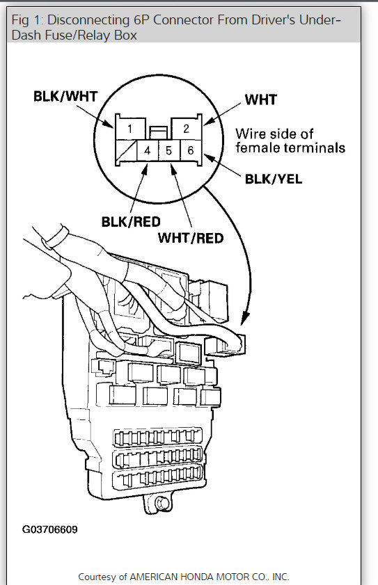

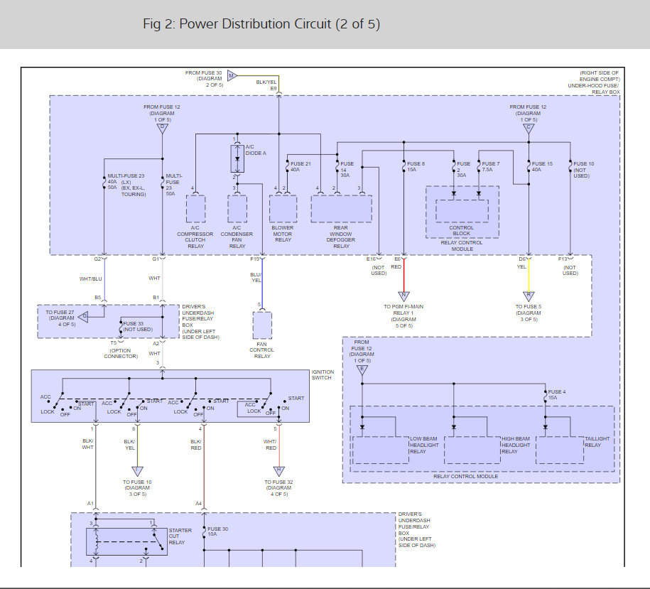

My turn signals do not work, my rear wiper do not work, my outside temperature is blank, my front wipers will not work on intermittent, and my headlight indicator does not display but headlights do work. Also AC does not work or fan.s please help
Dec 15, 2018 at 1:48 PM
  • 55,443 POSTS

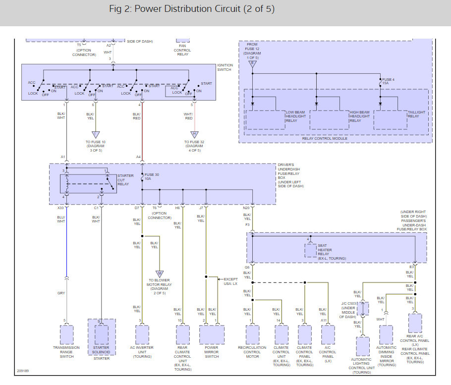

It sounds like the ignition switch has gone bad. here is a wiring diagrams so you can see how it works. Use this guide to help test for power at the black and red wire with the key on.
