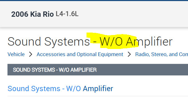

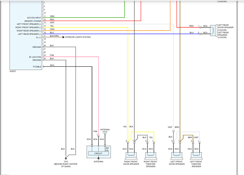

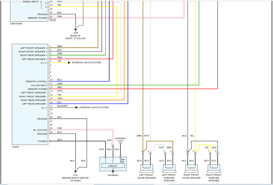

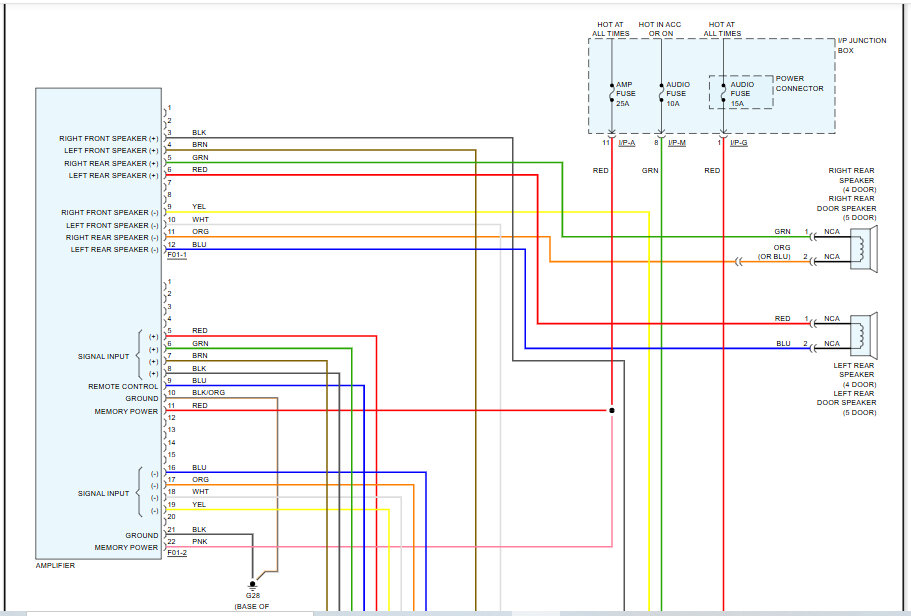

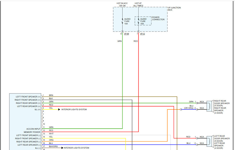

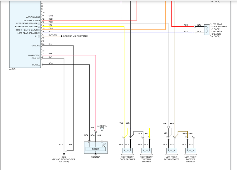

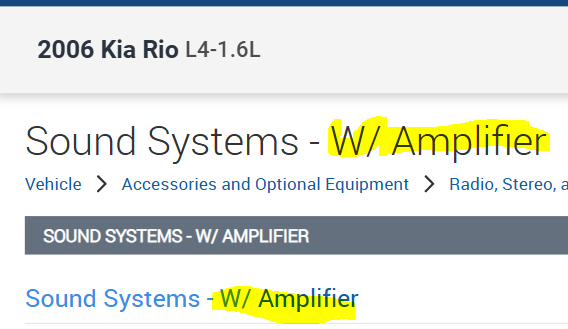

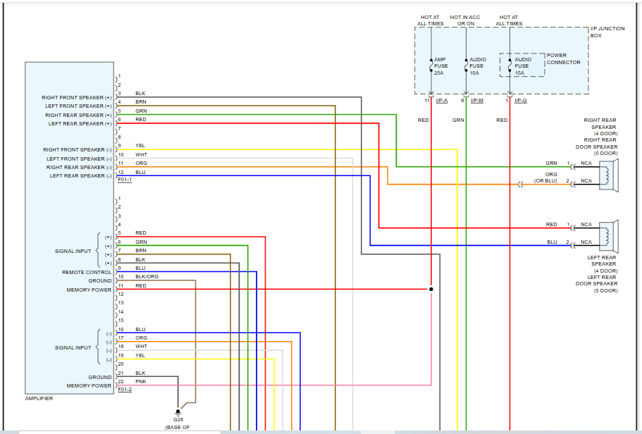

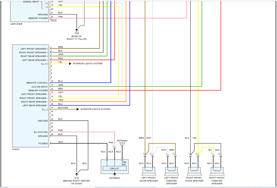

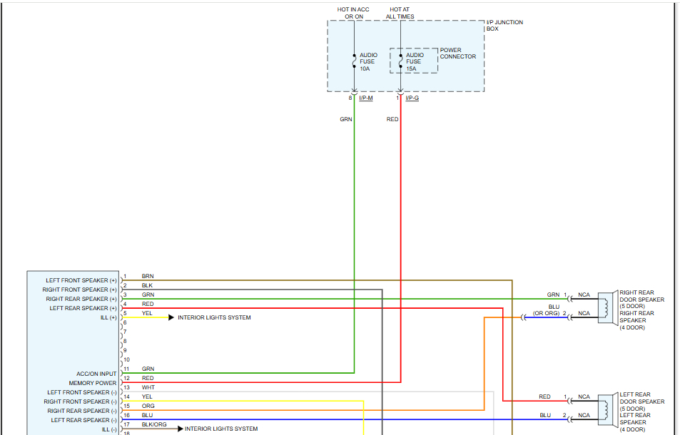

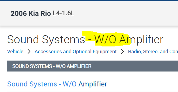

Came with no radio and someone cut out the old harness. So, I don't know where all the wires go to the radio. If someone could tell me what the color wire is that would help.
Jan 7, 2025 at 3:03 AM
  • 110,194 POSTS
In my manual, there are two options listed. One of them comes with a remote amp and the other doesn't
I attached both wiring schematics below for you. I'm just not sure which you have. Note that the schematics were only a page long each, but I had to cut each in half to make it readable for you.
Take a look through them and let me know if they help.
See pics below
