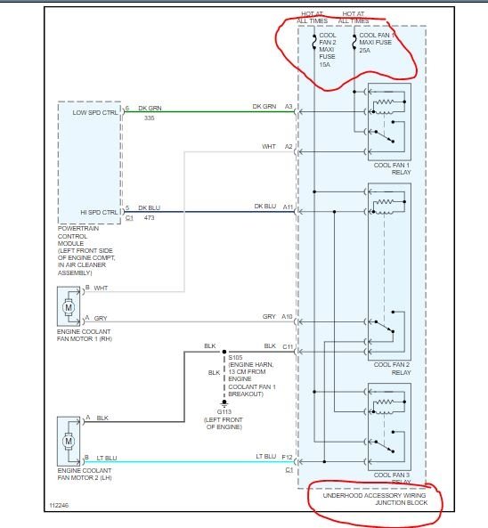

Cooling fan will not turn on, where is the fuse box located?
1999 BUICK REGAL
157,332 MILES • 3.8L • V6 • 2WD • AUTOMATIC
CBUTTERFIELD91
Okay, so I had a short in my wiring not really sure where it is, but long story short; to severed wires had touched and it sparked this blowing a lot of important fuses. I just about got everything working I taped the wire so that they would not touch anymore but my cooling fan will not come on all. I need to know is which fuse box do I resort to? If it’s box under the hood or the one in the passenger door side dash? Do I need to reset all the fuses and if so how do I do it? Any tips also that will help will be greatly appreciated.
Mar 26, 2021 at 3:48 PM

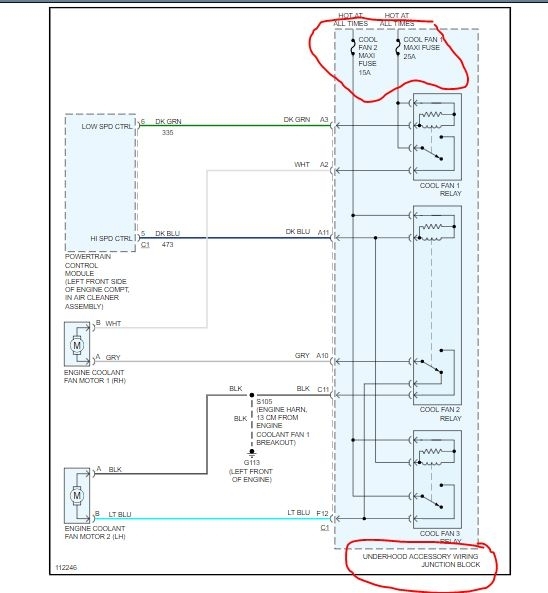

Good morning,
I attached the wiring diagram for you to view. I circled the location of the fuse block and the fuses you need to est.
There is no reset for fuses at all.
Let me know if you have any other questions.
Mar 26, 2021 at 10:28 PM
