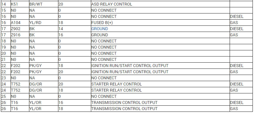

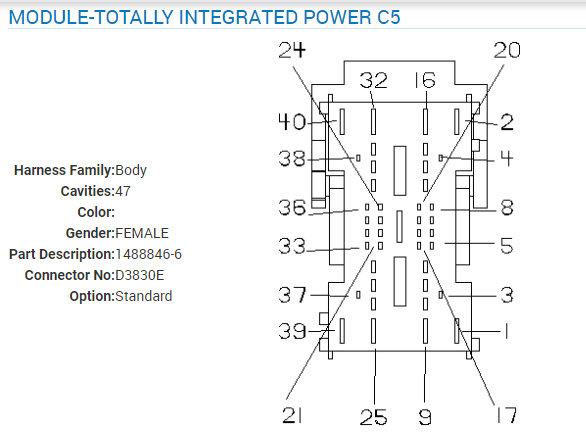

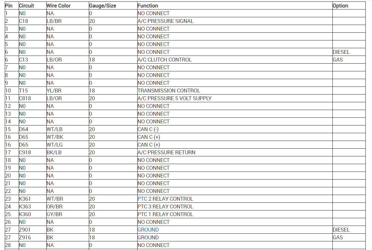

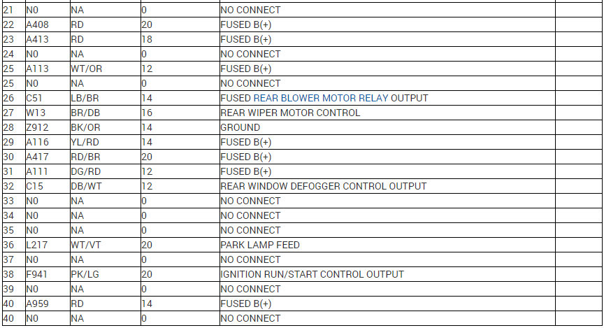

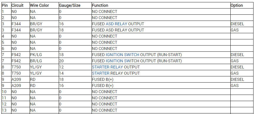

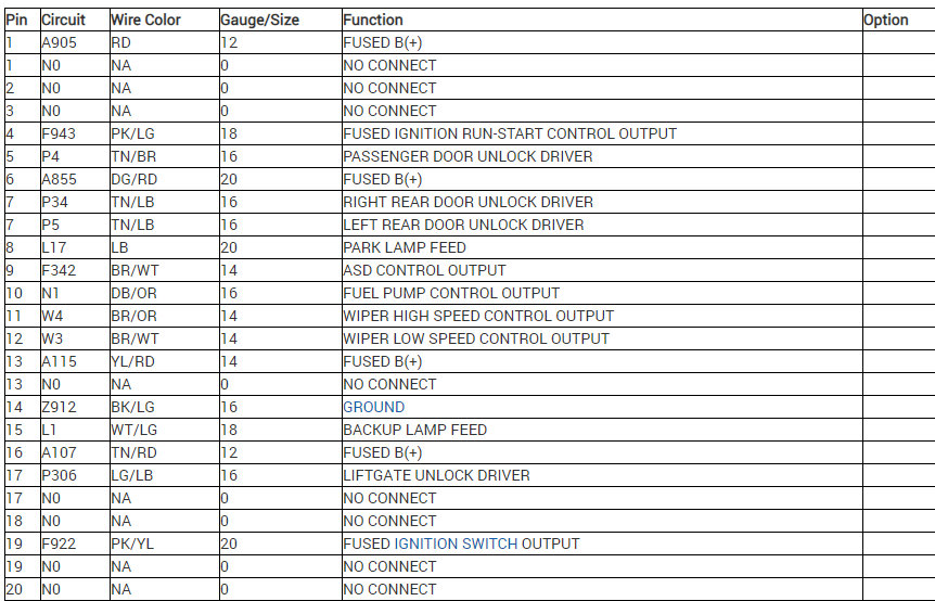

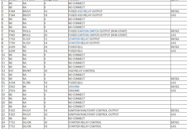

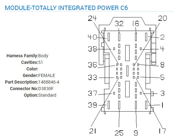

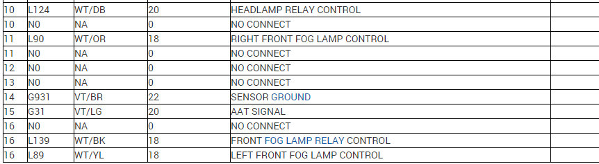

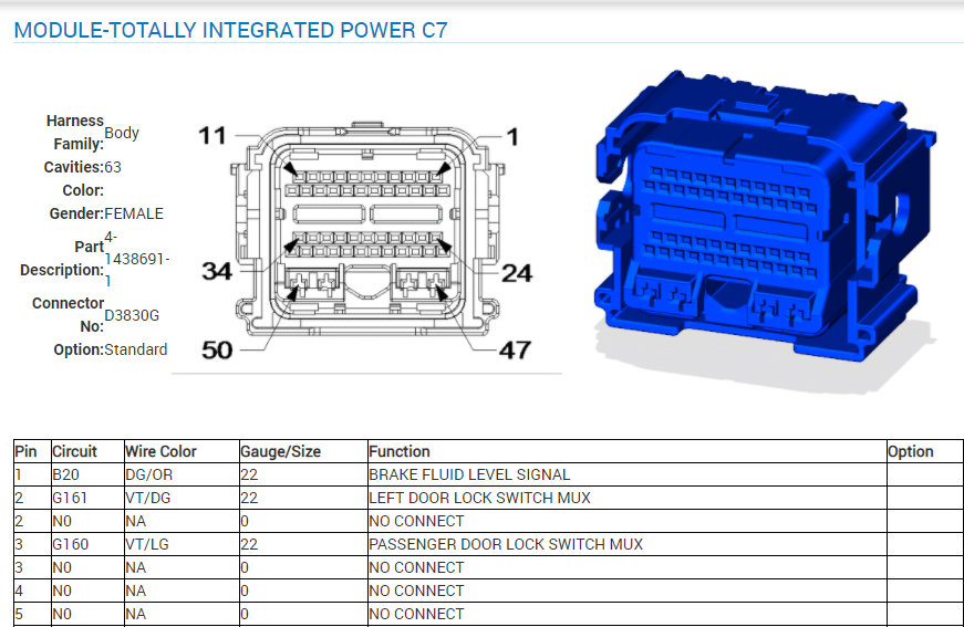

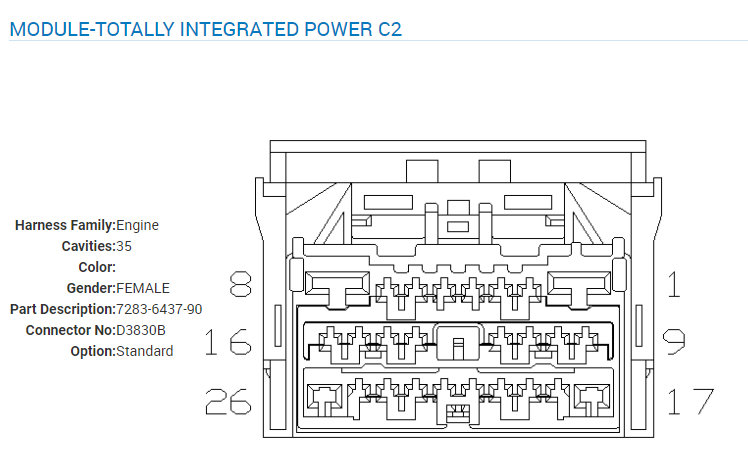

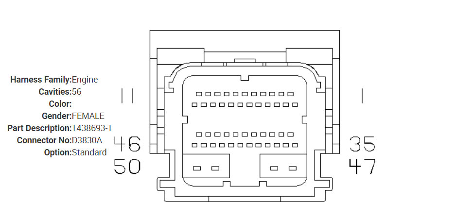

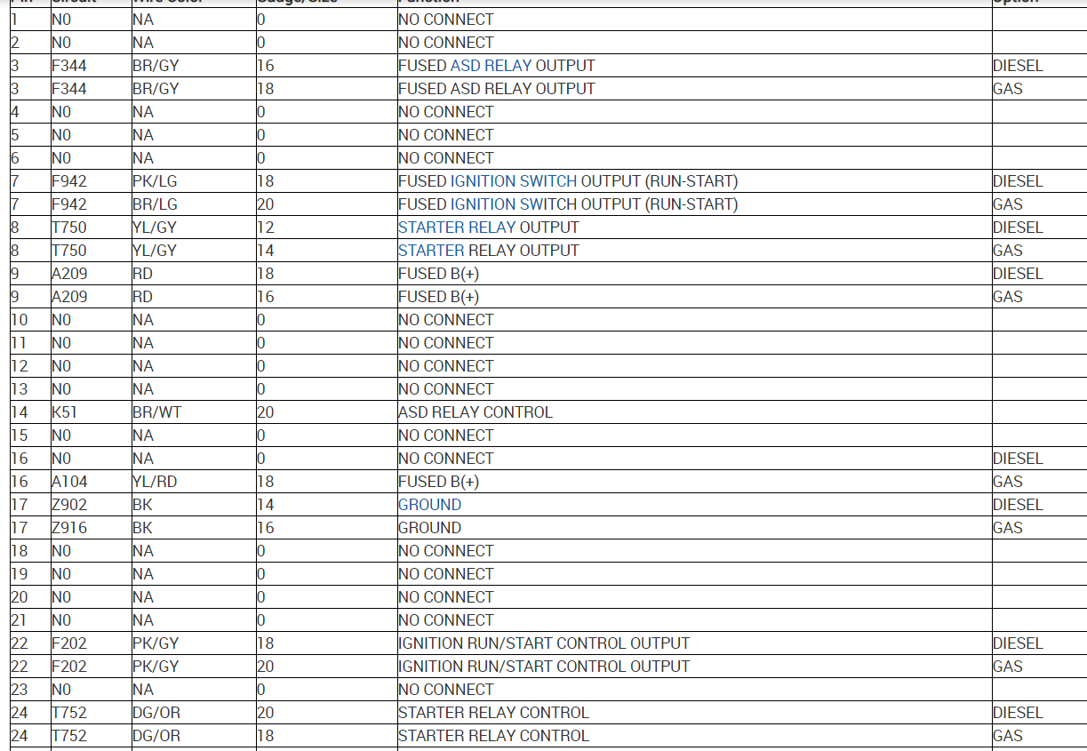

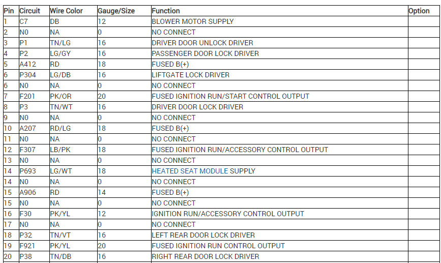

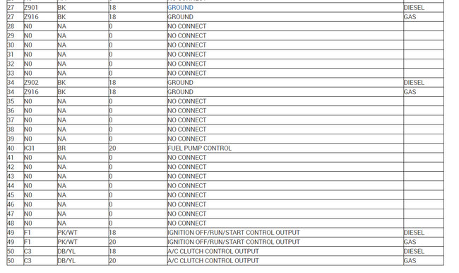

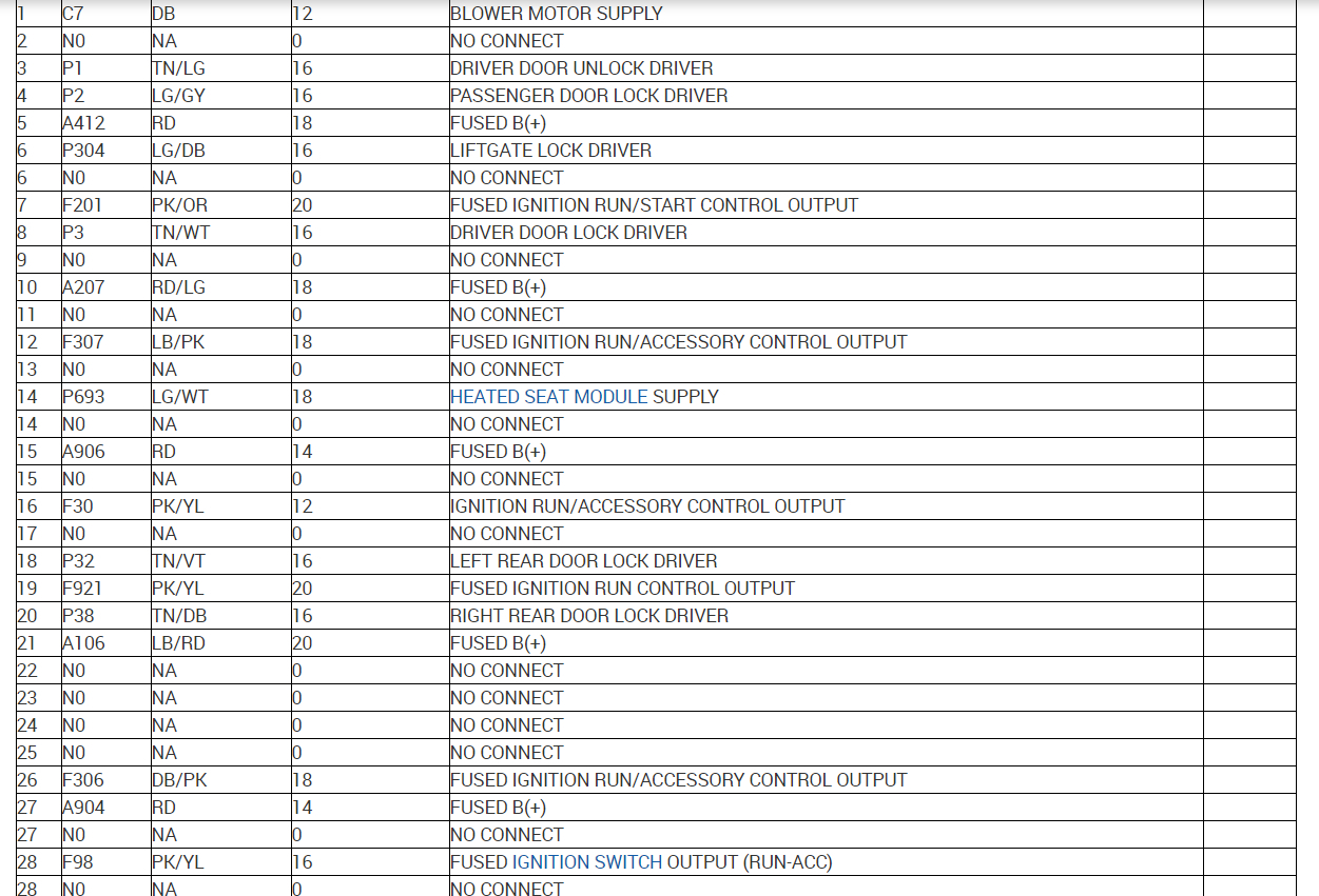

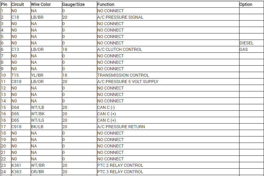

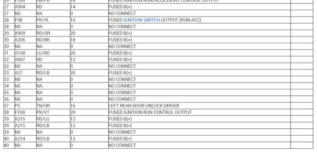

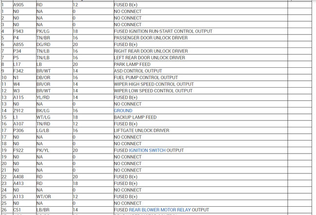

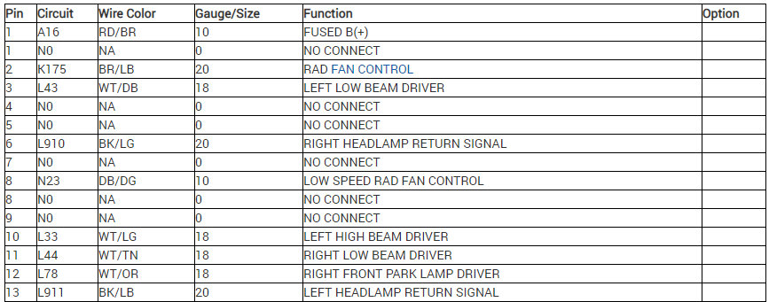

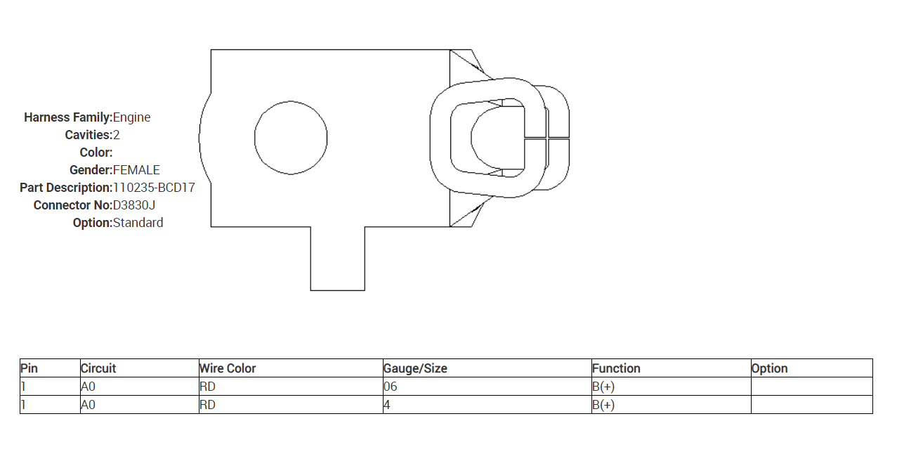

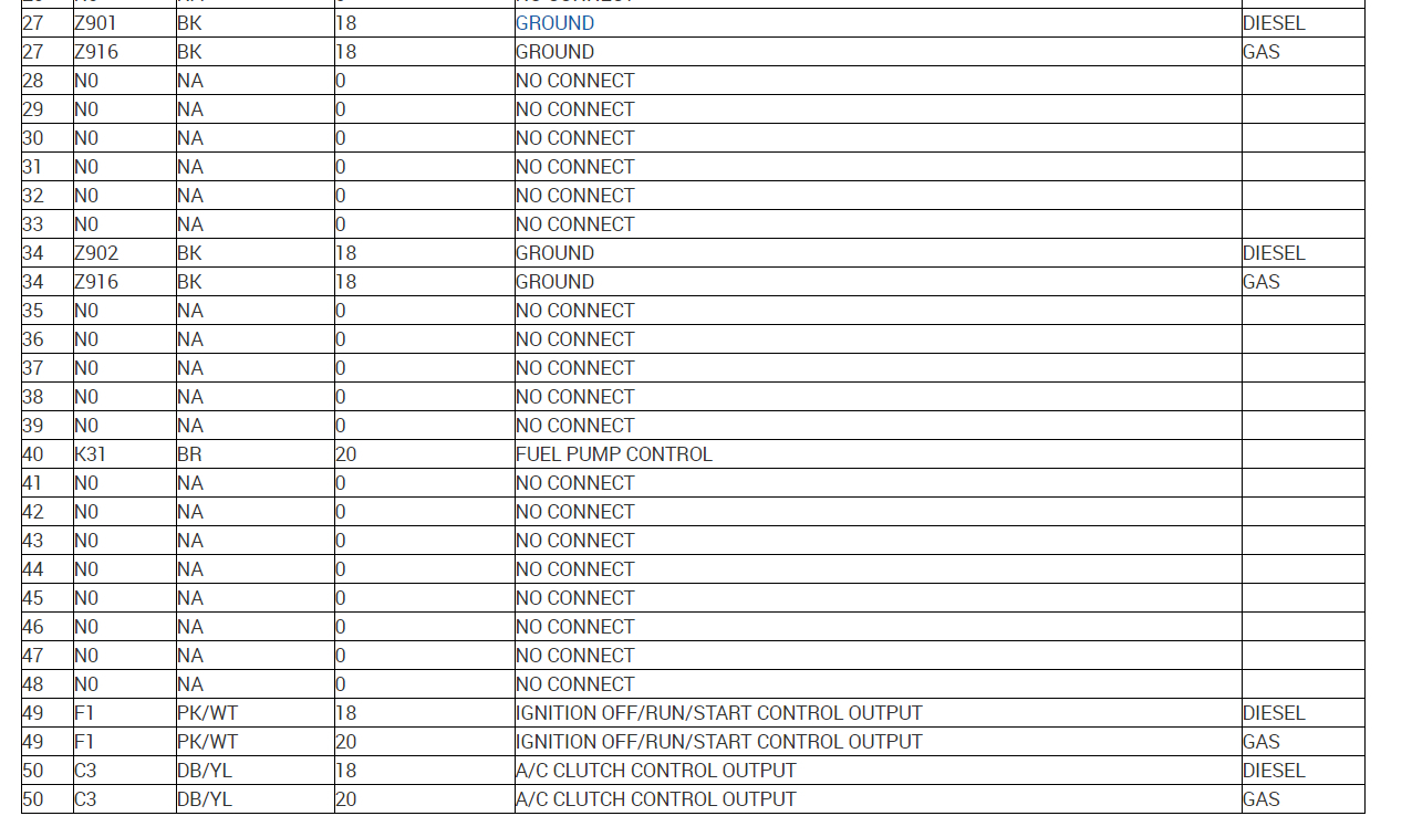

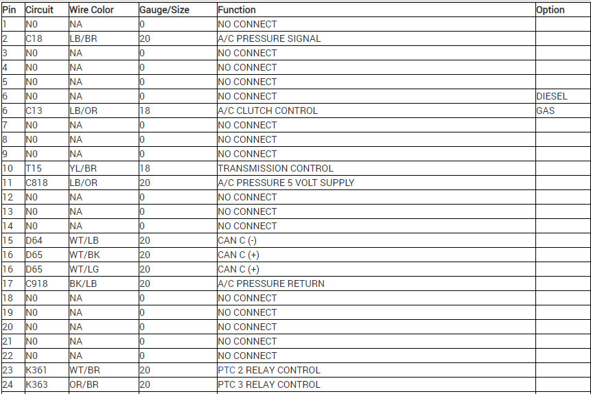

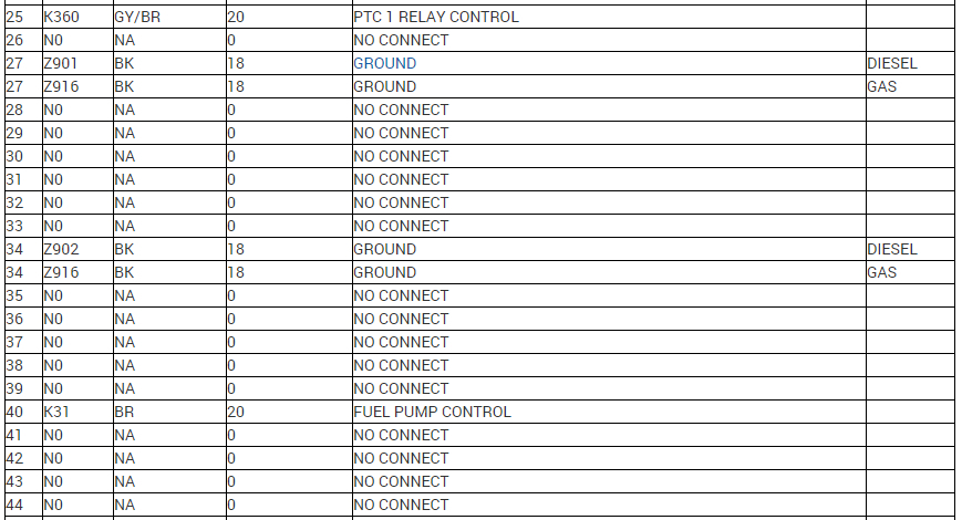

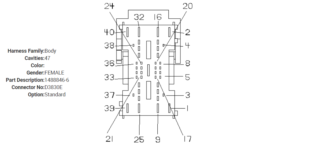

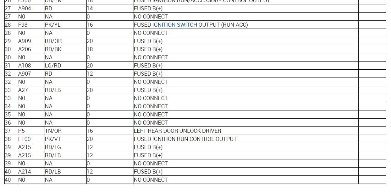

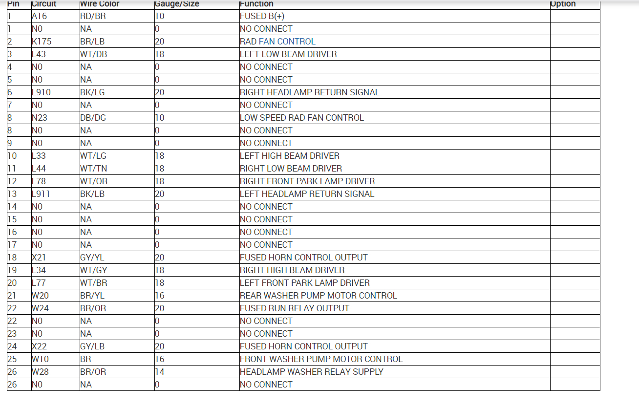

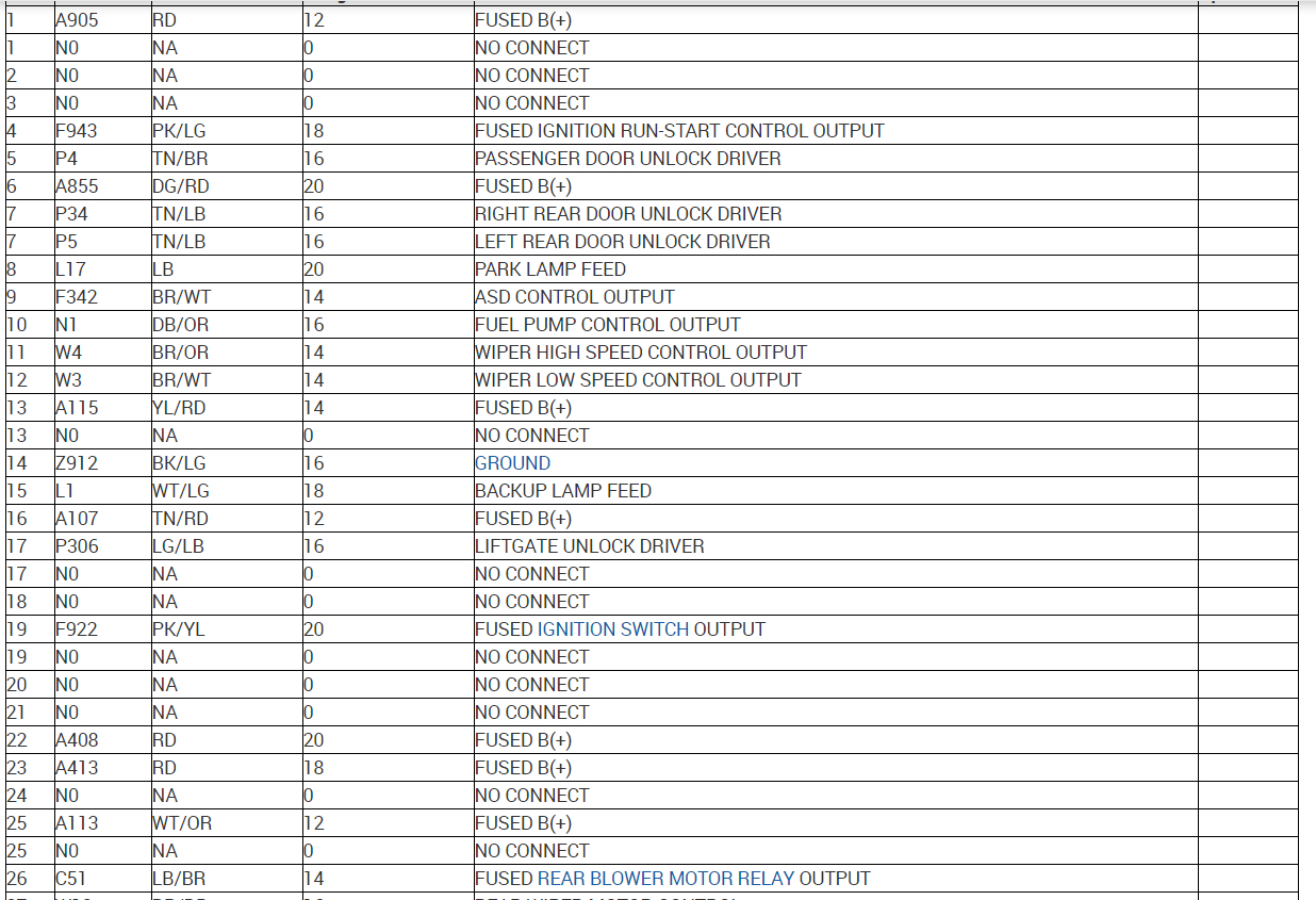

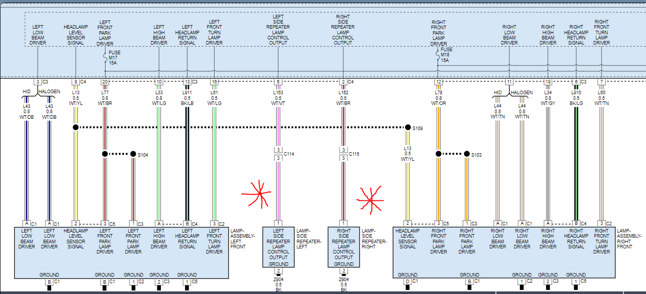

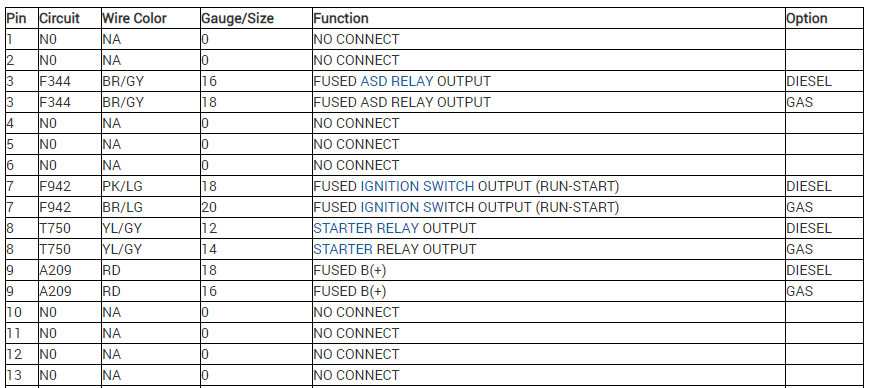

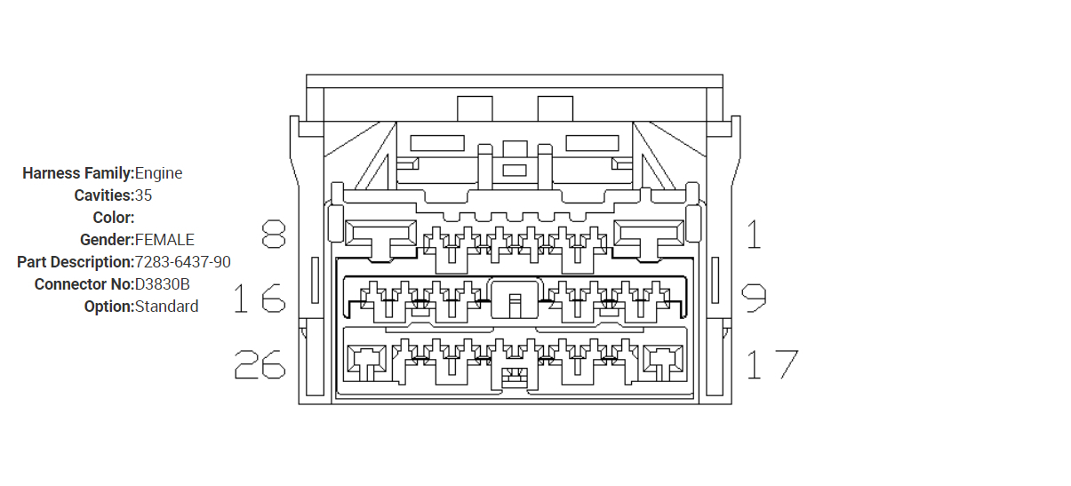

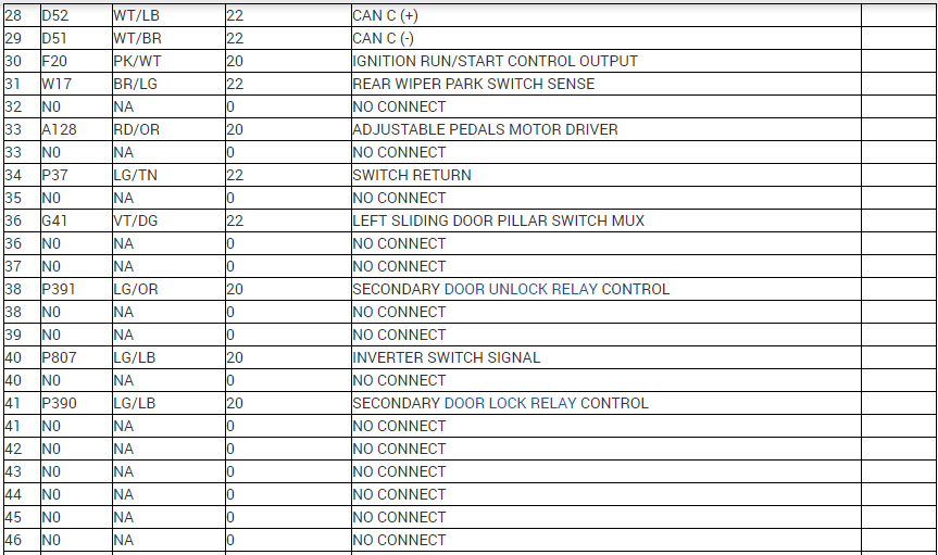

I would like to get to know the wiring diagram and pinout for all connectors in TIPM.

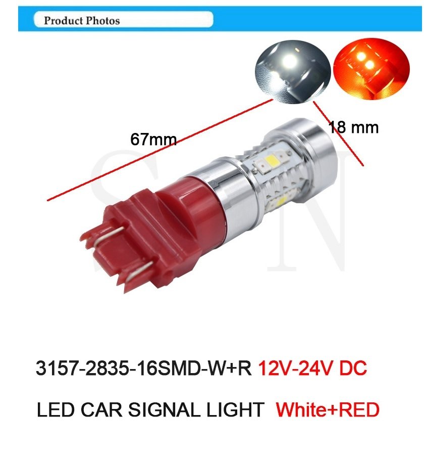

I do not use front fog lamps in my car, but I have to activate rear fog lamp. It is necessary in EU countries. I would like to use front fog relay as relay for my new front DRL and original front fog switch as rear fog switch. I observe that there is one useless wire light green/white which goes to left rear lamp. I am going to connect this wire to front fog switch (via relay of course) and put two-fiber white-red LED bulb as rear reverse gear and red fog light. Therefore I would like to know where are placed all wires bottom of TIPM.
It will be useful for all modification.

Hello, I'm Danny.

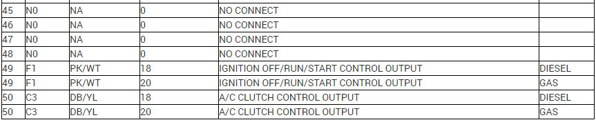

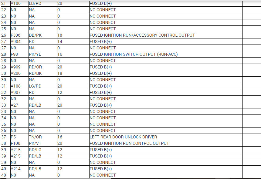

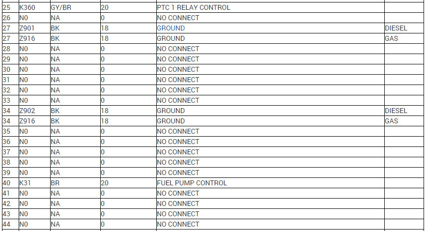

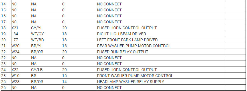

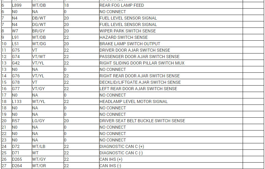

Here is the TIPM wiring diagram information you requested. This is a tutorial for you to view on how to test electrical wiring:
I've attached the TIPM wiring pin-outs below for your van. Hope this helps and thanks for using 2CarPros.
Feb 6, 2021 at 7:21 PM

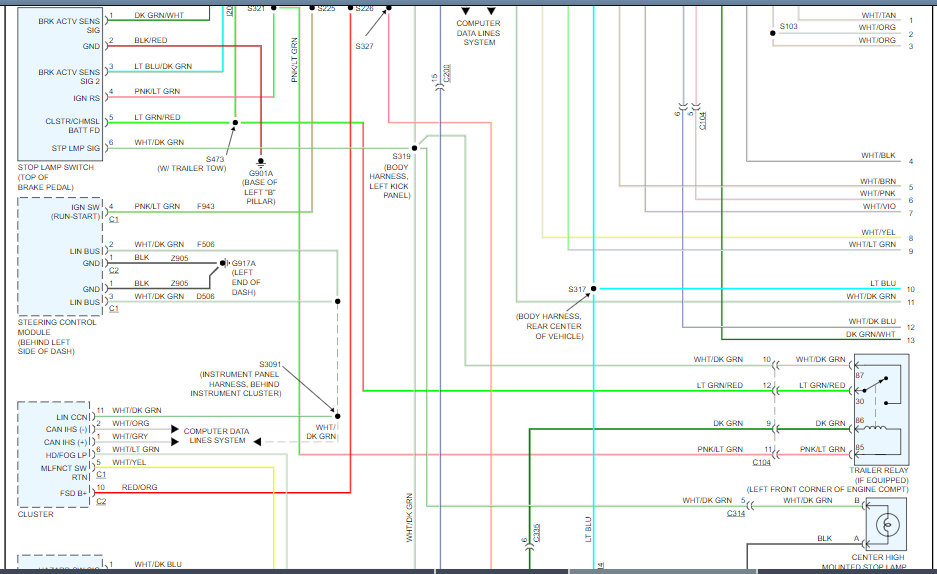

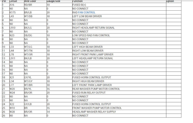

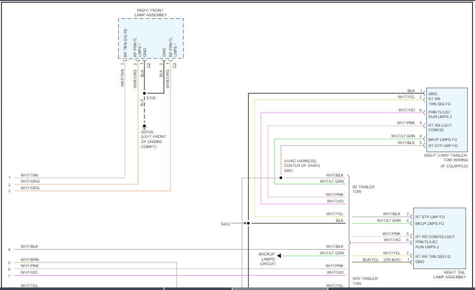

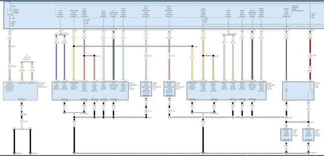

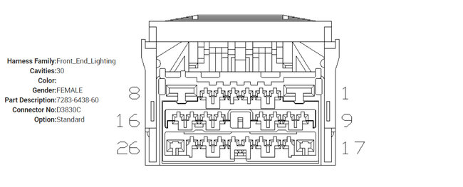

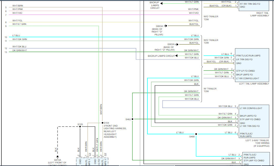

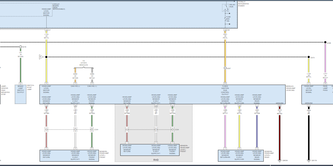

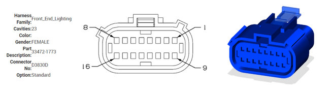

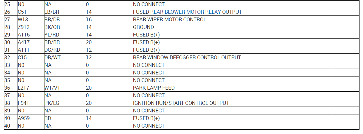

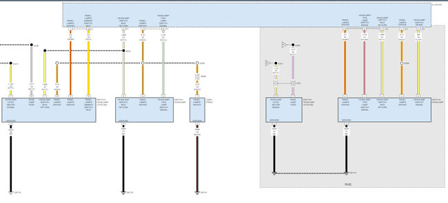

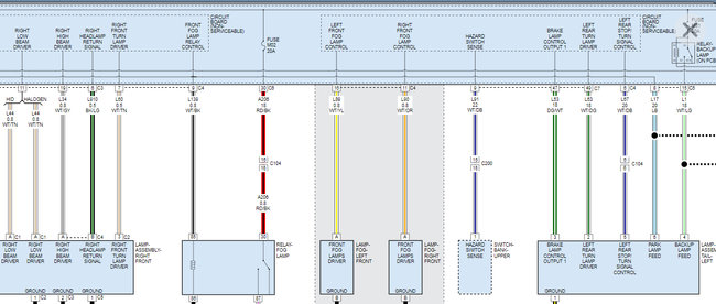

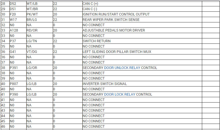

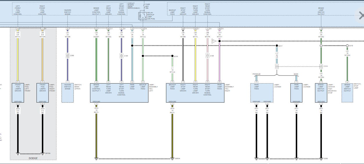

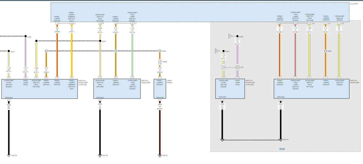

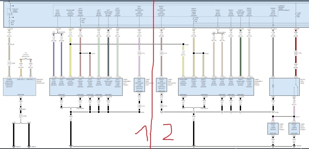

Thank you for your wiring diagram. It is very helpful. But I need disconnect DRL while head lamp is running via an additional relay. Could you please add front lamp diagram/wiring too?
Feb 8, 2021 at 7:39 AM

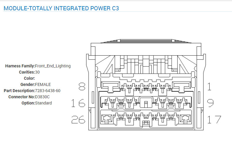

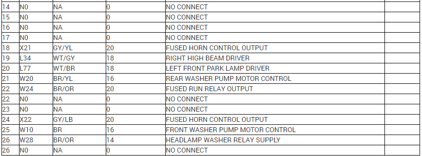

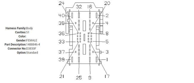

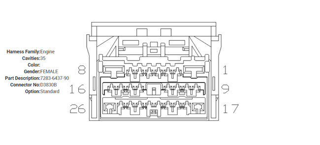

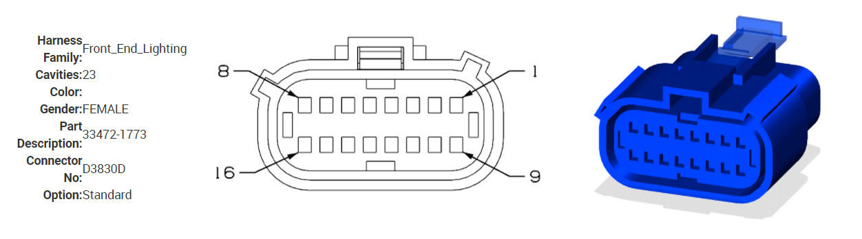

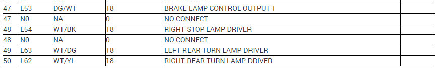

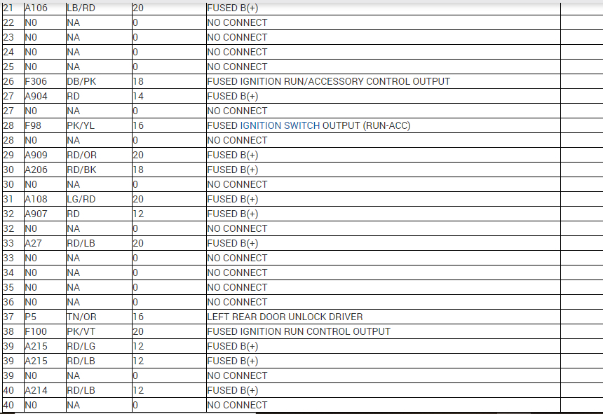

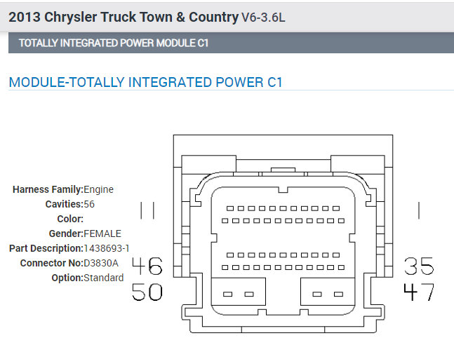

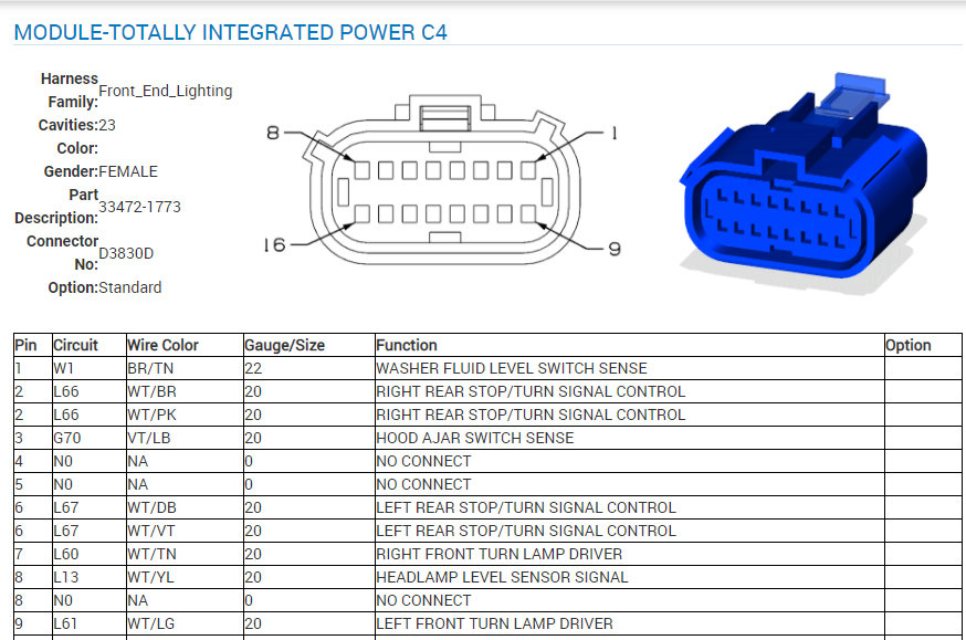

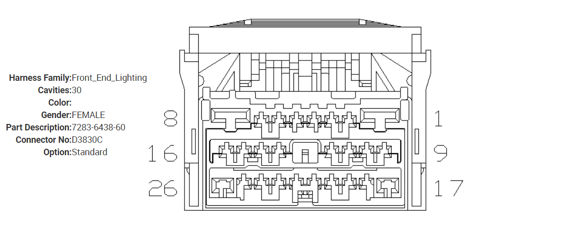

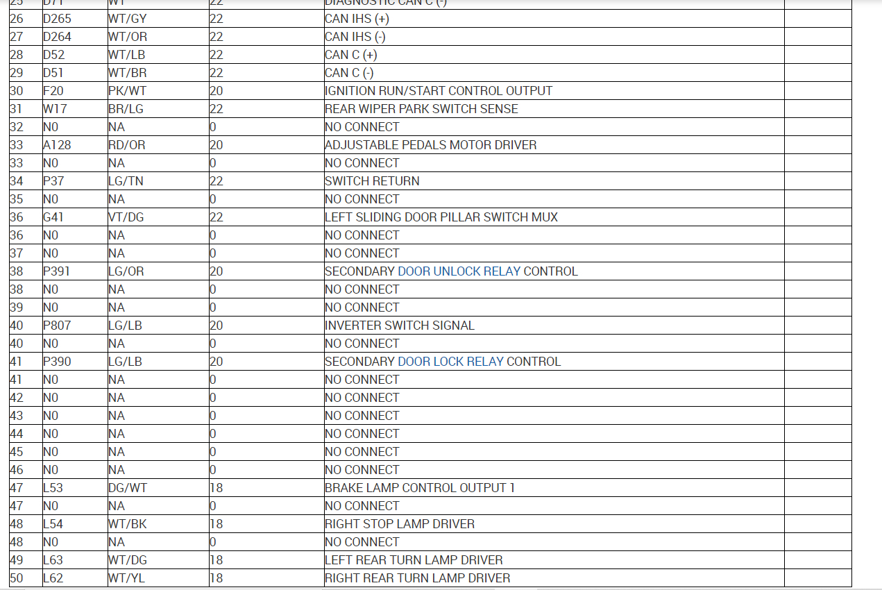

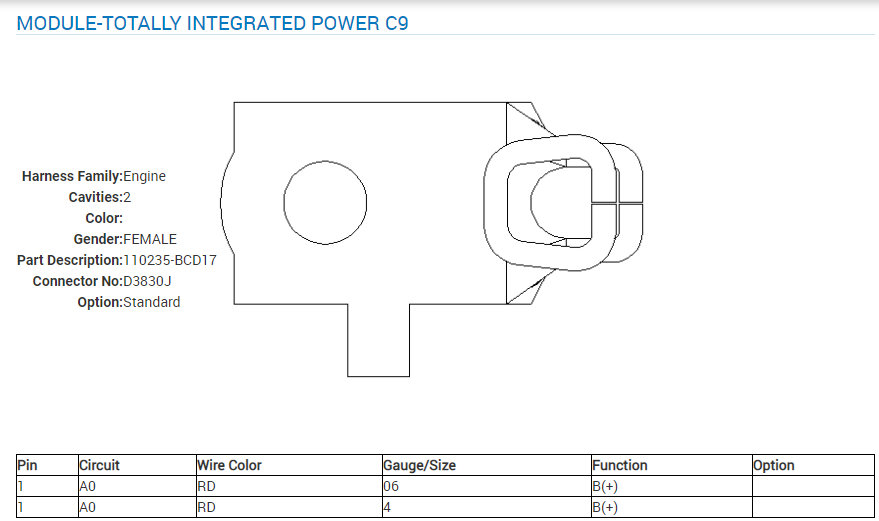

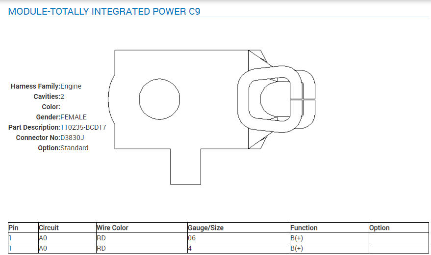

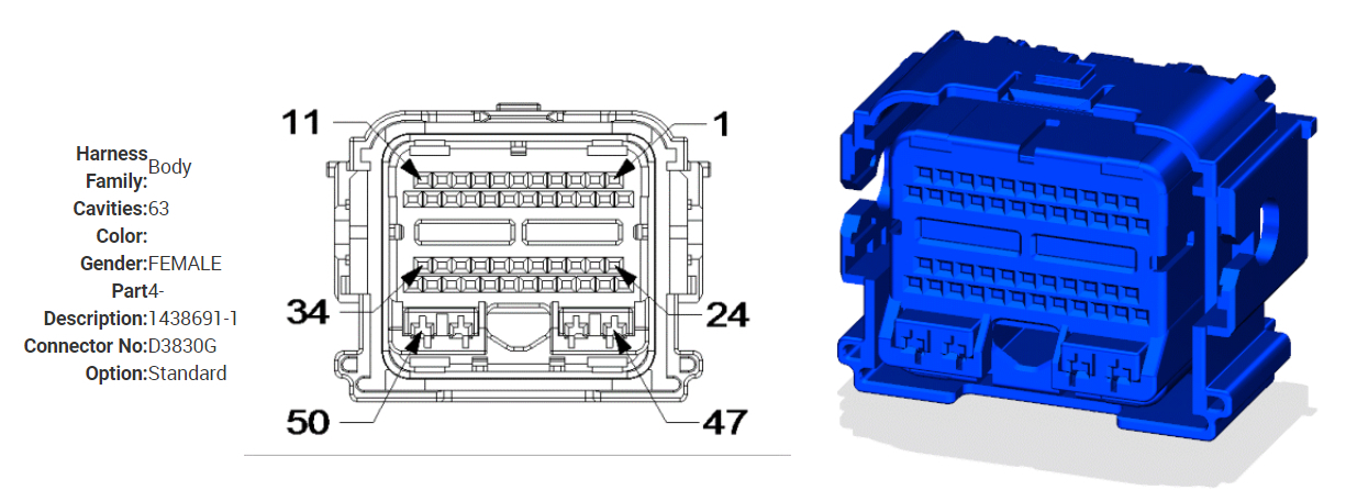

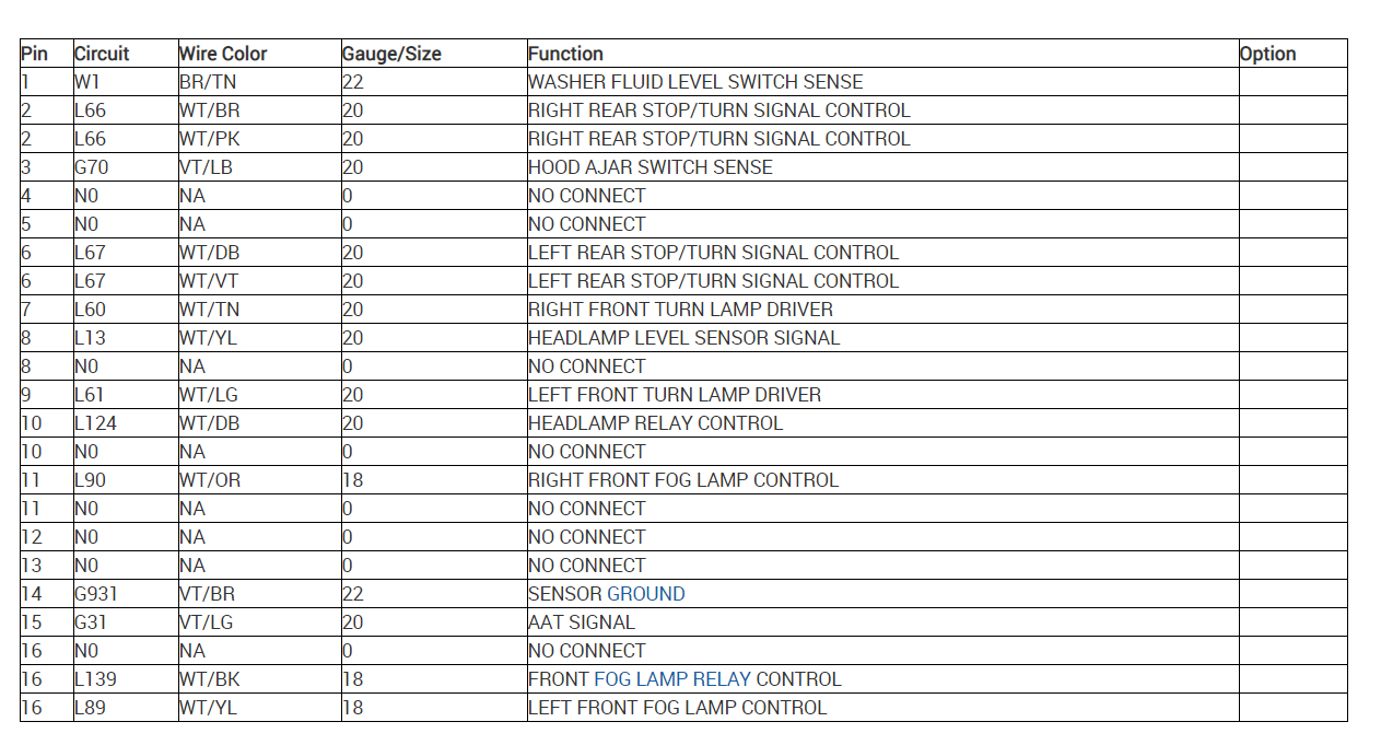

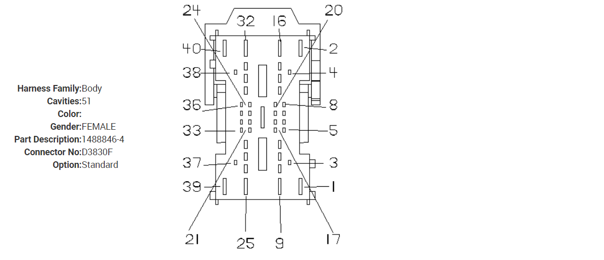

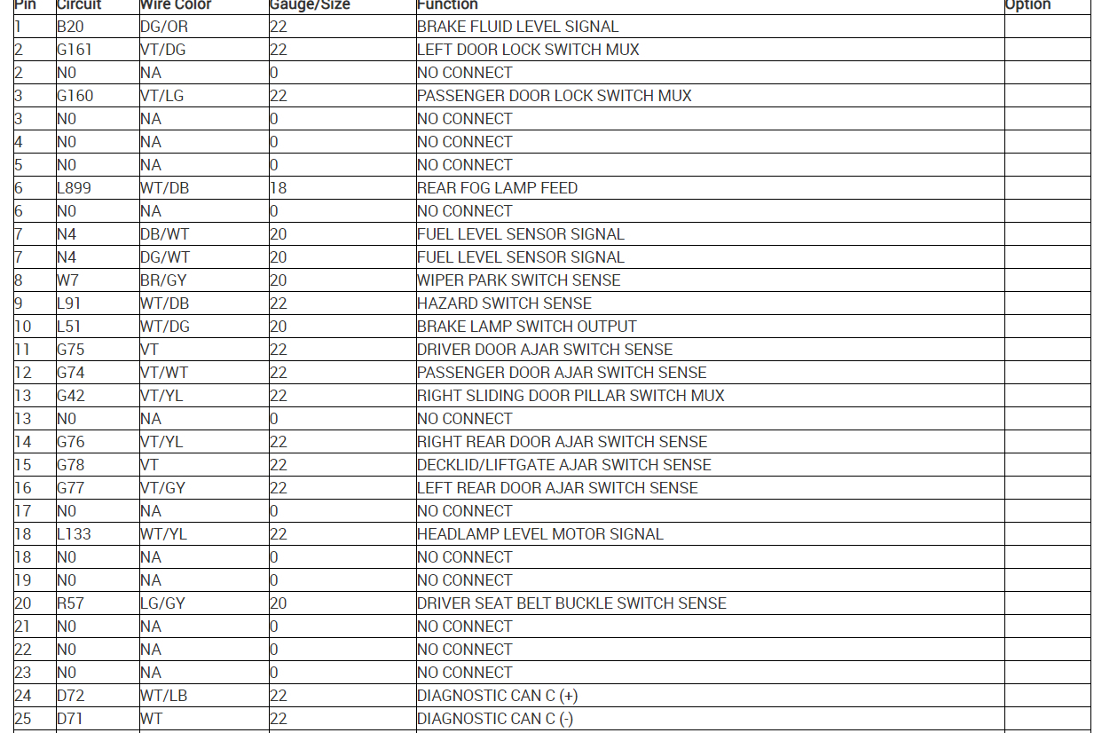

I attached the connector views of the module for you as well. It identifies the function of each wire.
Feb 11, 2021 at 12:31 PM

Unfortunately not... It is the same as before. I mean wiring between front left and right lamp and TIPM connectors.

Hello again.

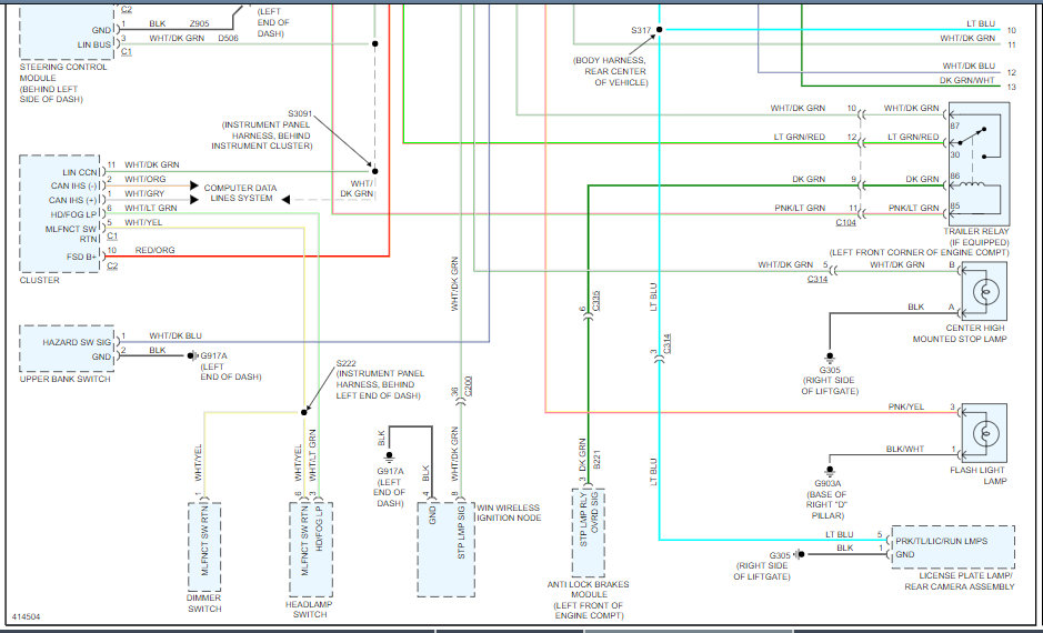

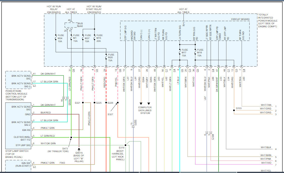

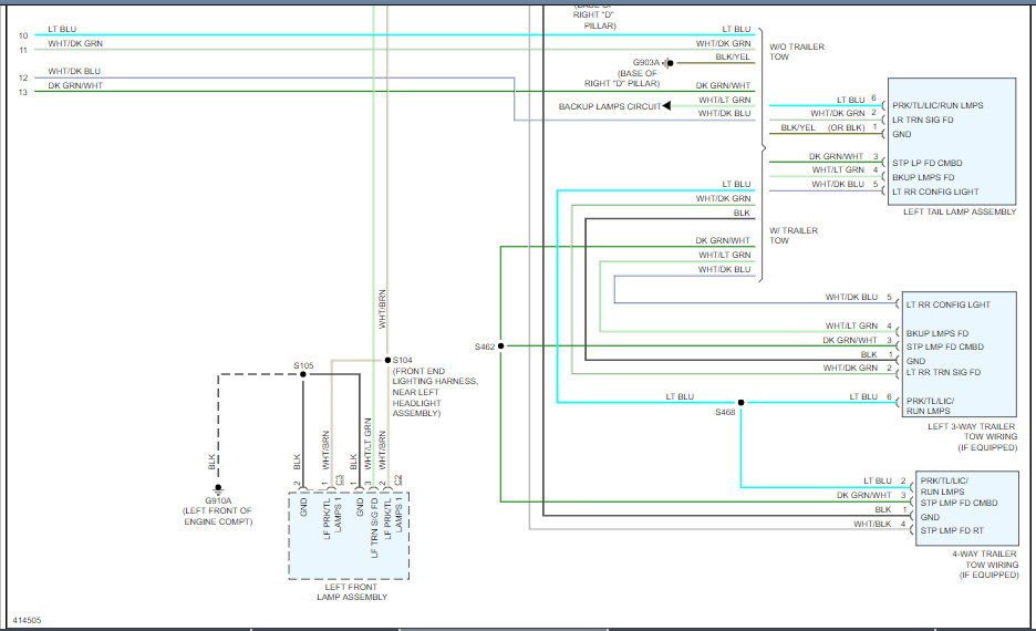

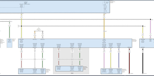

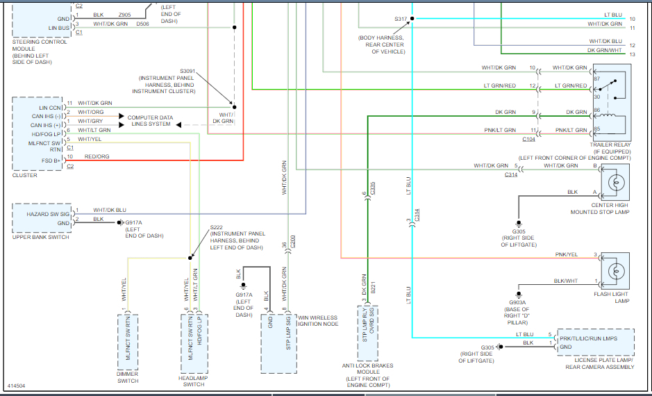

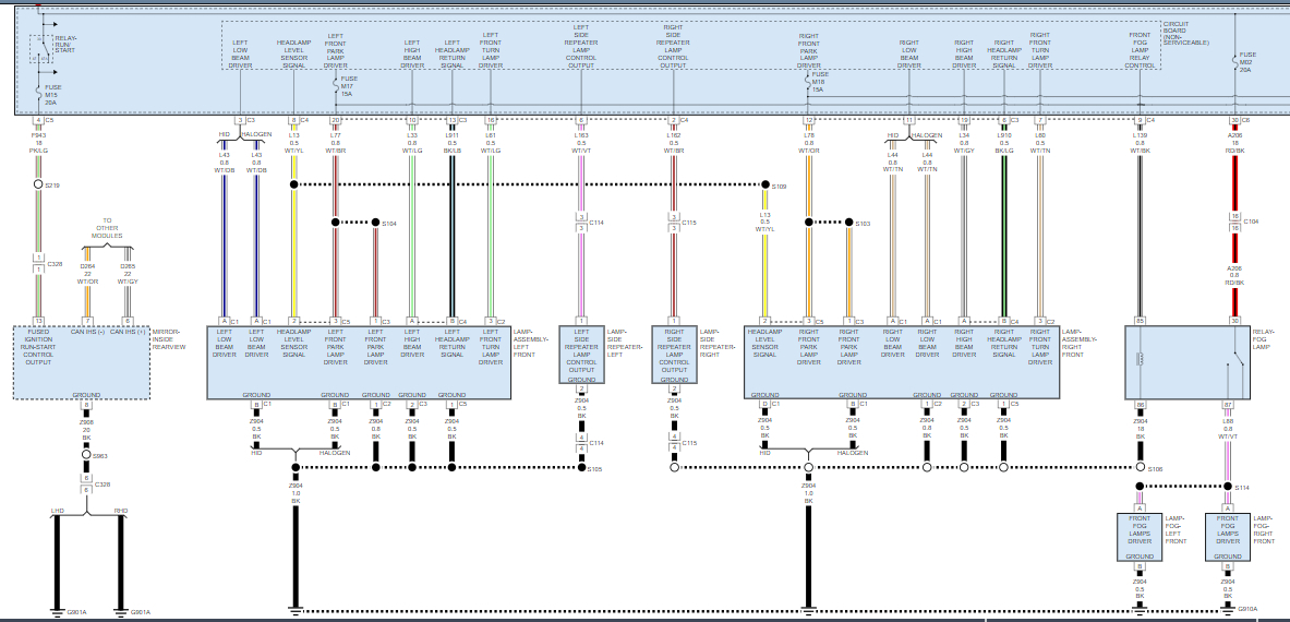

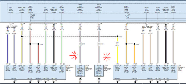

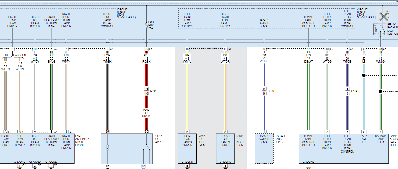

I've attached additional wiring diagrams below for the exterior lighting for your van. I've attached the US version first and export diagram second. The US diagram shows no offering of DRL- daytime running lights. The second set of diagrams (export) show a circuit called repeaters. Could that be what its called? I've attached them below. Let us know what you think and get back to us. Hope this helps and thanks again for using 2CarPros.

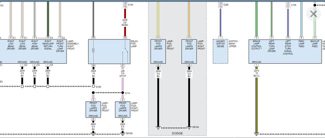

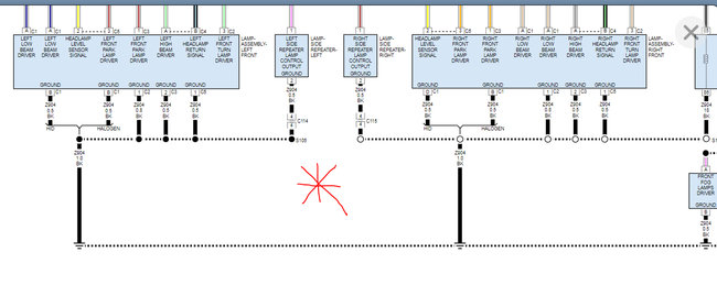

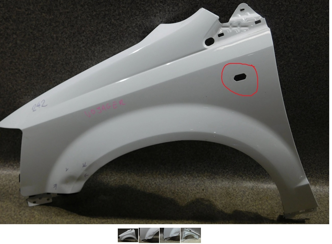

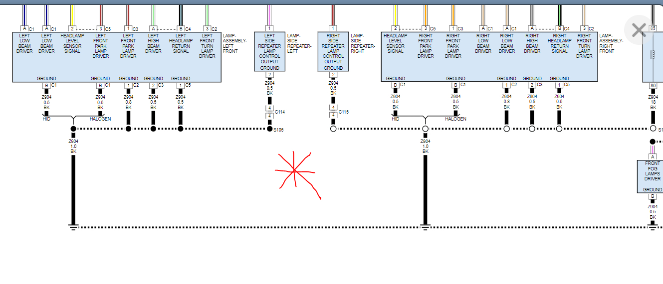

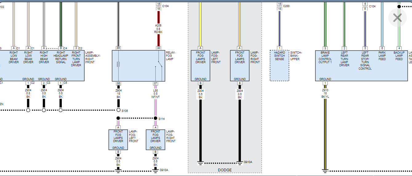

Thank you for your reply. It is helpful, but not all screens are clear. I cannot all read. Could you please send this screen as two screens? I need to read connector no and pin no with color. I would like to focus now to the wiring between left and right front lamp and TIPM. I bought my car in USA. It is for USA market and I need to do modification for EU country. It is front DRL and rear fog lamps.
About repeaters - I think it could be left or right turn signal lamp (I marked red circle). In EU countries there are side turn lights (it is Lancia Voyager name), in the USA it is not available (T&C or Caravan).

Hello again.
Here is a wire testing tutorial for you to view:
I've attached the pictures of the exterior wiring diagram below again but I've blown them up even larger for you. I've made a red mark near the repeaters. Hope this helps and thanks again for using 2CarPros.
