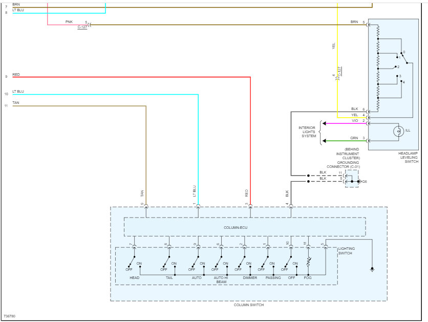

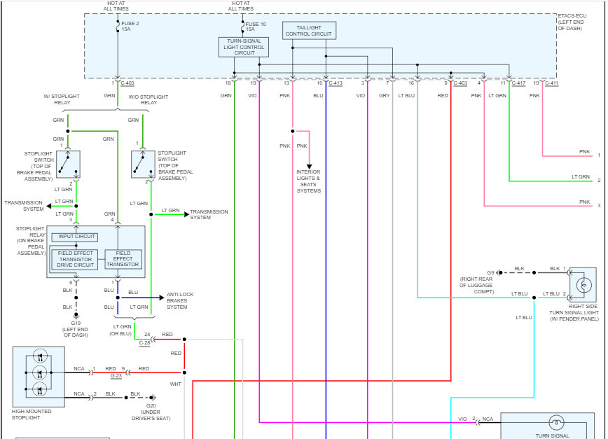

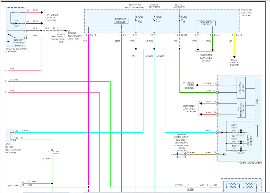

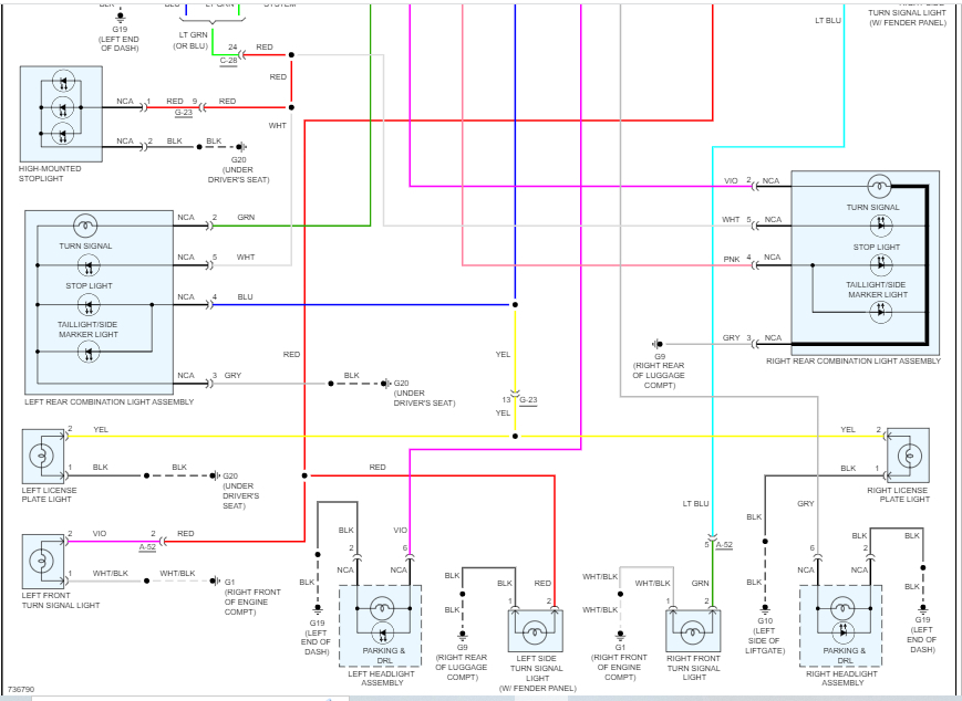

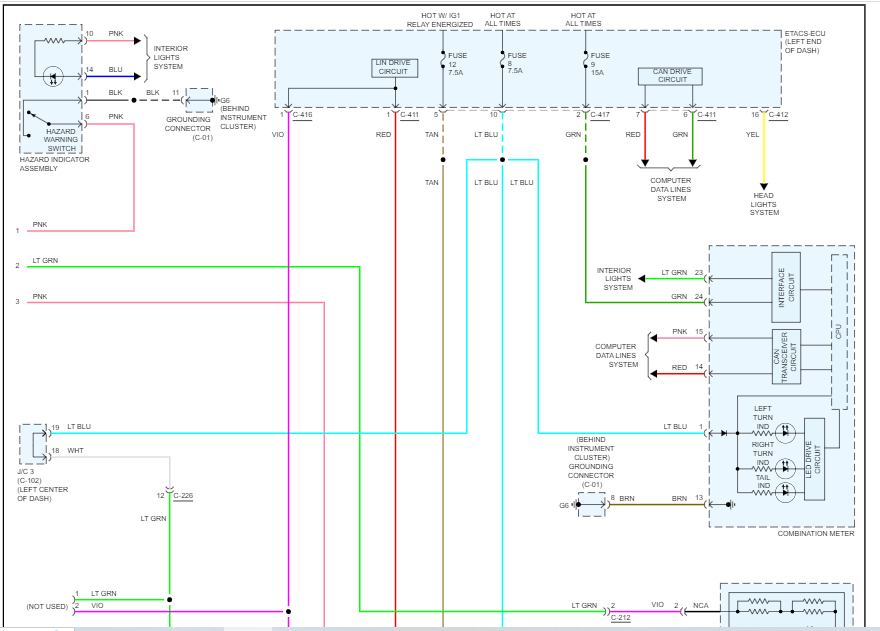

Hello, I bought for my wife the vehicle listed above from USA market. I live in EU country, and I have to do some modifications. I would like to know the wiring diagram for front and back lamps. I have to add rear fog lamps for EU regulations. I would like to know where the wires from front lamps go to. I found the fuses box under dash. Is there for front main light driver? I would like to add the relay for rear fog light, supply from some +12V wire with an additional fuse and the additional switch for switching.
Thank you for your reply.
Have a nice day,
Pawel
Jan 28, 2023 at 1:01 PM
  • 110,194 POSTS

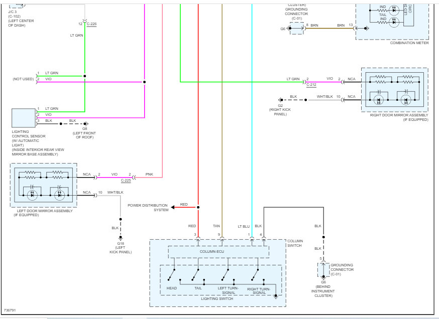

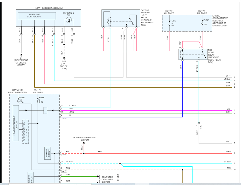

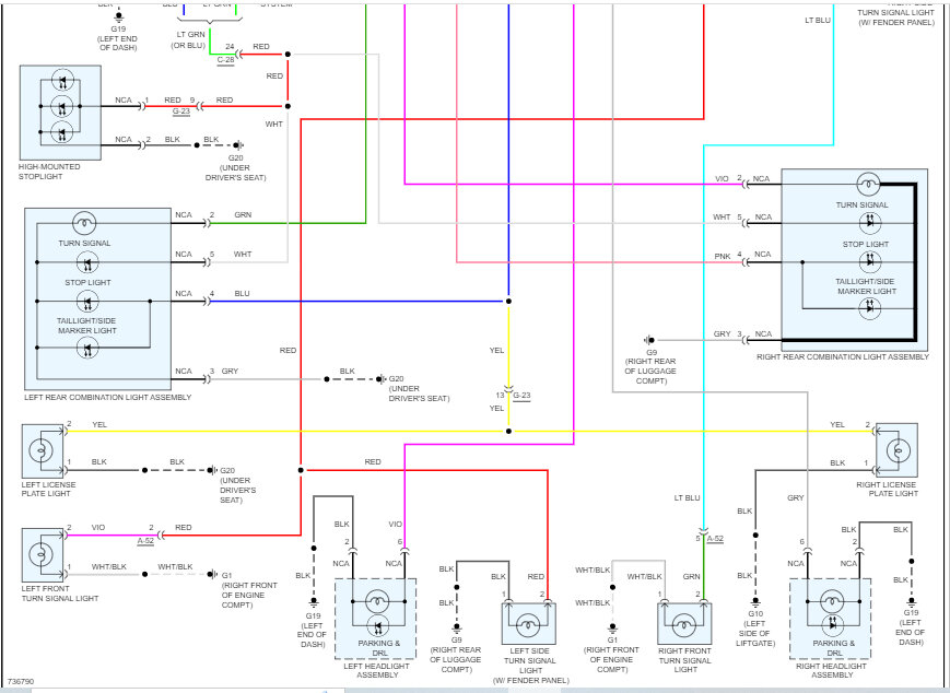

If you look below, I attached the entire exterior lighting wiring schematic for you. Take a look through them and let me know if you have any questions or need additional information.
Take care and let me know if this helps.

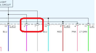

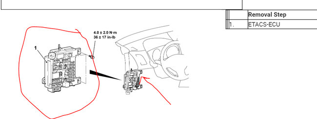

I am looking for one wire - 3 or 7, probably from C-403 or 413 connectors? Is it wire for supply left or right headlight? I am going to use this signal for coil control of relay for rear fog light.

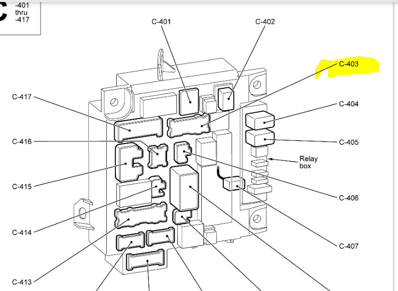

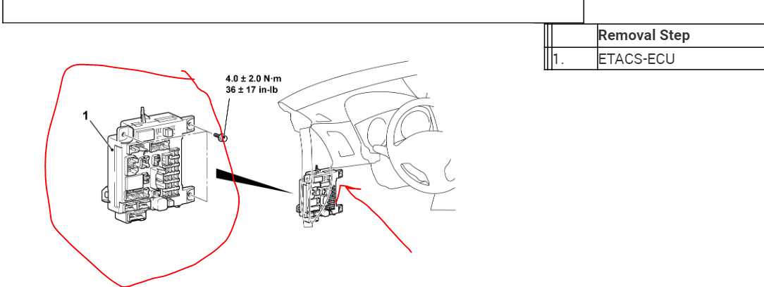

Could you please tell me where is this ETACS ECU unit located under dash and this connector C-403 on this unit?

  • 110,194 POSTS
C403 pins 3 and 7 are for the left and right headlamps.
I attached two pics below. One shows the ETACS-Ecu location and the other shows connector orientation.
Let me know if this helps.
Jan 30, 2023 at 4:43 PM

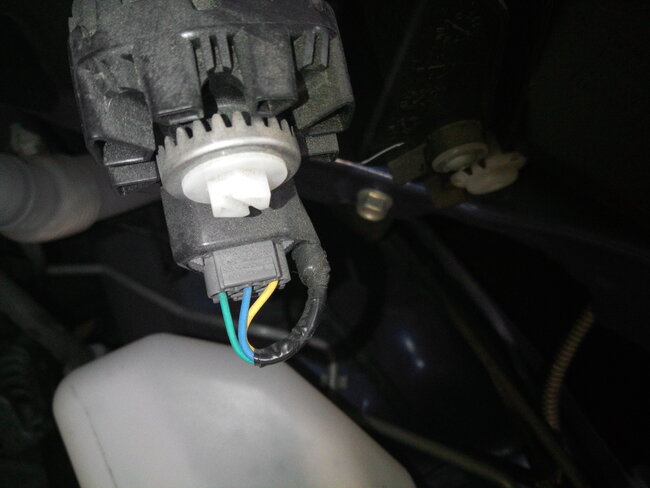

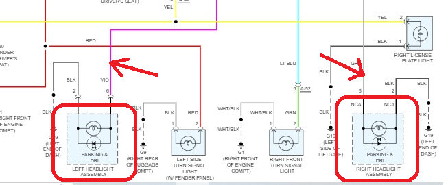

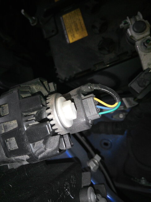

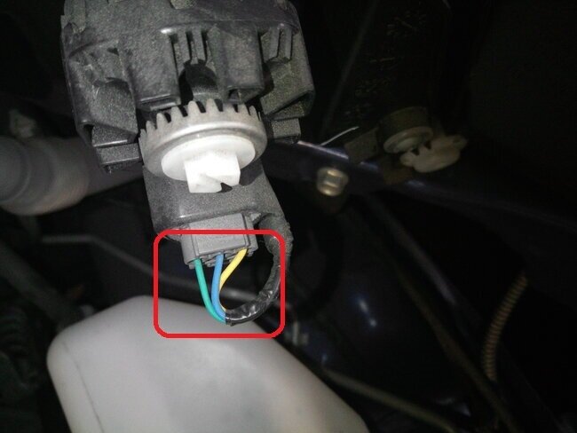

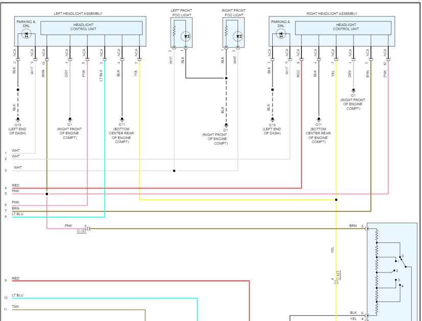

But I observe that front main light and park light it is the same wire number 3 or 7. But to the headlight go three wires - yellow, green and blue. Why only one wire goes from ETACS-
ECU to left headlight and one to right headlight? By ETACS-ECU the main and park light are together?

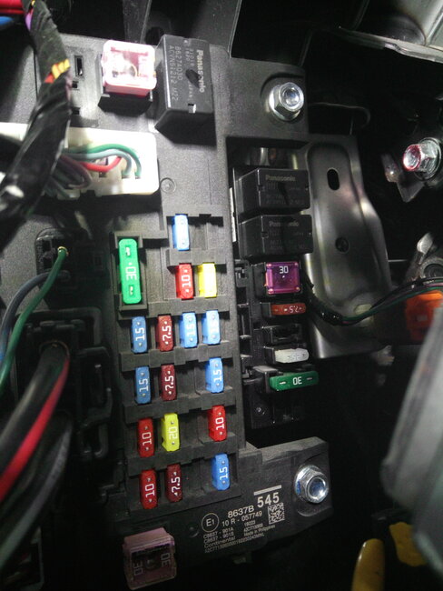

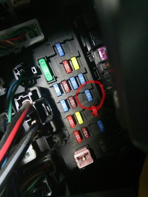

And the second thing - where could I find +12V signal, when I switch on the first position the key, when for eg. the radio start working? (Not permanent +12V, not hot all the time)? Is this signal on ETACS or another place?
Jan 31, 2023 at 10:19 AM
PAWEL_N
  • 178 POSTS
I found the fuse with +12V for the first position the start key. I marked it the red circle.
What about the separate wire for the main headlight?
Feb 1, 2023 at 11:00 AM

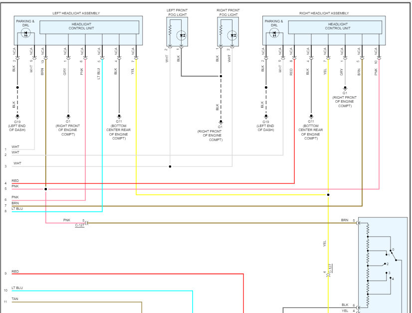

In the photo you can see that there are three wires. But on schematic there are two only: GND and DRL/parking together with main light (while night driving).
The wire number 3 or 7 on ETACS are connected to parking/DRL light. I would like to related the rear light lamp with front main light, not parking light.

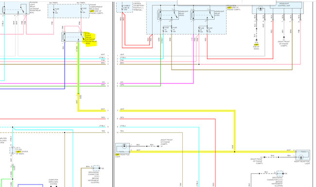

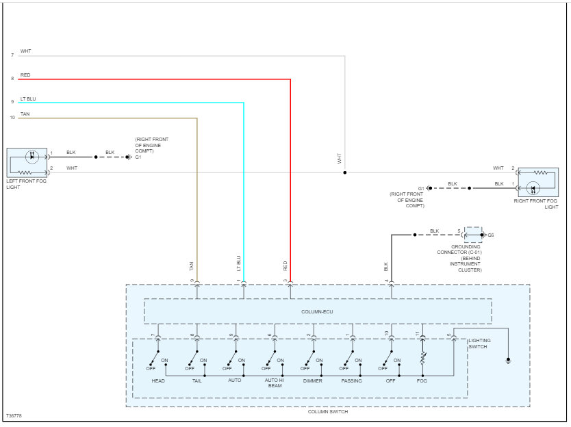

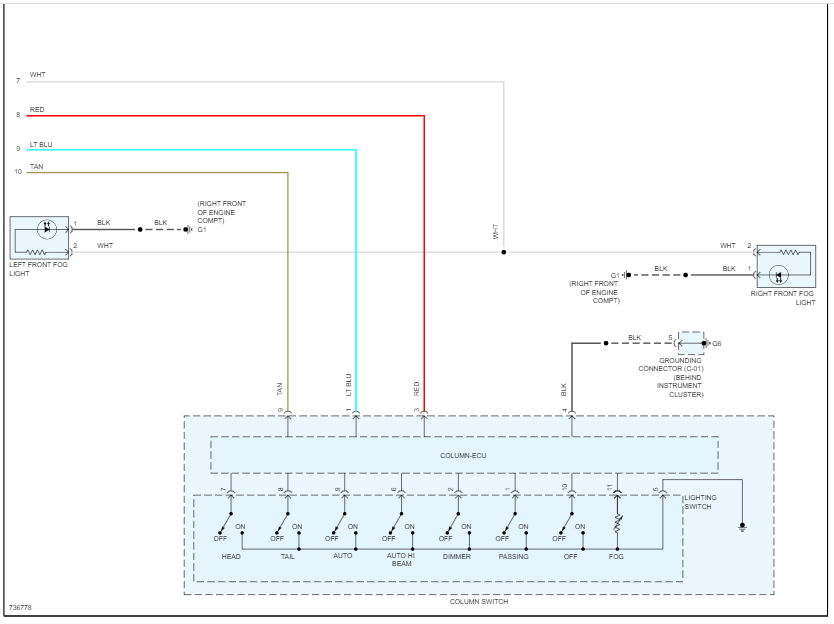

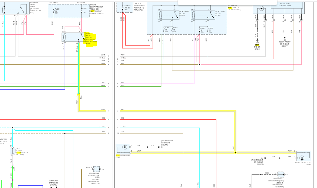

If you want power from the fog lamp circuit, there should be a white wire going to them as a supply. See pic below
I'm sorry. I'm not 100% sure if this is what you need. Also, your English is very good.
Let me know. Also, confirm if you have high-intensity headlamps or not.
See pic below.
Feb 2, 2023 at 6:20 PM

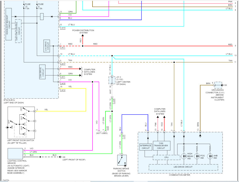

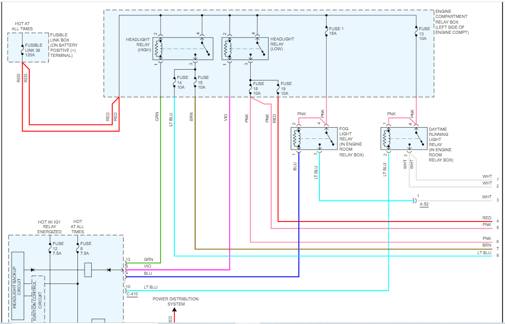

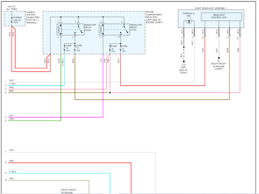

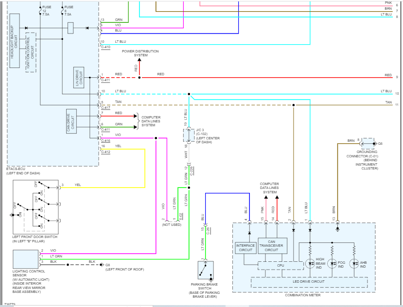

I know now why I did not understand you. You did not add wiring for front headlight (low and high beam) on your first exterior lighting wiring schematic. And I was looking for wire to low beam. And I did not get it. I get only parking wire.
1. I am looking for left or right wire for low beam. Could you please add wiring for the headlights too?
2. I do not have front fog light.
3. I do not know what are high-intensity headlamps. My lamps are LED lamps, they are not like H1/H7 lamps or not like D2S/D2R lamps.

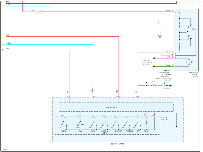

  • 110,194 POSTS

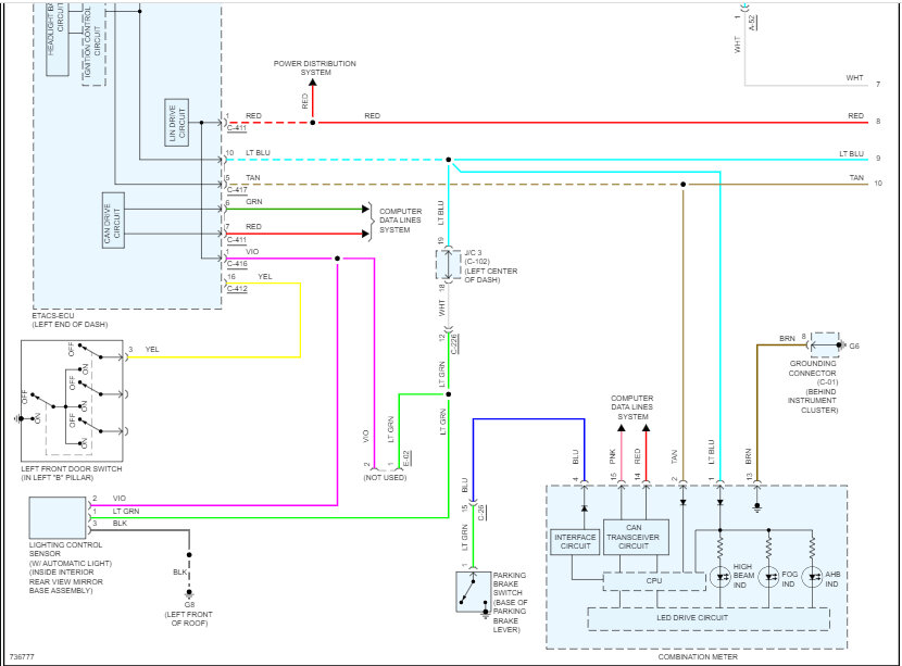

The first 4 pics below are the entire headlamp schematic without high-intensity lamps. The last 4 pics are with high-intensity lamps.

PAWEL_N
  • 178 POSTS
Daar Joe,
Thank you for your reply. I got all the information from you.
I know now that the signal from headlight's low beam is wire no 6 on C-410 connector on ETACS-ECU.

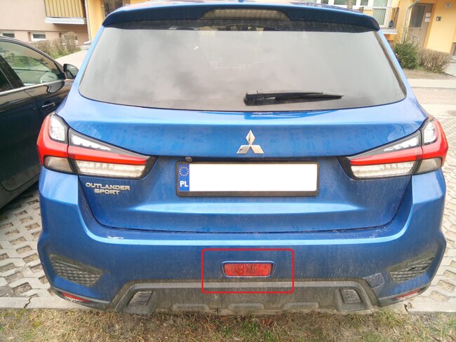

The job is done. The rear fog light looks like from the factory now :-) In EU country this car is name ASX, in the USA it is Outlander Sport.
I can control it by the additional switch from Mitsubishi Lancer.
