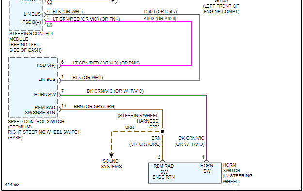

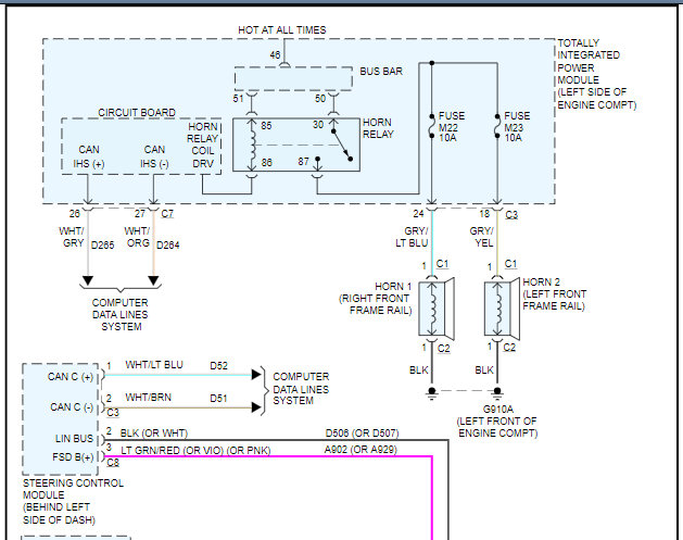

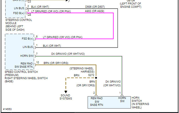

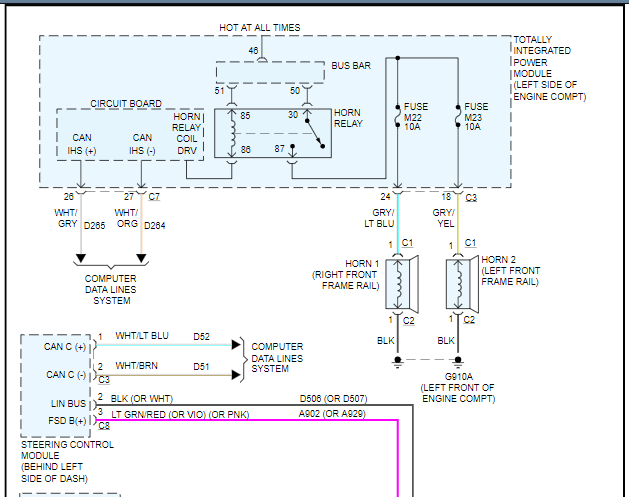

Could you please show a wiring diagram for my auto van listed above (LVVT)? I have some questions about electro component and wiring diagram will be helpful. For example; I would like to add an additional horn. And it is very hard to connect directly to original horn. Is there a place with wire to horn which I could connect it via relay?
I am waiting for yours answer.
Have a nice day,
Pawel
PS. I am sorry for my English, I hope you can understand me. :-)
Jan 7, 2021 at 6:40 AM
DANNY L
  • 5,648 POSTS
Hello, I'm Danny.
Here is the information you requested. Here is a tutorial showing how to test wiring:
I've attached 2 pictures below of the horn wiring diagram for your van. I've cut the picture in half so you can view larger. Hope this helps and thanks for using 2CarPros.

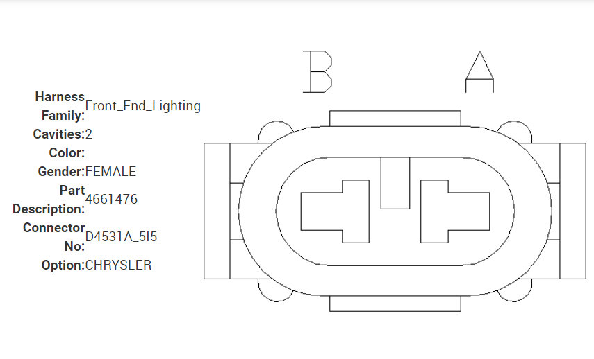

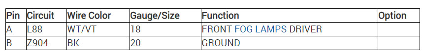

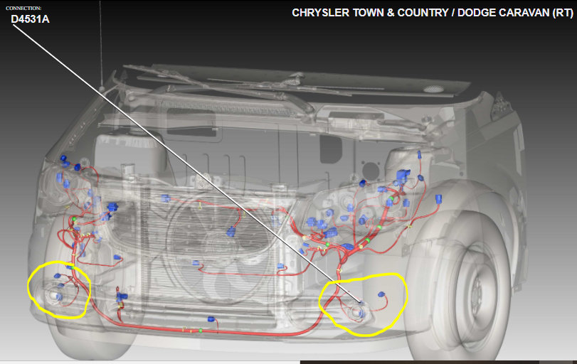

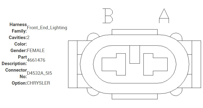

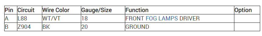

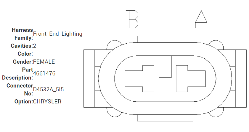

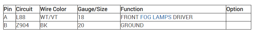

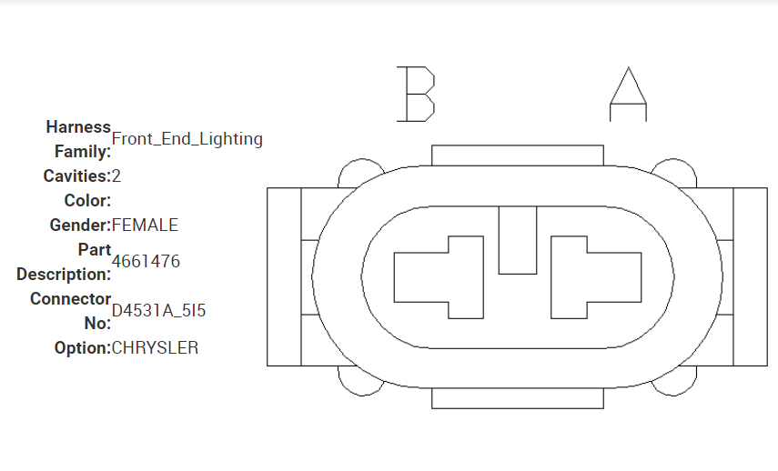

And the next question about wiring diagram. I would like to add DRL LED lamps instead of front fog lamps. I need to connect to +12V power supply after engine starts. Which wire or junction it can be near front left lamp which I could easy to connect?
Jan 8, 2021 at 5:15 AM
DANNY L
  • 5,648 POSTS
Hello again.
Since your van came with a fog lamp option the wiring harness will already be there in the fog lamp locations tucked out of the way. You will have to crawl under the front air dam fascia to look and see were the harnesses are. I've attached pictures of the connects below. The last picture shows were the harnesses will be located and are circled in yellow. Hope this helps and thanks again for using 2CarPros.
Jan 8, 2021 at 6:47 PM
PAWEL_N
  • 178 POSTS
Hello Danny,
Thank you for your reply. It is a good idea to use fog system wires for DRL light. But it should be powered by 12V after the engine starts automatically, not manually by pushing light switch. I need to disconnect wire or wires, I don't know which one goes to fog connector, from TIPM box. Or somewhere is better place where I can cut the wire and connect the 12V power?
