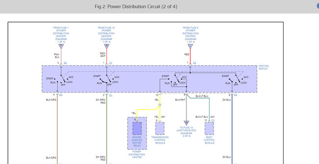

I have the car listed above rt coupe 3.0 that has the 6g72 Mitsubishi engine. now I recently had to install push start button with toggles for accessories, but my issue is I got no start. Need a chassis electrical circuit diagram.
Aug 1, 2022 at 11:54 AM
  • 55,433 POSTS
No problem. What part of the chassis do you need? Here is the ignition switch wiring which could help, also do you have a security light flashing? If so, this guide should help:

Okay. So, I was able to figure that out but now my fuel pump does not engage I checked with tester pump is receiving power but not when I attempt to start it does crank but I installed a diy push start button do to original owners lost keys and started to attempt to removing if ignition switch so I eliminated and added push button with toggles to accessories but unsure if I connected everything correct for 2001 Dodge stratus rt coupe 3.0 with engine 6g72.

Sorry, I forgot to add that I had to install push start button with accessories on toggle switches due to original owners lost key and began attempting to replace ignition switch but broke a lot off of it. so, I decided to do away with the ignition and key and put push start. yet car cranks but won't start. yet, everything lights work but yet fuel pump won't turn on today yesterday it did.
Aug 4, 2022 at 7:35 PM
  • 55,433 POSTS
Let's run the codes to see if the car is in security mode. I don't think you can run toggle switches.
Here is a guide to help:
Aug 5, 2022 at 11:00 AM
LEYNA07
  • 41 POSTS
I get code p1610.
Aug 10, 2022 at 8:41 AM
  • 55,433 POSTS
Code p1610 the immobilizer is in effect which prevents the engine from running unless the correct key is present. I would replace the ignition switch/lock with the correct key that is programmed to the car.
