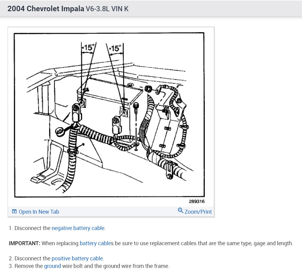

The wires burn could be because of high resistance which can be caused by a bad ground. I would check to see if the ground to the engine block and chassis is in good shape. Here are the ground locations so you can check it out. Here is the negative battery cable which shows the ground to chassis close to the battery. This could be the problem, please let me know if it is connected and not rusted out. Check out the diagrams (below). Let us know what happens and please upload pictures or videos of the problem.
