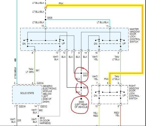

The driver’s side window works but, the passenger side window does not work, all of a sudden. We tried checking the the fuses and even changed the window regulator and motor and switches. Also, the button to open the trunk, on the passenger side, does not work either.

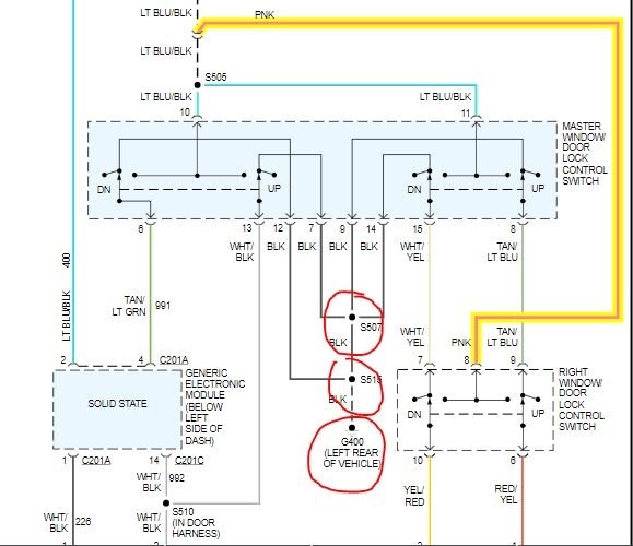

We need to determine if it is a power issue or a ground issue. The first thing I want you to check is if there is power to the pink wire going to the window switch on the passenger side. If there is, then I need you to check the tan/lt blue and the white/yellow wires have continuity to ground when the key is off and the switch is in the neutral position. If there is no continuity to ground, there are two splices in the wiring before it gets to ground so you will need to trace them to confirm they are not damaged and also check the ground to make sure it is tight, clean, free of corrosion, and nothing was damaged.
See the attached wiring schematic as a reference.
