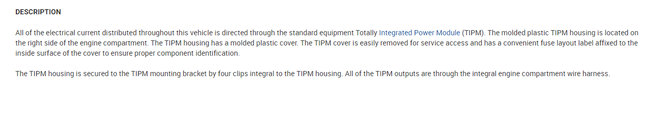

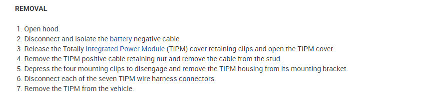

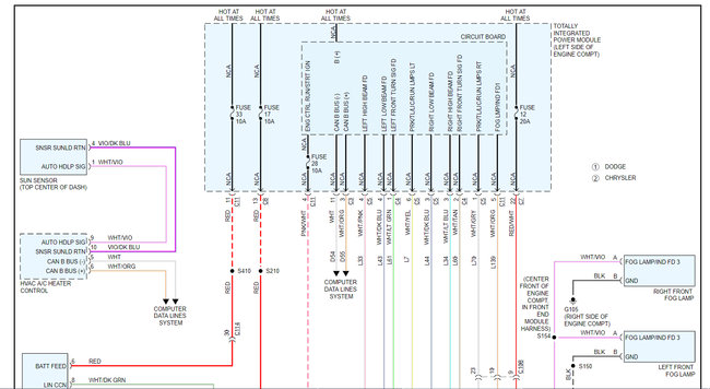

I attached the wiring diagram of the TIPM that controls the headlights. In most cases, the TIPM is the issue with the headlights.
I would first check the charging system and make sure you have 14 to 14.5 at the battery. If the bulbs are failing often, it can be caused by the alternator overcharging.
You need a scan tool to monitor the output of the module. Like I said, in most cases the module is bad.
