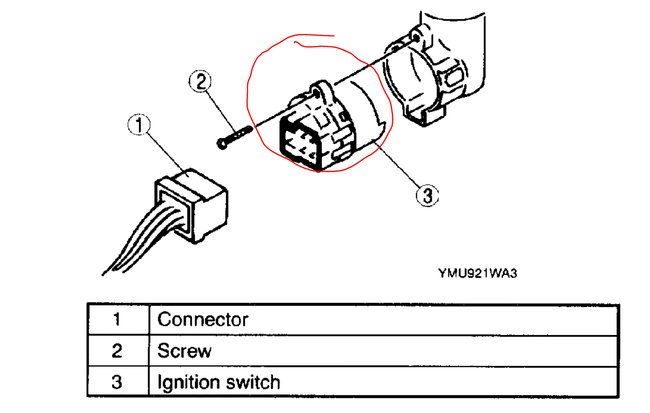

I just got my car out of impound after it being stolen, the ignition well there is no ignition (had to have it towed). Need to know how and what tools to bypass computer. I have tried using my key and that didn't work.

The computer can't be bypassed. When you say there is no ignition, what do you mean? Was the switch damaged or removed? See pic below.

Where you put the key at has been drilled out, they were where starting it with a screwdriver on the left side.

They were putting a screwdriver in a hole which would be I believe part 3 on the diagram you sent.

Okay, did you note if there is any damage to the wiring or connector to the switch? Also, what happens when you try to start the vehicle?

Doesn't look like it. it was cranking and not starting but know it won't crank either. Lights all come on radio and everything.

When you try cranking, do you hear a click or anything? Also, try this simple load test and let me know what you find.
At this point, we aren't 100% sure of what was done to the vehicle. So, there is a chance the battery is draining and too weak.
