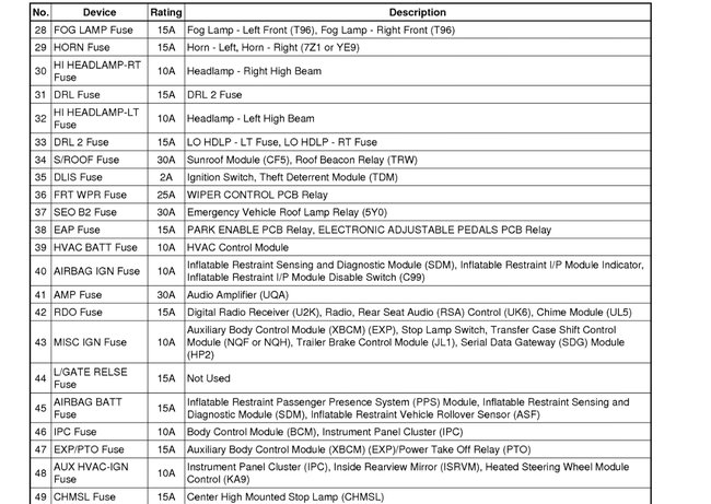

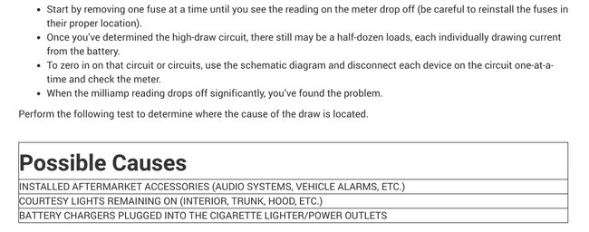

battery drain, when i disconnect the positive cable the one held with the brass nut going to the fuse box in the engine compartment the drain to the battery will stop. also every time i connect the cable i get sparks until i tighten the nut.
Nov 27, 2019 at 6:43 AM
SCGRANTURISMO
  • 4,897 POSTS

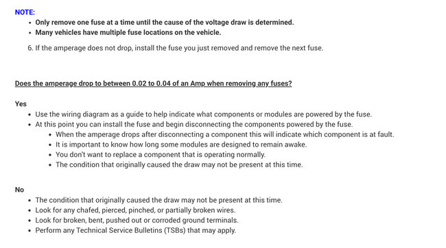

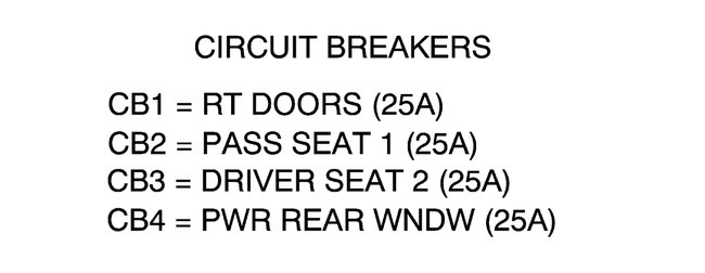

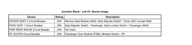

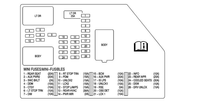

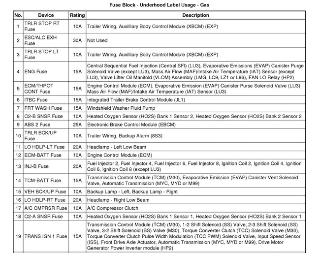

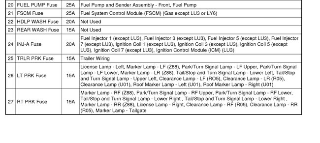

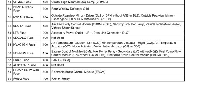

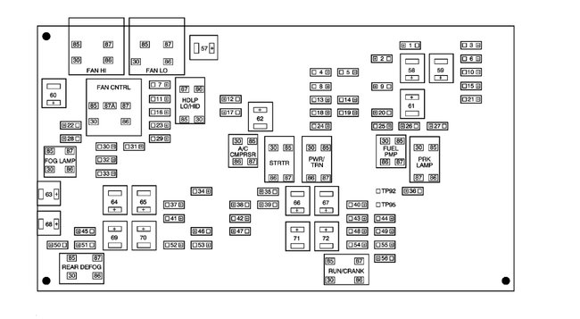

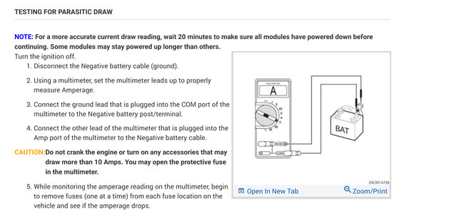

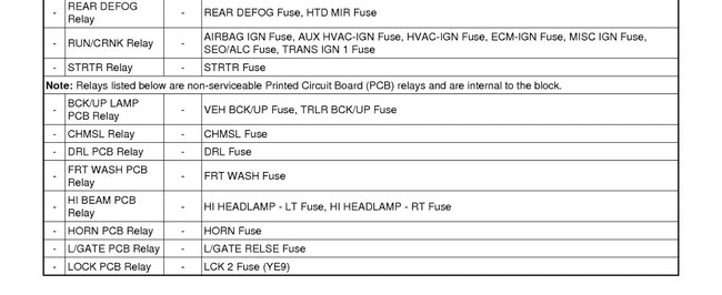

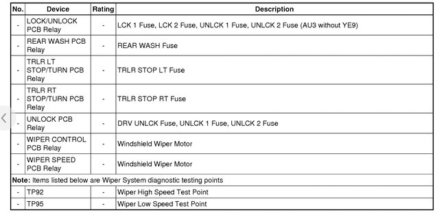

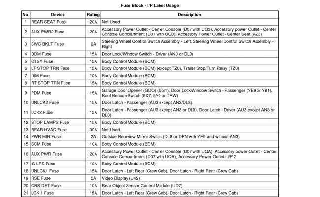

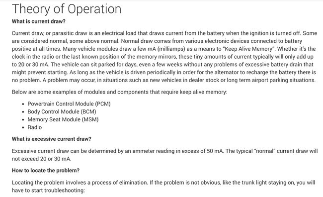

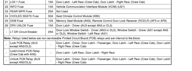

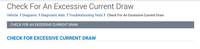

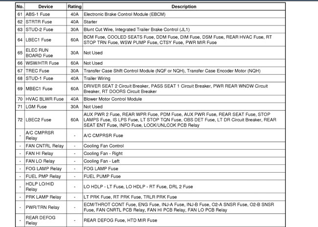

This definitely sounds like have a Parasitic Draw issue going on here. In the diagrams down below I have included a guide for you that explains how to track down the circuit that is causing parasitic draw along with the fuse box diagrams and callouts for your vehicle. Here is a generic guide for you to start with in the link below:
https://www.2carpros.com/articles/car-battery-dead-overnight
Please go through these guides and get back to us with the fuse that is the problem and we can go from there.
