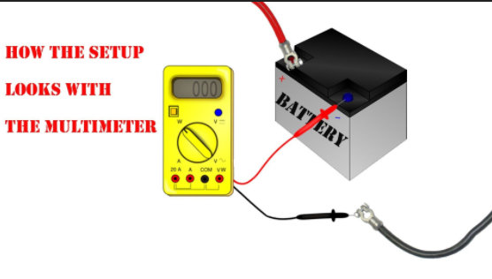

New battery, new starter, new switch, new engine relay. Battery drains out in 24 hours. When you touch ground wire to post it sparks. I unplugged the throttle body and mass air flow still sparks. When you turn the key the instrument panel lights up, when you turn the key further to start all power goes off. I started pulling fuses inside and the 10amp to the engine clears the spark on the battery. I unplugged the MAV no change. Would a bad unit cause the loss of power when you turn on the key to start? Herb Liner

The short answer is yes, but let's take a step back and use a different way to confirm this fuse is the cause of the issue because even though I understand the sparking may point us in the right direction it is not definitive.
We need to test for the battery draw. This guide talks about this issue but I will give more details to properly address this:
https://www.2carpros.com/articles/car-battery-dead-overnight
Please see the diagram below and that will explain how to set your meter up in series with the battery so that we can confirm this fuse is the cause of our issues.
Then we need to get a picture of the fuse you are removing so that we can be sure we are on the right circuit. Then we can figure out what is causing this on that circuit with the proper diagram of the system.
Please see below and let me know what amperage you have with the fuse in and out.
Thanks

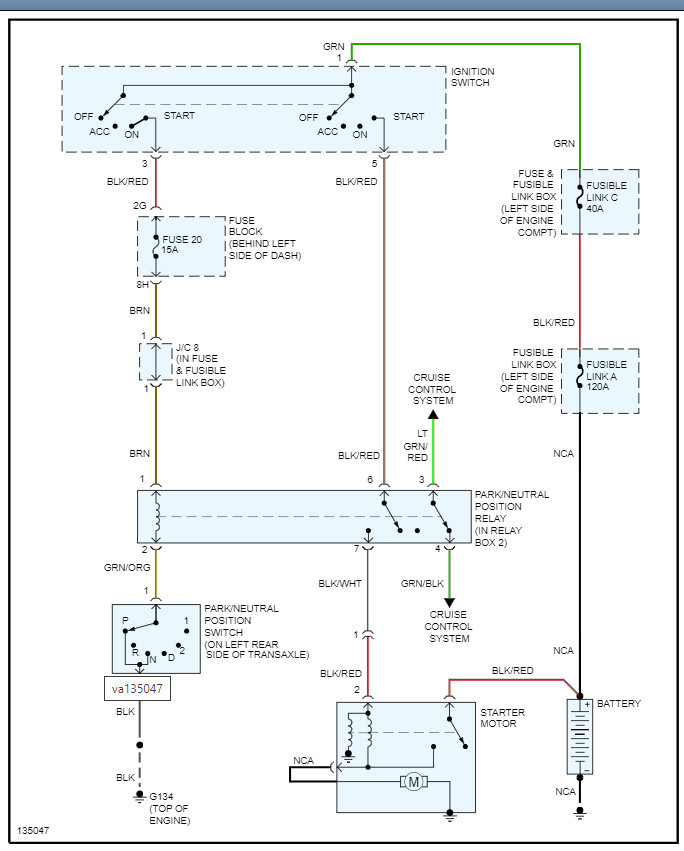

Okay. Got it. That makes sense. Then I agree that the ECM is the likely issue.
Basically, all electrical accessories are turned off while cranking because we need all available amperage to go the starter.
So, if you turn to start and everything cuts off, but nothing happens then it could be an ECM.
However, we need to confirm this by checking voltage at the park neutral relay. If you look at the wiring diagram you start circuit goes through two sides of the relay. Basically, it sends voltage through the park neutral switch and if it is in park or neutral then there is a path to ground, and it closes the relay to send power to the starter. Technically the ECM does not control this.
Before you get too far down this path though, since you had an issue with the battery draining overnight, we need to take the battery into a parts store and have it tested.
A drained battery that may show 12 volts on a meter may not be able to start a car so this is where we should start but especially since there was an issue with it. Even if you charged it, it may not be able to hold the charge and it will cause this.

It's a new battery and fully charged. I'll check the park neutral switch and get back to you. Thanks, Herb
