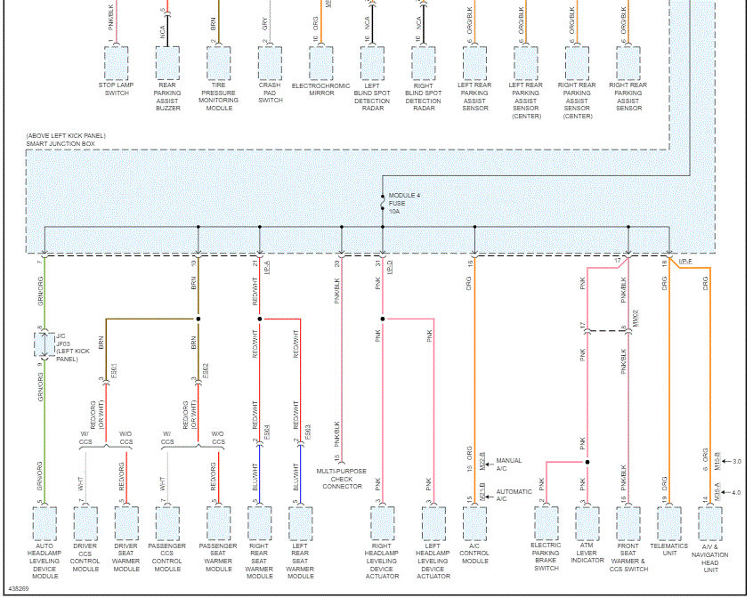

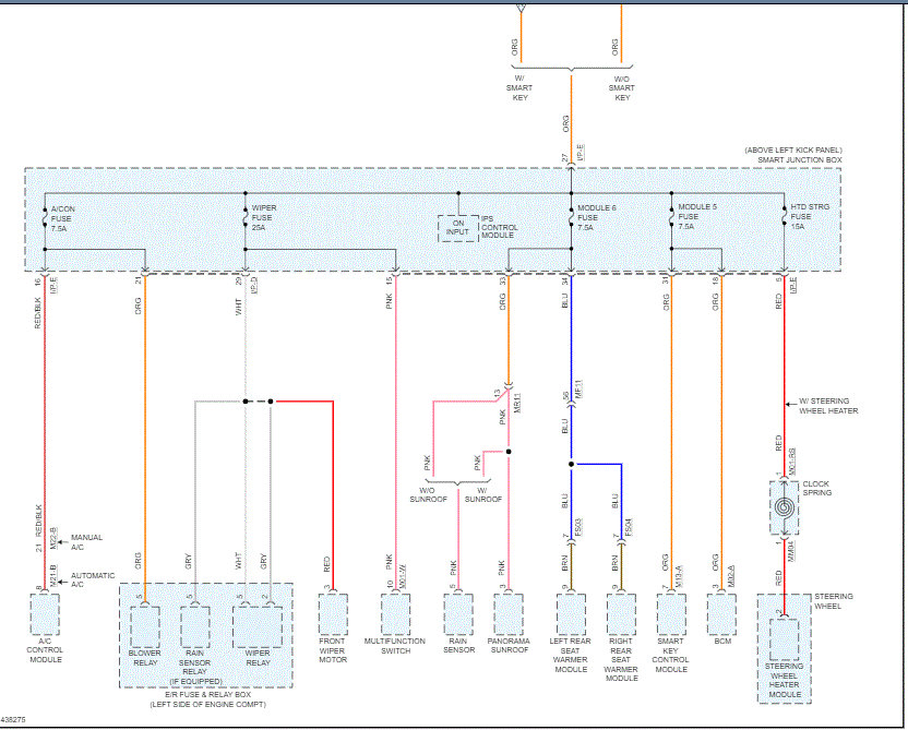

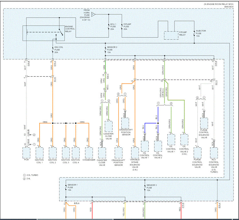

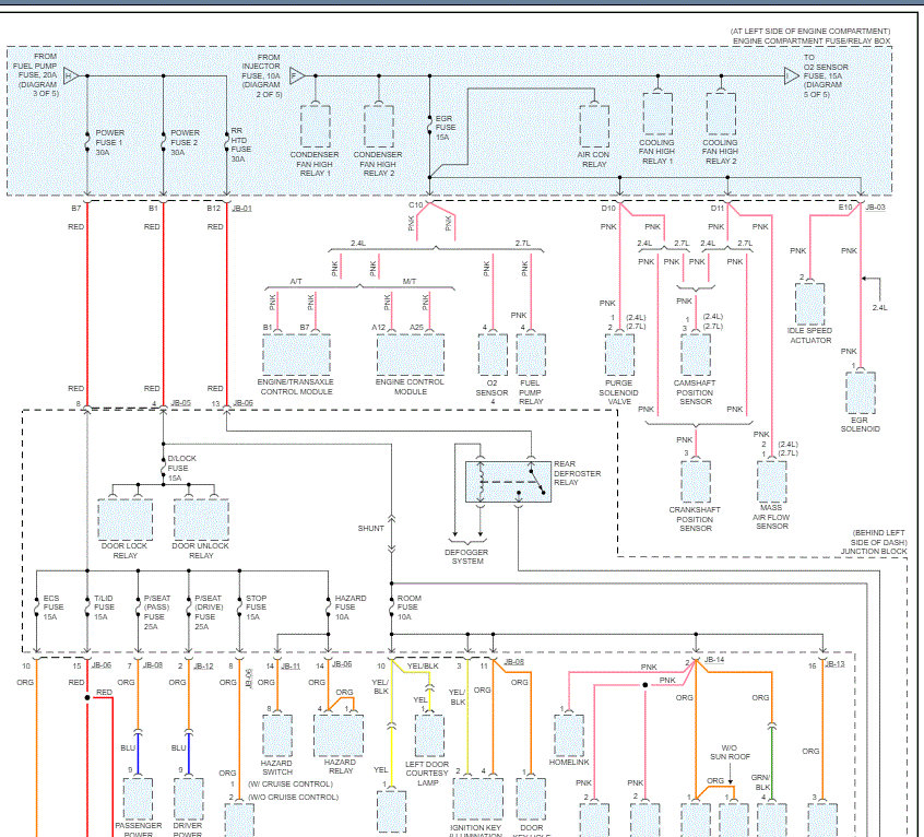

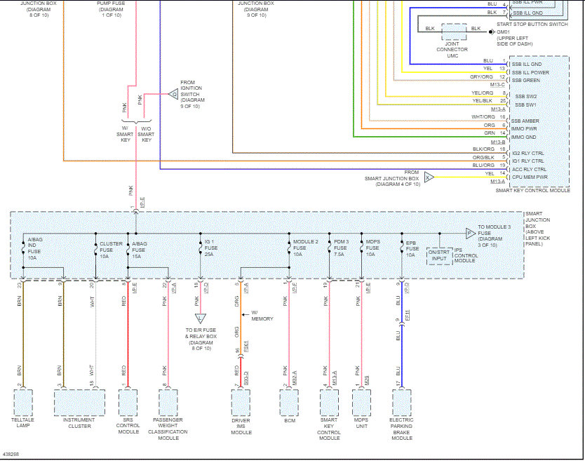

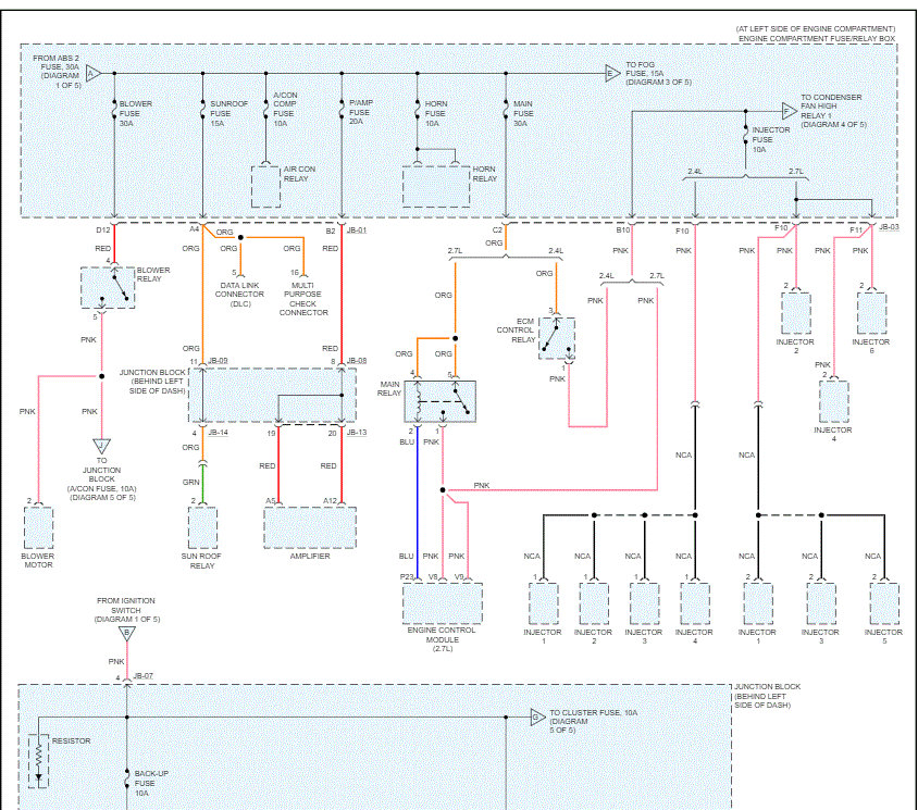

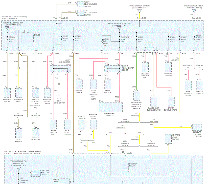

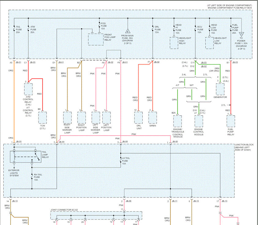

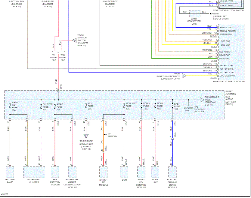

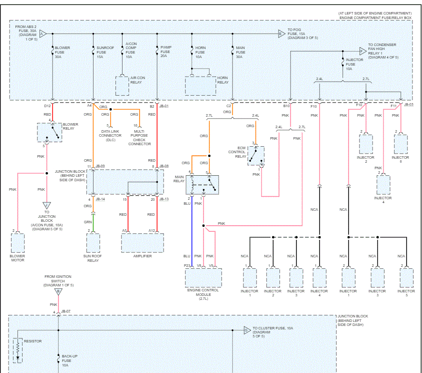

wiring/power distribution diagrams from under hood fuse box for power fuse 2 circuit needed
2004 KIA OPTIMA
150,000 MILES • 2.4L • 4 CYL • 2WD • AUTOMATIC
PURPLE2462
  • 15 POSTS

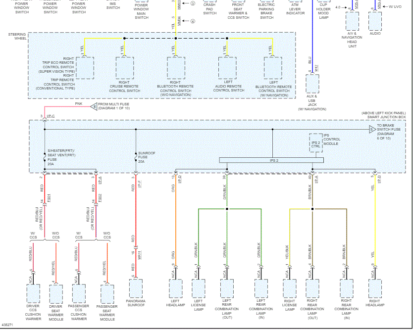

Hello, after doing a test with light and pulling fuses I am showing I have a couple short I believe these are connected to issues I am having with door locks going off randomly for one to start with and I suspect there is more . Thanks
Mar 26, 2020 at 8:40 AM
  • 110,240 POSTS

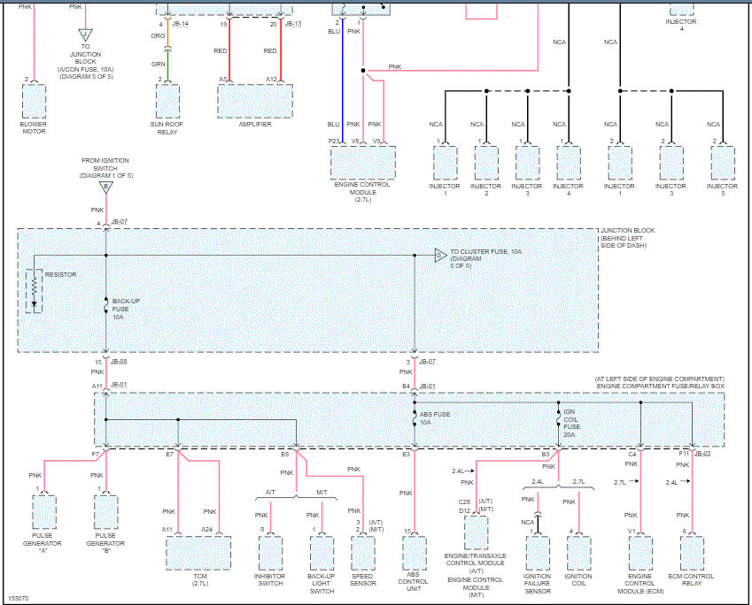

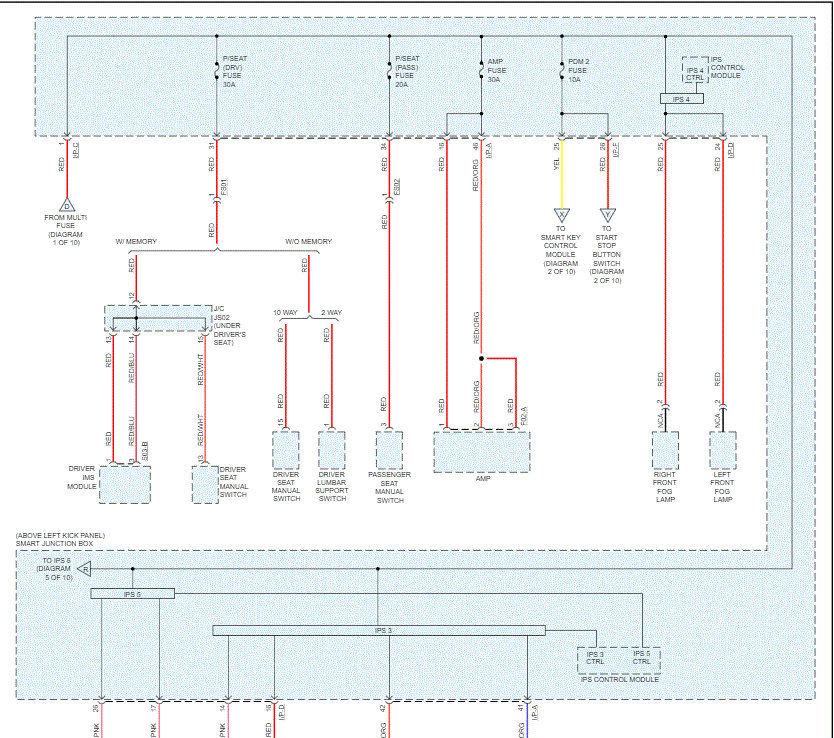

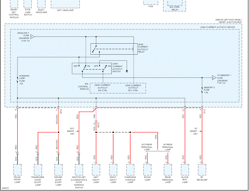

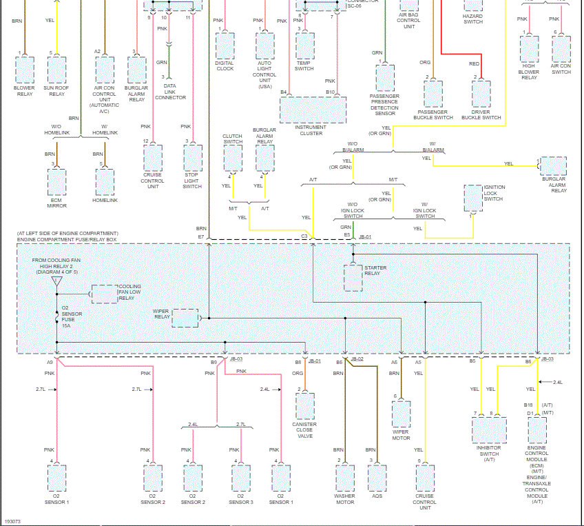

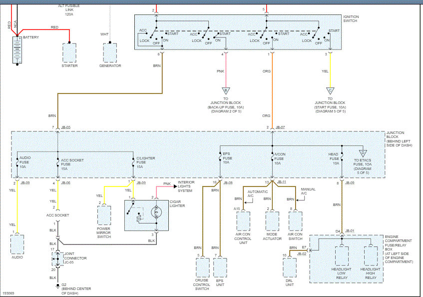

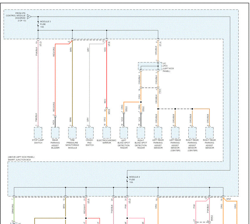

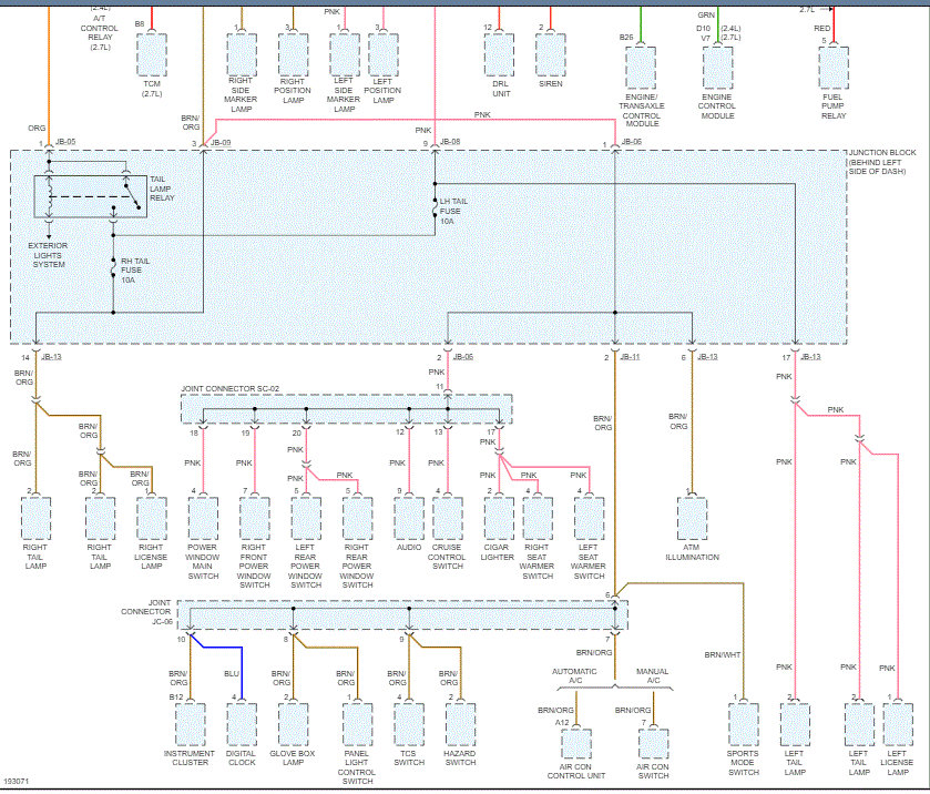

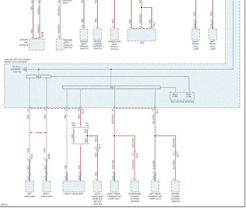

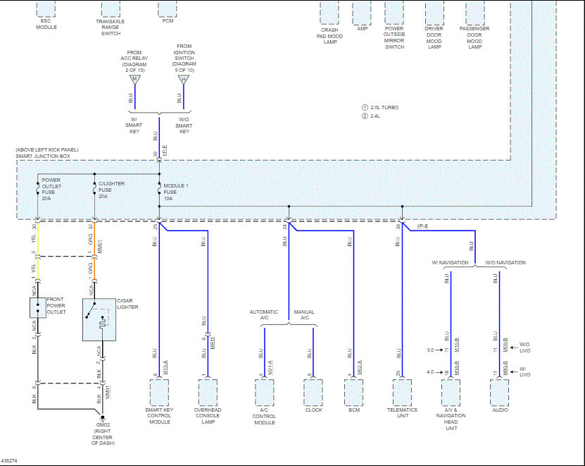

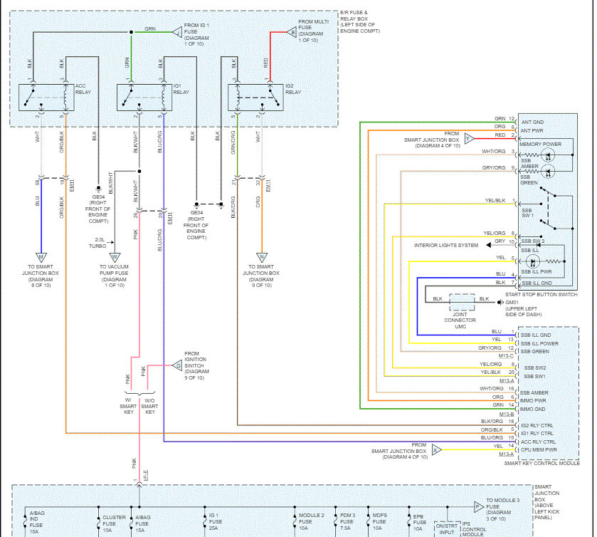

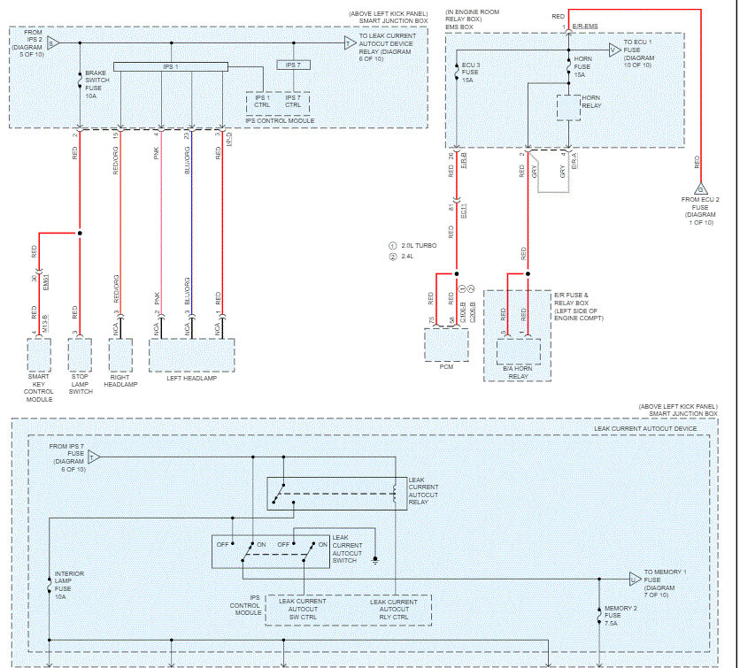

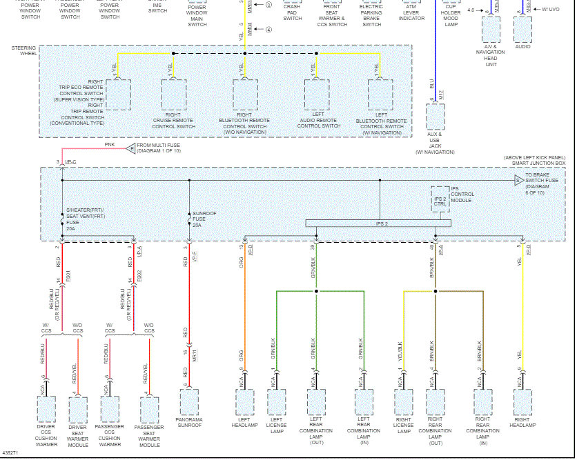

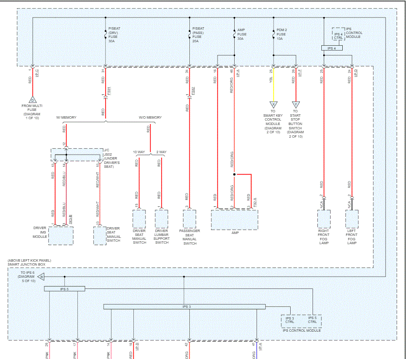

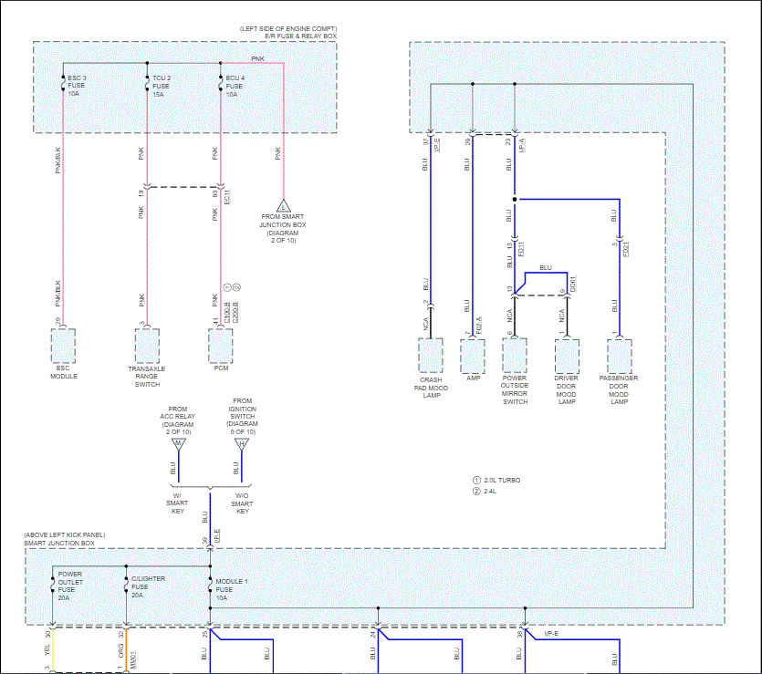

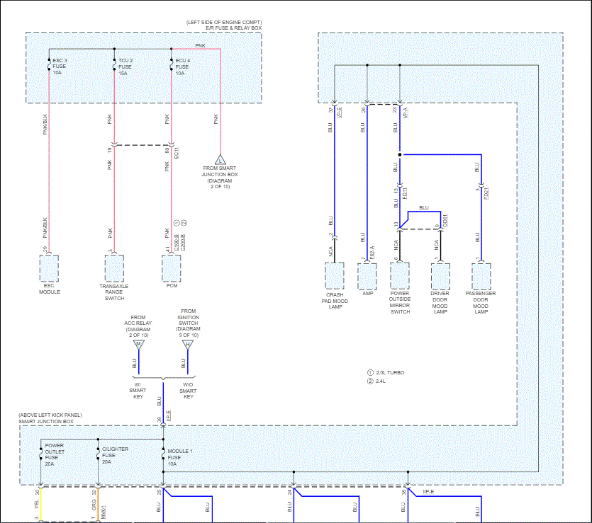

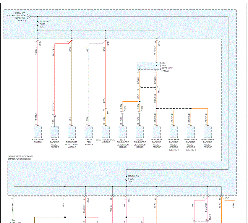

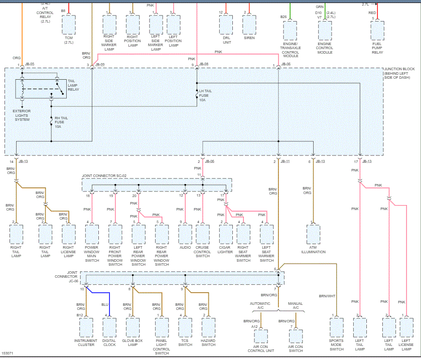

I have attached the entire power distribution system schematics. I had to cut the pics in two to make them readable. I did overlap them so you can follow them.
Let me know if this helps.
Mar 26, 2020 at 9:11 AM
PURPLE2462
  • 15 POSTS
Thank you and will let you know what I find.
Mar 28, 2020 at 10:57 AM
  • 110,240 POSTS
You are very welcome. Take care and I'll watch for your reply.
Mar 28, 2020 at 11:31 AM
PURPLE2462
  • 15 POSTS

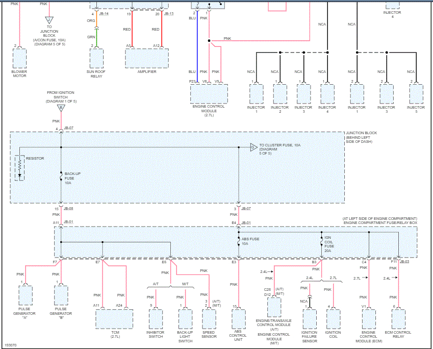

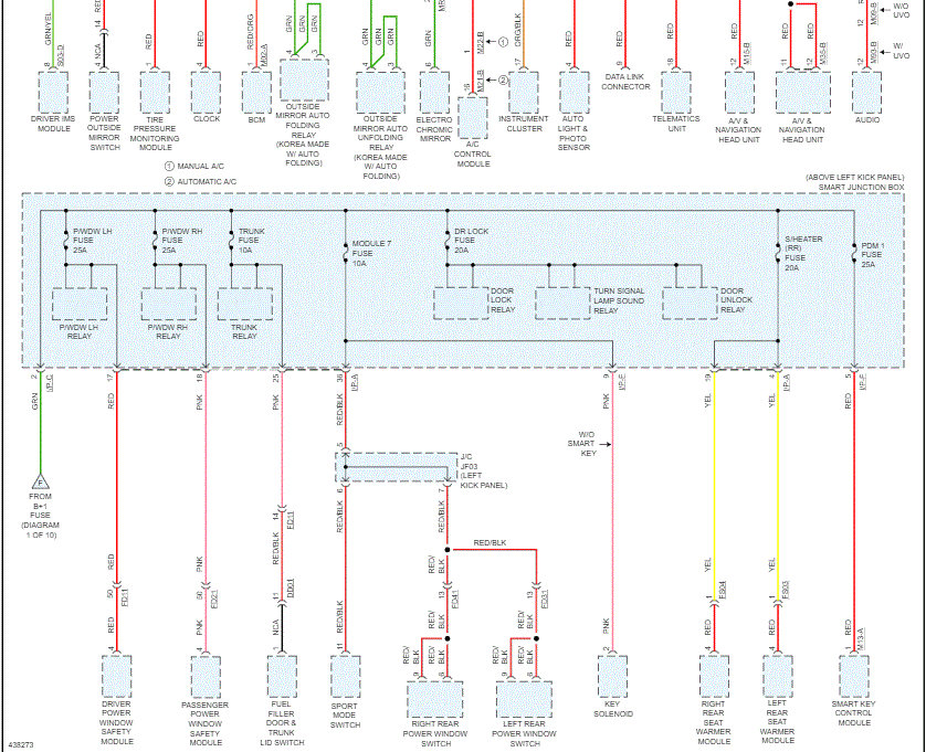

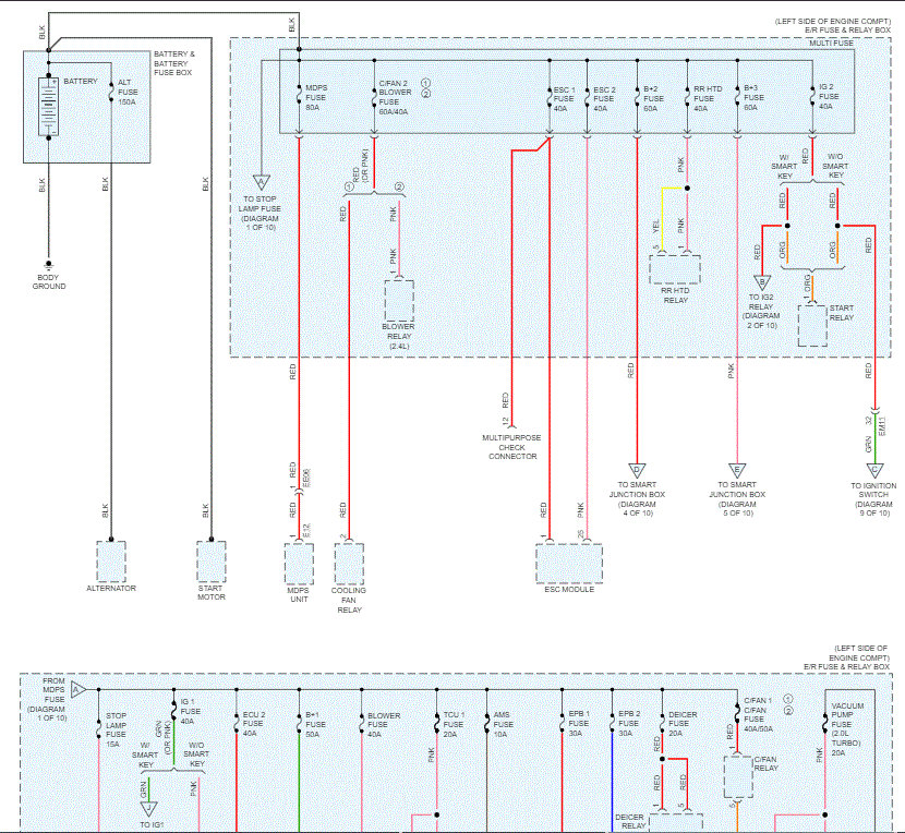

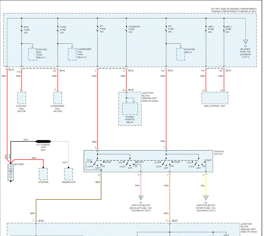

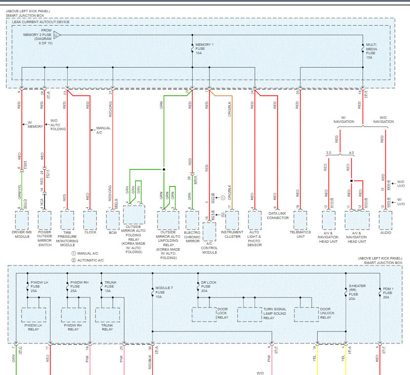

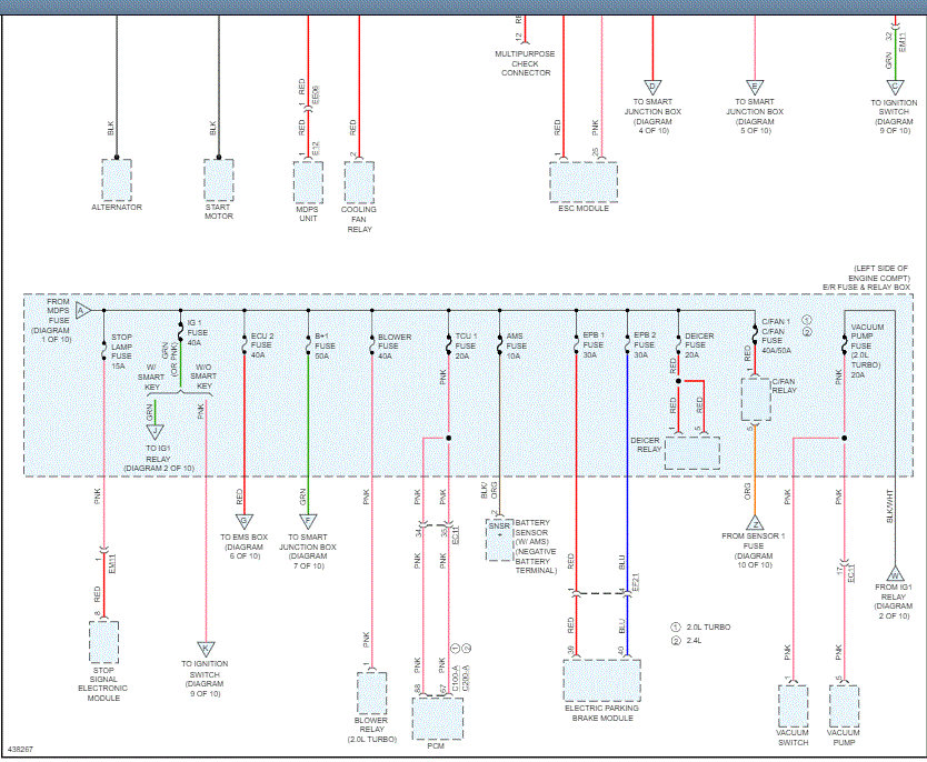

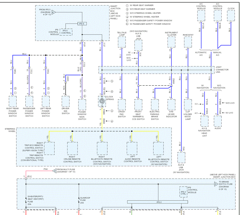

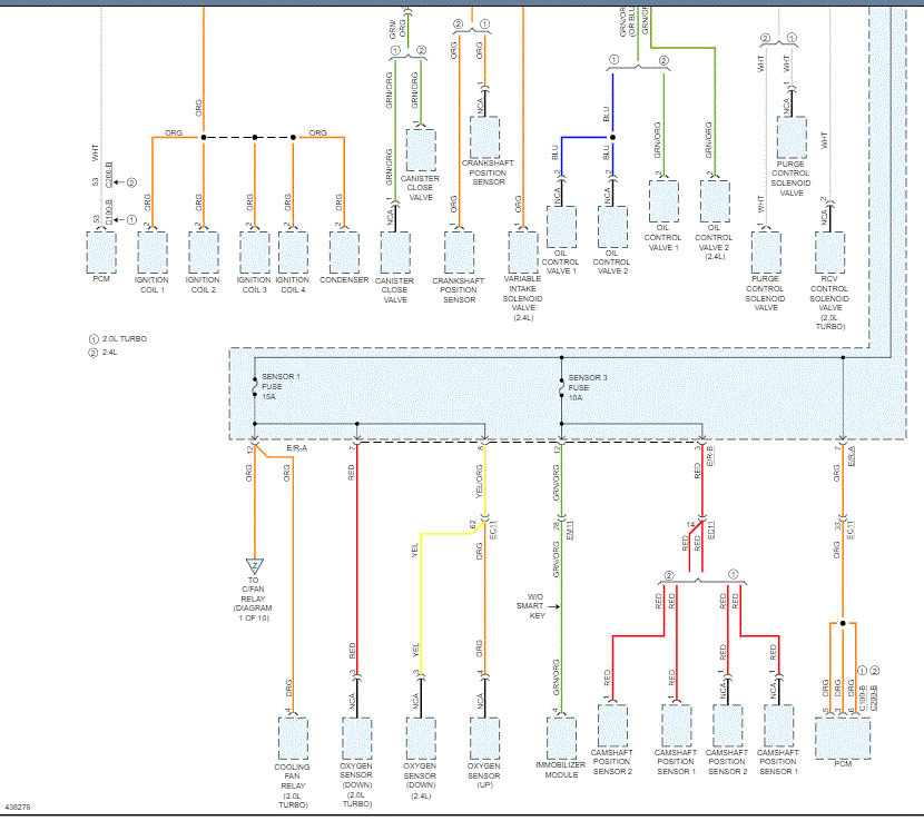

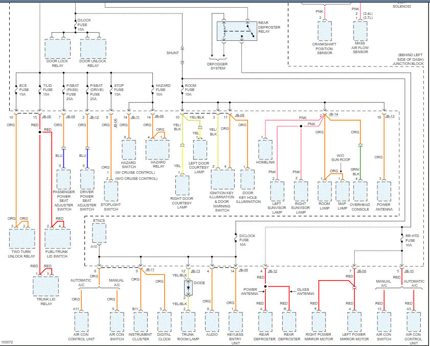

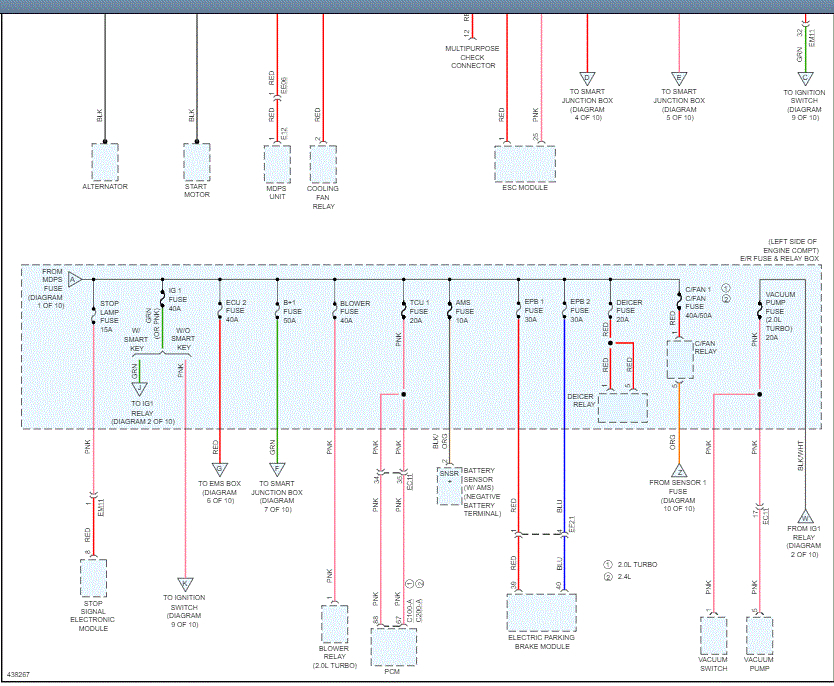

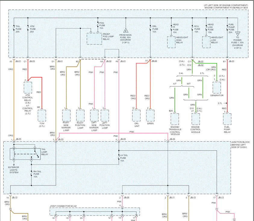

Hi there, after having chance to look some at the diagrams. The first diagram caught my attention showing fusible link off positive cable a 150A, where mine is a 120A. These are for 2004 Kia optima Ex 2.4L , correct? Just want to verify you had right info on car, I will decipher through them if these are for the car. I don't know something seemed not right. Not seeing like power fuse 1 or 2 (10A fuses) from engine box and seeing others I don't recognize. Thanks much
Mar 28, 2020 at 1:47 PM
  • 110,240 POSTS

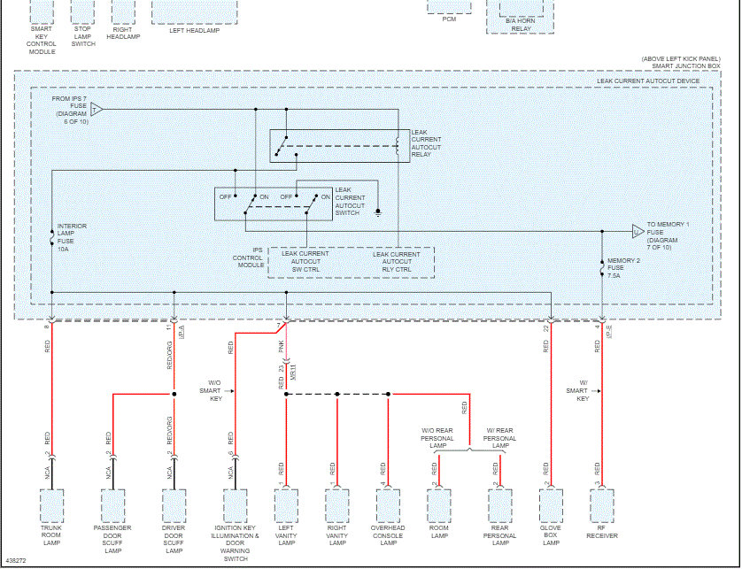

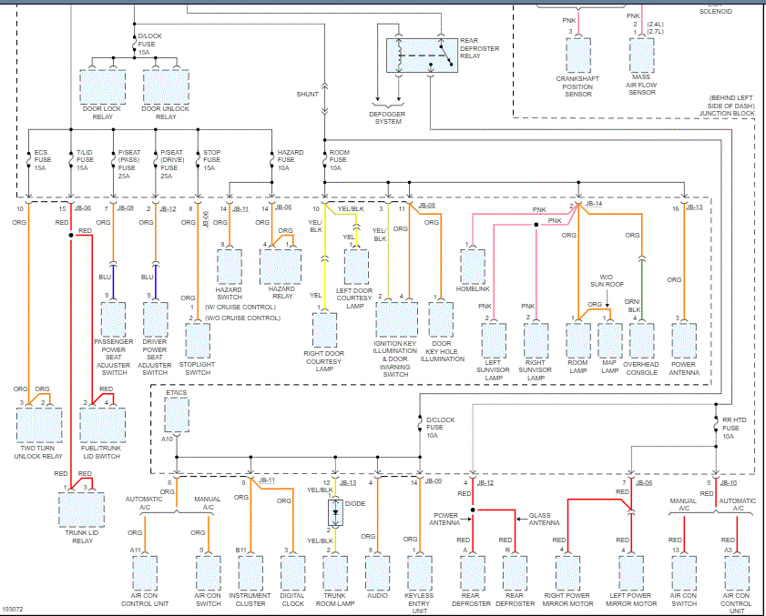

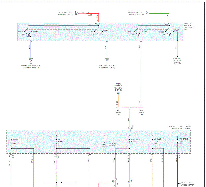

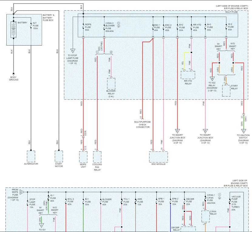

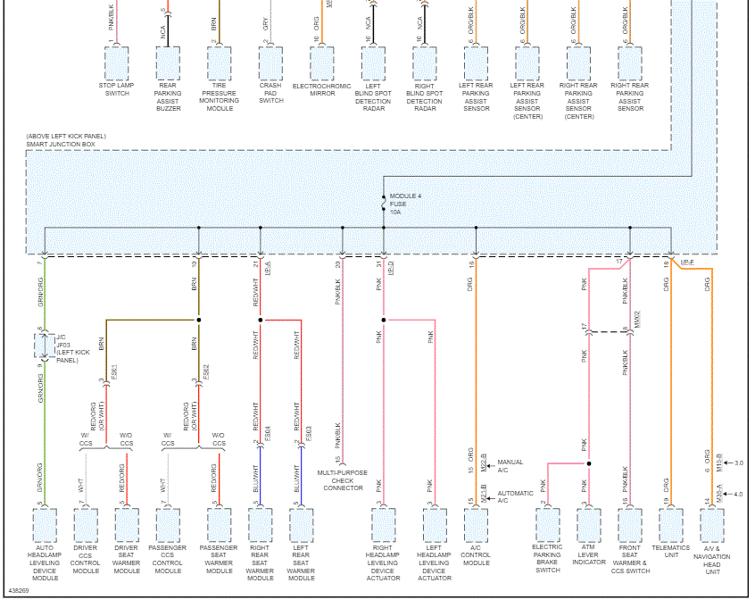

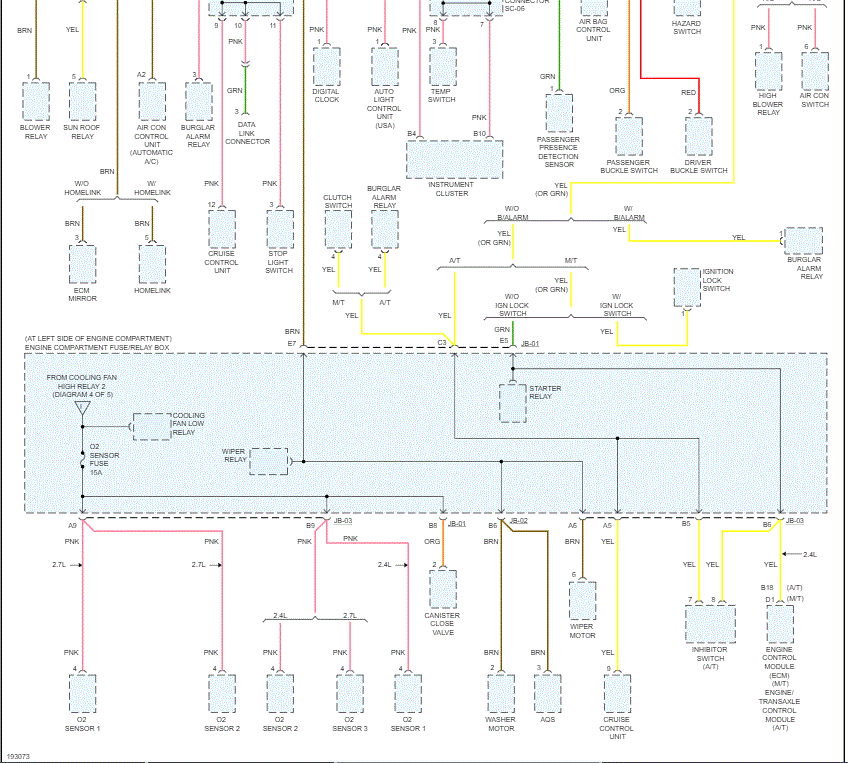

Not sure why, but the EX made a difference. I'm glad you saw that. Here are what I have for this specific vehicle. Please look over them and confirm it looks correct. I have dealt with production changes mid year in the past.
_________________________________
Let me know. The good news is it isn't quite as involved.
Mar 28, 2020 at 3:10 PM
