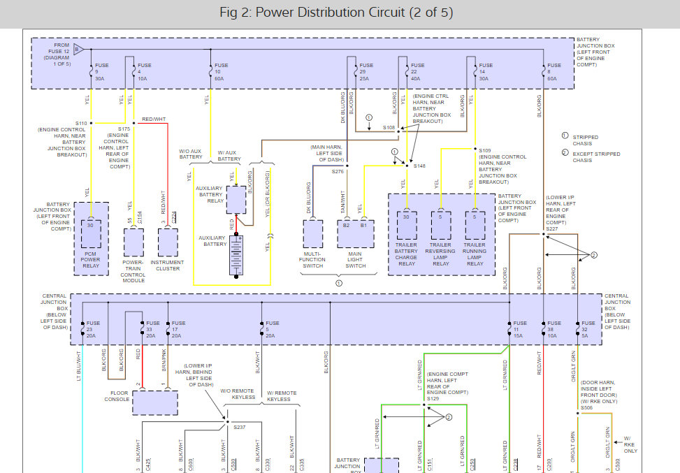

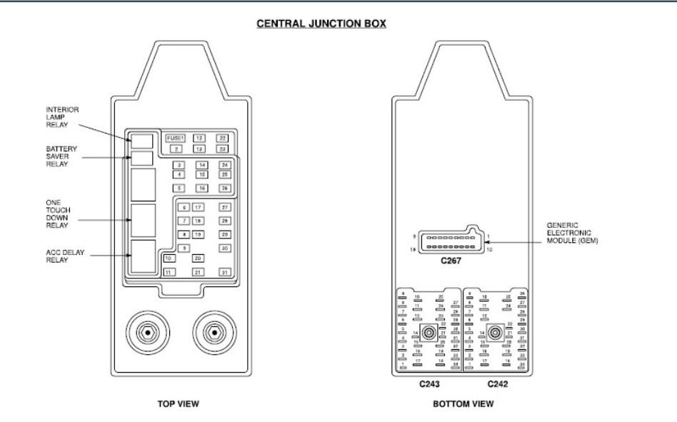

Ants and moisture in wiring harness under-hood, no radio, overhead console, interior lights, other intermittent problems. Wanted to know under-dash relay location diagram and circuit description. I have checked and cleaned body ground locations behind kick panels and most visible wiring connectors. I know of two relay boxes on passenger side, and one on driver's side left of A/C control; with at least two each.

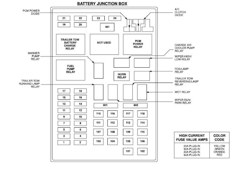

Good morning.
I posted the relay and what they control at the bottom.
Here is a guide to help you test it:
Let me know what exact circuits you need to view as there are so many of them.

I have the owners manual, so I know the ones in the fuse-boxes, but there are two separate, small relay panels above and behind the glove-box/heater box assembly, etc., and one small relay panel under drivers' side. If I remember correctly, there are at least two relays in each of those panels. Just wanted to make sure what they control (BCM, LCM, pedal adjustment, etc.). I had to fix an older Crown Victoria that would not run years back, was PCM main relay. Was hidden, no books I had been told where it was. An old Ford expert I knew had a book and gave description. Same boat now, just need to know which set controls what. And I will write it in repair guide and owners' manual.

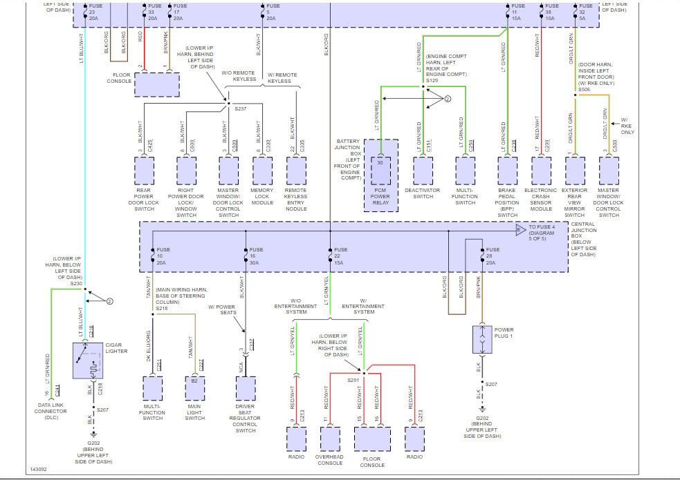

Can you see if you have power at fuse #22? Here is the power distribution wiring diagrams so you can see how it works and a guide to show you how to test for power:
Check out the diagrams (below). Please let us know what you find.
