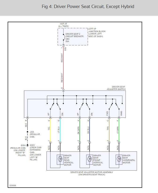

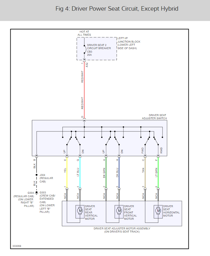

The power seats on both sides do not work at all on my extended cab. Also the windows on the passenger side do not either. I've checked the fuses and all appear to be good. As far as the seats go their is only one breaker box under the d/s dash. I cannot believe that all the breakers would have gone bad all at once. Plus I do have ground to the seat switches but no positive.

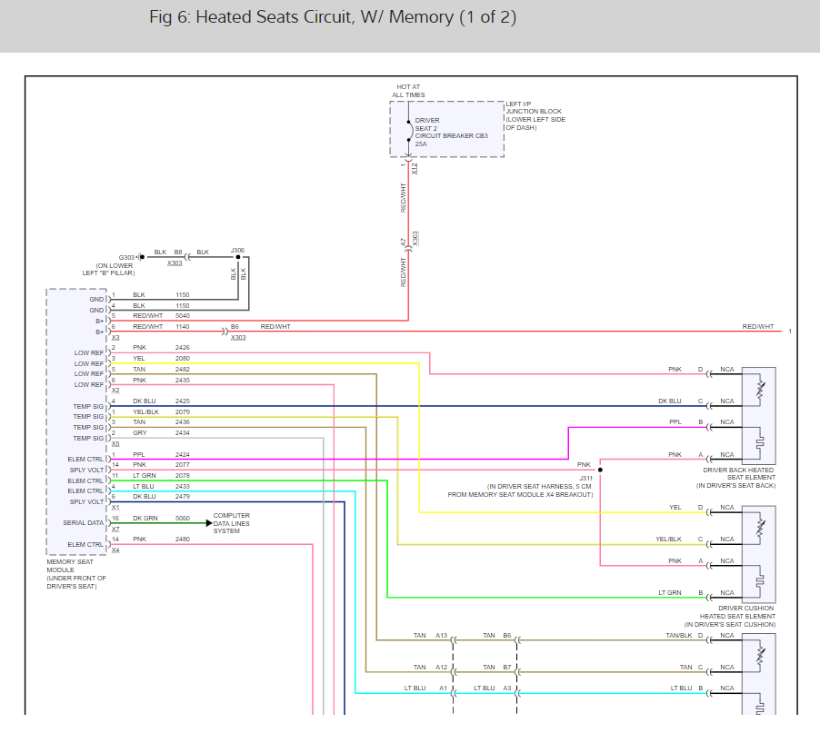

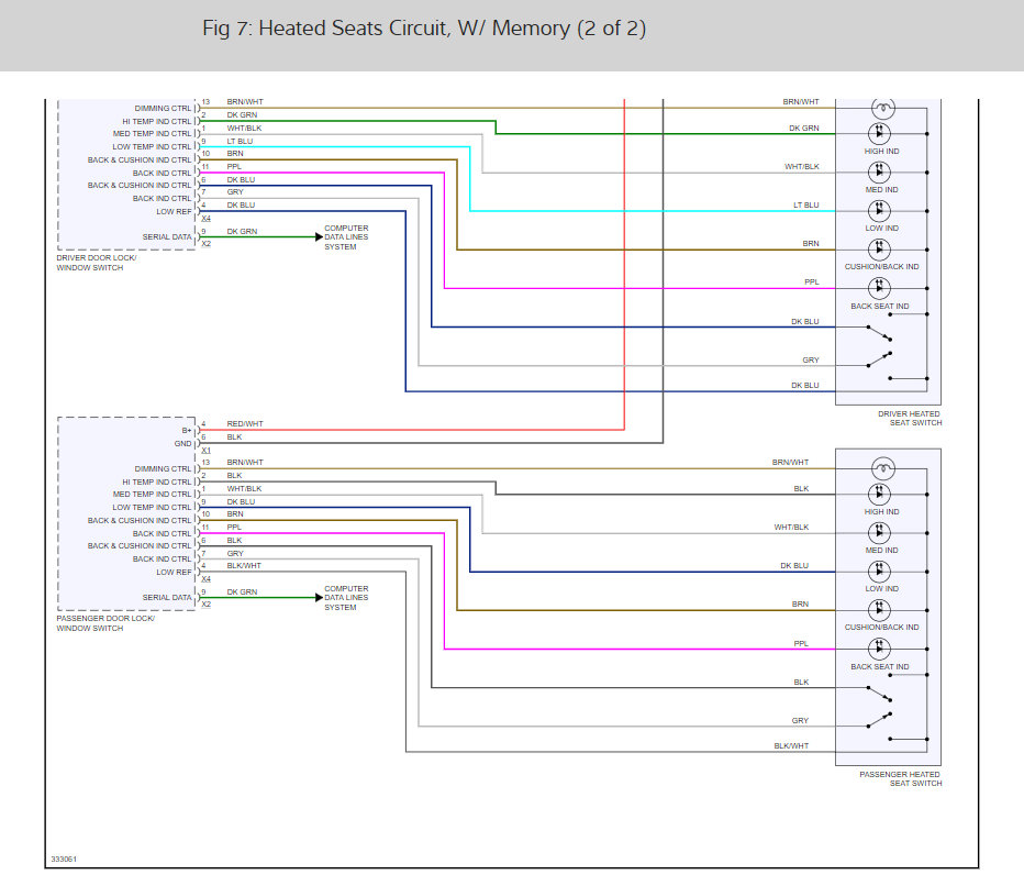

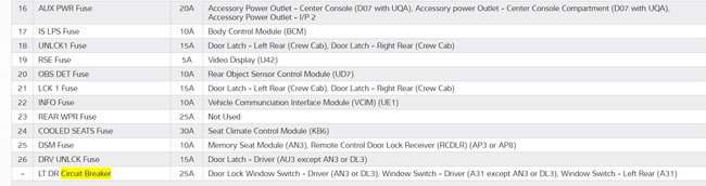

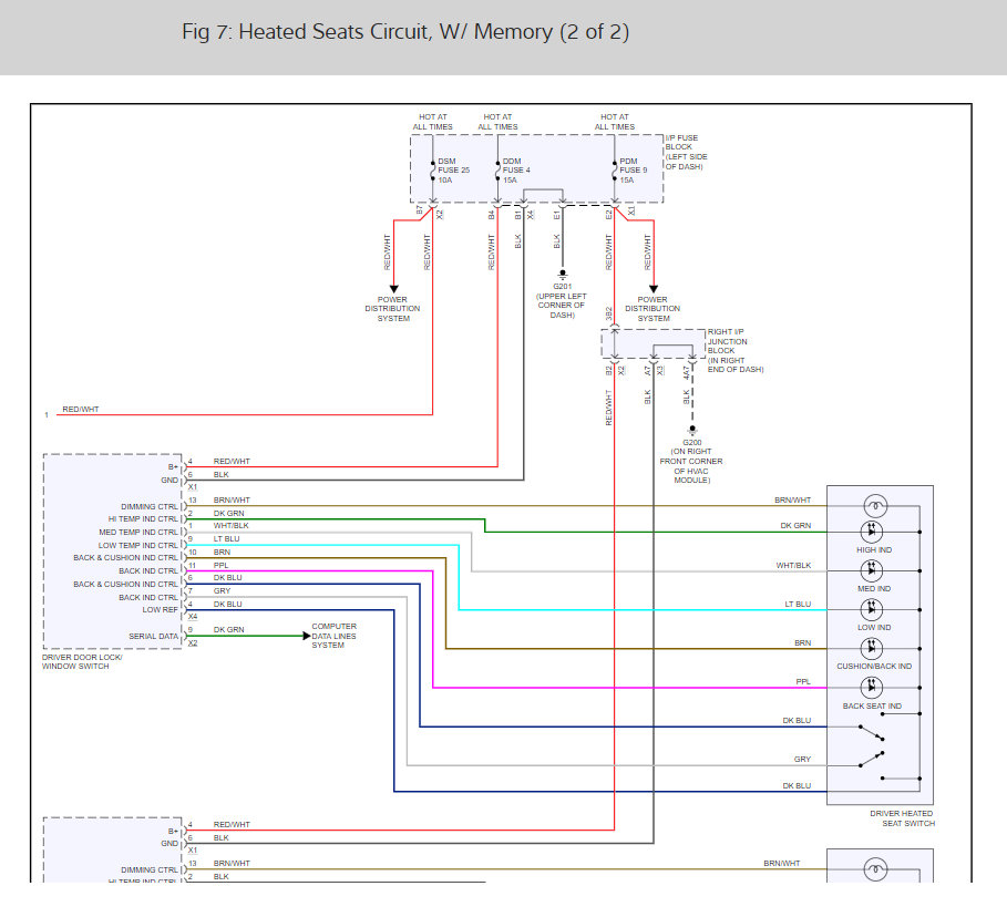

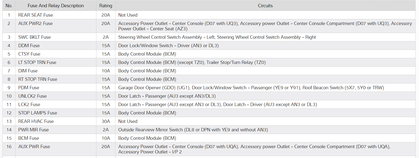

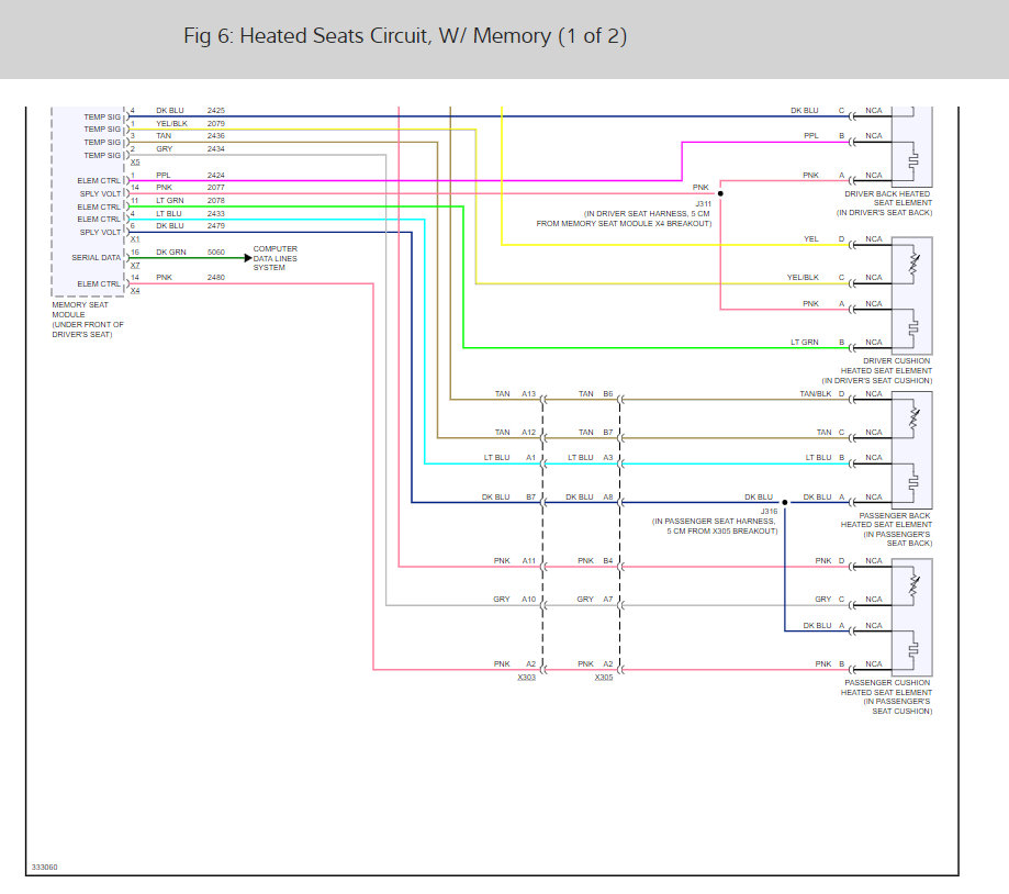

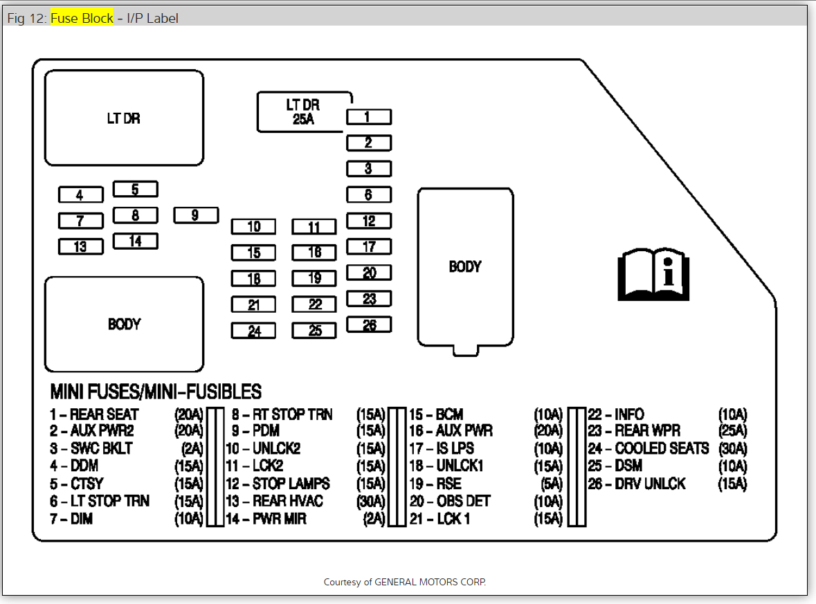

Can you check for power at the PDM #9 fuse interior fuse panel? here is a guide and the fuse location:
Here is the seat wiring diagrams so you can see how it works. Check out the diagrams (below). Please let us know what you find. We are interested to see what it is.
