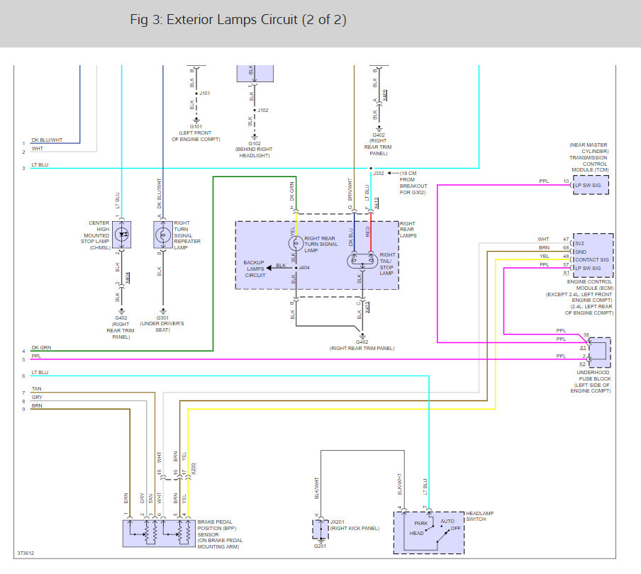

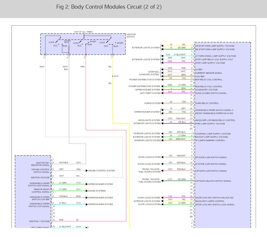

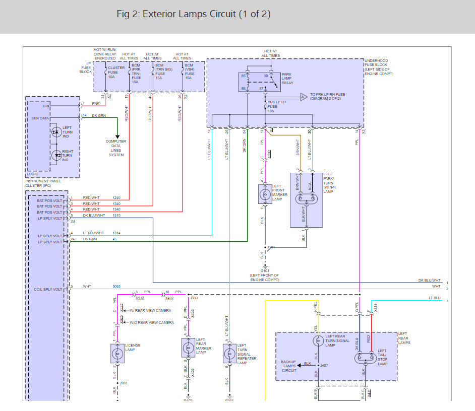

I bought car from a guy and it had a salvage title. Not sure why. Had several electrical issues including no brake lights or back up lights. power sunroof does not work either. replaced and flashed the BCM, twice, and still no resolve. One computer says wiring problem, however when jumping the wires, the brake lights come on. Replace fuse box, brake lights stay on, won't go off. Re-programmed, still no fix. Dealer doesn't have an answer, and three mechanics have no answer. Help! One guy suggests possible lightning hit, could main computer have an issue with the BCM?

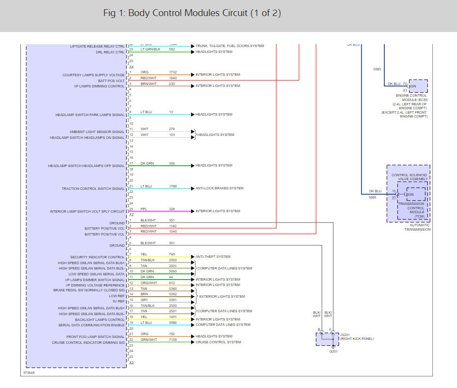

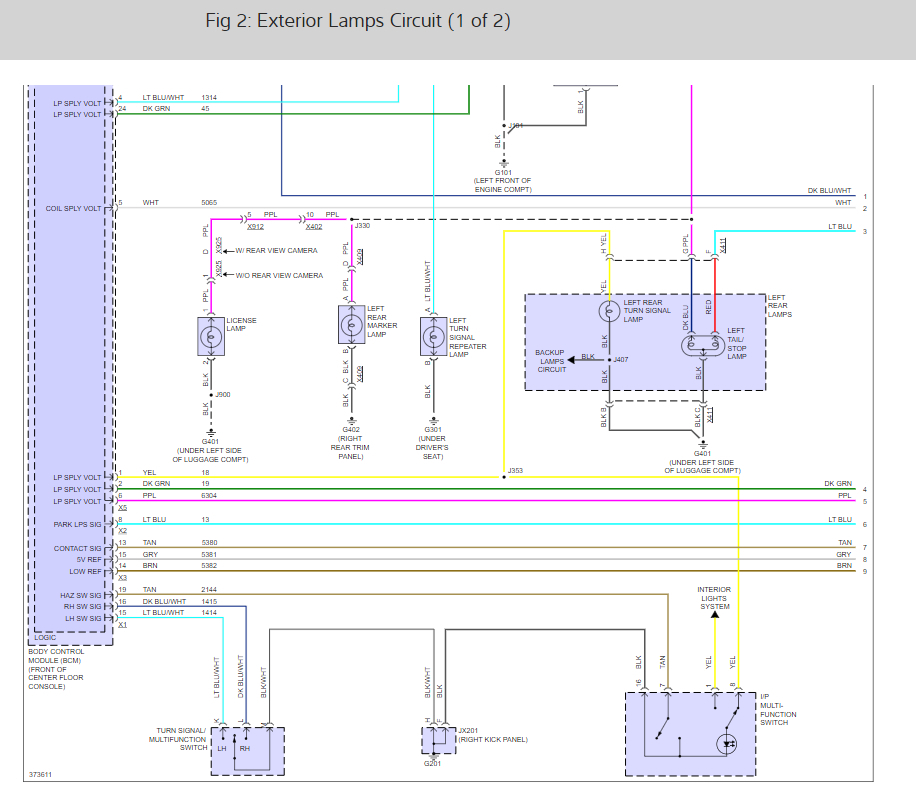

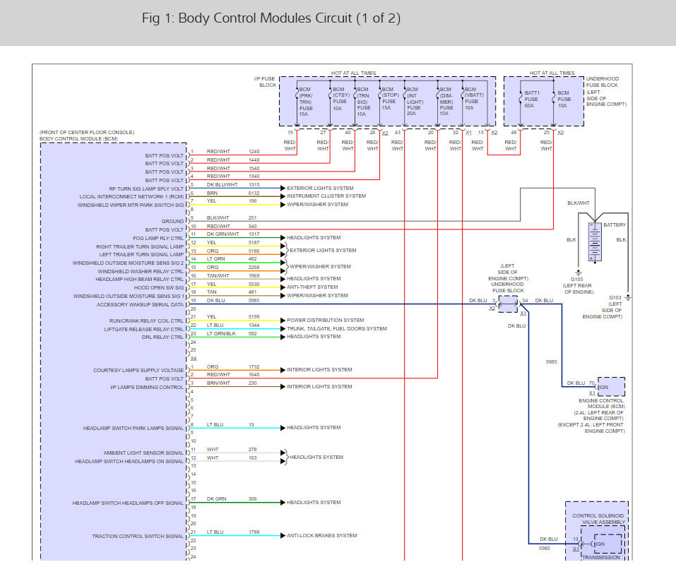

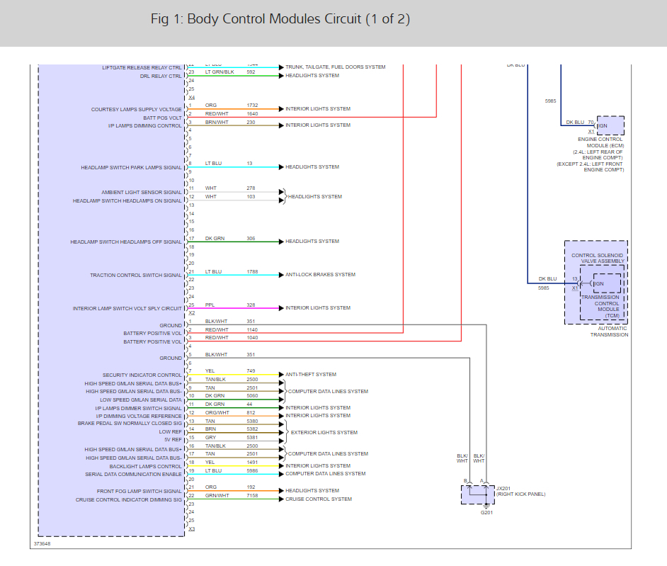

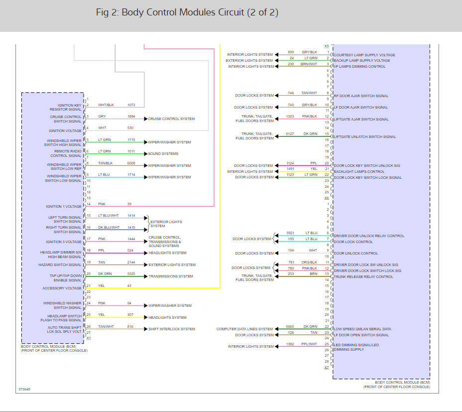

Yes, that is possible the dealer did not load the correct program but it could be you lost the ground or power input to the BCM. here is a guide to help check the connections and power with ground using the BCM wiring diagrams below:

Got BCM re-programmed at dealer today. No change. However, when I pulled the car in to the service center, they hooked a tool up under the dash and every single light worked. In my opinion, that tells me the wiring is okay, there must be a controller not functioning. If the BCM is not it, what else could it be? brake pedal switch is okay, I have noticed there is a computer under the second row passenger seat. Is that involved in the brake system? They also informed me that when programming a BCM, it either does a 100% program, or it boots them out. There is no such thing as a missing component or partial programming.

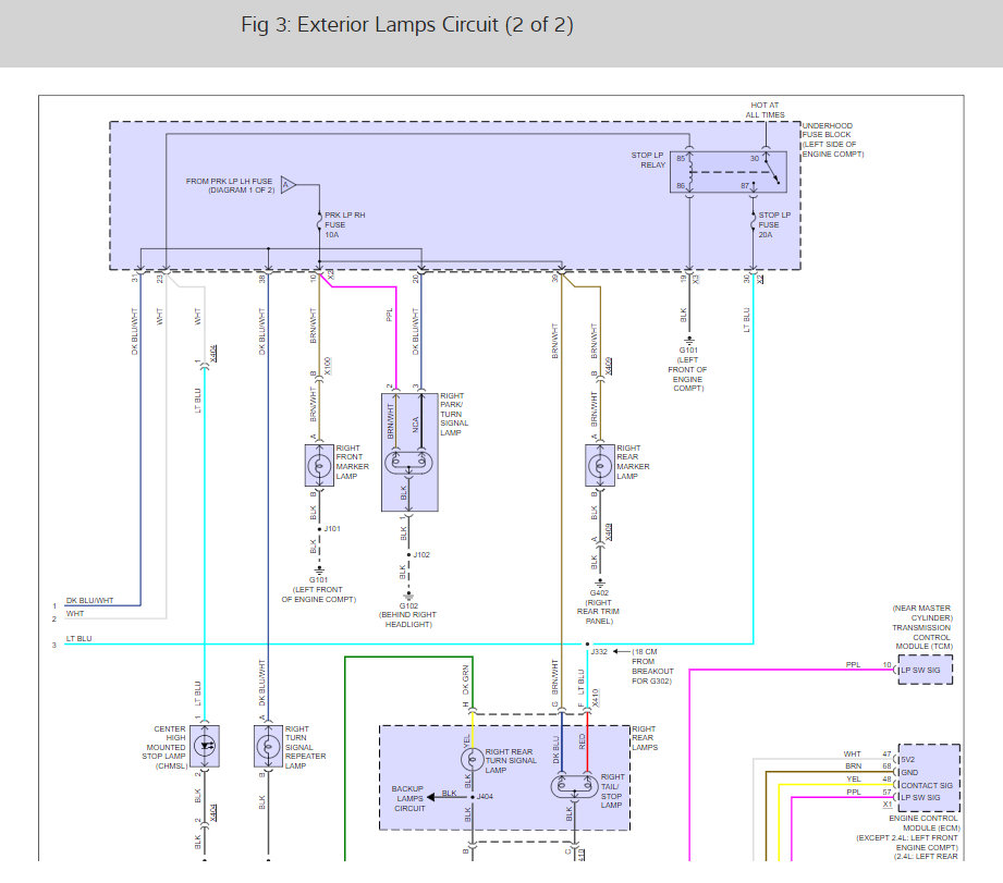

It sounds like a ground or power feed issue. Here is a guide to help test for power and grounds to the BCM and the wiring diagrams for the brake and tail lights:

After looking at your last diagram, I checked for power coming from ECM to brake pedal. no power. any short cut to figure out which connector on the ECM might be the one I'm looking for? there are three with multiple yellow wires each. Dealer told me Monday that ECM has no relevance on my brakes working. starting to really doubt these guys.

Yep, the yellow wire tells the ECM the switch has been grounded there is no power. Are the power and grounds okay going to the BCM?
