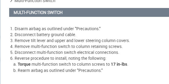

That is a great update. With that eliminated I would agree that the switch is most likely the issue. If it were me, I would go ahead and replace it. Attached are the instructions.

Great. Thanks! I pulled it yesterday to get a good look at it. Sure, contacts look ok but, it's 25 years old! It's a bit pricey but I'm replacing it anyway.
