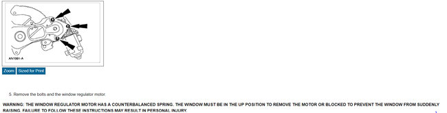

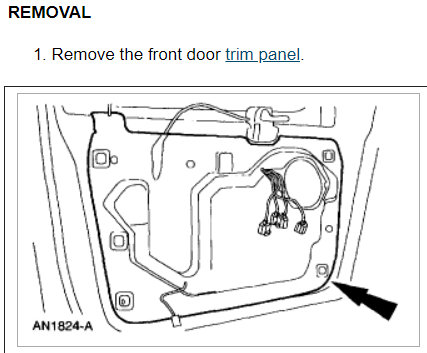

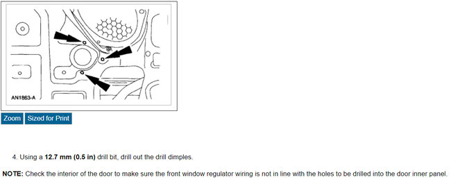

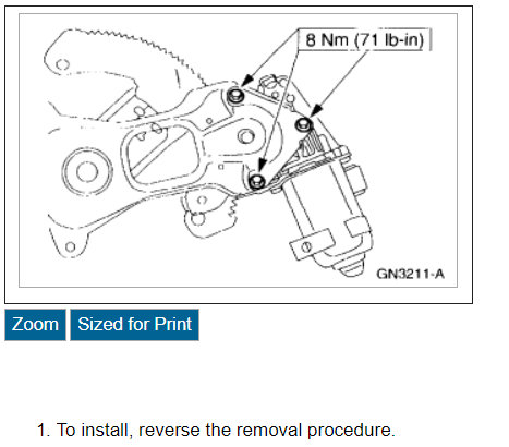

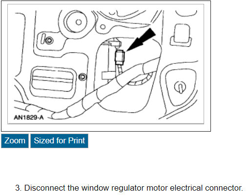

MERLIN2021
  • 17,250 POSTS

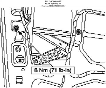

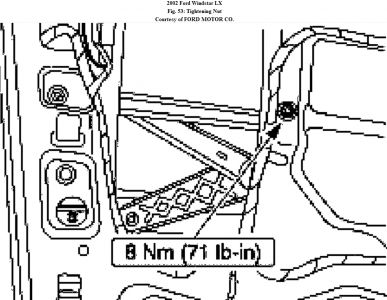

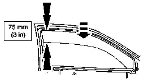

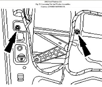

You probably need to check the glass adjustment here's how to adjust it: WINDOW GLASS ADJUSTMENT - FRONT 1. Remove the front door trim panel and watershield. Refer to TRIM PANEL -- FRONT DOOR . 2. Partially lower the front door window glass to within three inches of the full up position. Fig. 51: Removing Front Door Trim Panel And Watershield Courtesy of FORD MOTOR CO. 3. Loosen the nut and washer assemblies. Fig. 52: Loosening Nut And Washer Assemblies Courtesy of FORD MOTOR CO. 4. Open the front door. 5. Gently pull the front door window glass fully rearward into the door top glass run. 6. Tighten the nut. Fig. 53: Tightening Nut Courtesy of FORD MOTOR CO. 7. Apply downward pressure on the window regulator equalizer arm bracket. 8. Tighten the nut. Fig. 54: Tightening Nut Courtesy of FORD MOTOR CO. 9. Cycle the front door window glass to make sure of correct operation. Readjust the height if necessary. 10. Install the front door trim panel and watershield. Refer to TRIM PANEL -- FRONT DOOR . NOTE: If the hole is a vertical slotted hole, make sure that the nut and washer assembly is positioned at the bottom of the slot before downward pressure is applied to the window regulator equalizer arm bracket.
https://images.2carpros.com/forum/automotive_pictures/62217_window1_1.jpg
https://images.2carpros.com/forum/automotive_pictures/62217_window2_1.jpg
https://images.2carpros.com/forum/automotive_pictures/62217_window3_1.jpg
https://images.2carpros.com/forum/automotive_pictures/62217_window4_1.jpg
If this doesnt help, you need to have it scanned by a Ford capable scan tool to check the FEM(front electronic module).

The window seems well aligned and rearward in the track. It rides up smoothly with no jarring and into the upper track with even spacing as it slides in to the upper track. Won't adjusting it just mess up the alignment? Also, in step 9 you refer to "Readjust the height if necessary". Is this if the window does not go all the way into to upper track? Can it be set to go too high? How do I do this? What makes the motor cut off when the window reaches fully up and fully down? Does it have anything to do with the height adjustment?
May 4, 2020 at 8:12 AM (Merged)
MERLIN2021
  • 17,250 POSTS
The height is by the downward pressure to the equalizer, this will apply spring pressure at the top part of upward travel to help the motor.

LDALLENJR
  • 0 POST
Thank you it was the motor in my car got a new one for $56.00 I love this site.
