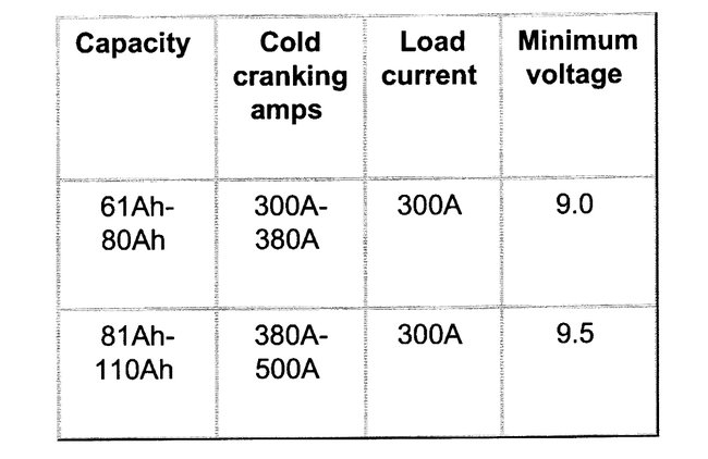

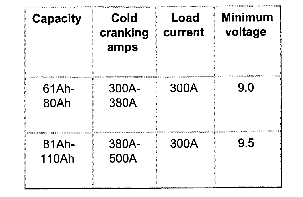

It could be the power reduction relay is shutting down power to the accessories. Load test the battery and check the battery charge rate. It may have a faulty battery or Alternator. I'm attaching repair guides and battery specs. Please let us know if this information was helpful and what fixed your vehicle. Let us know if you need more information.
