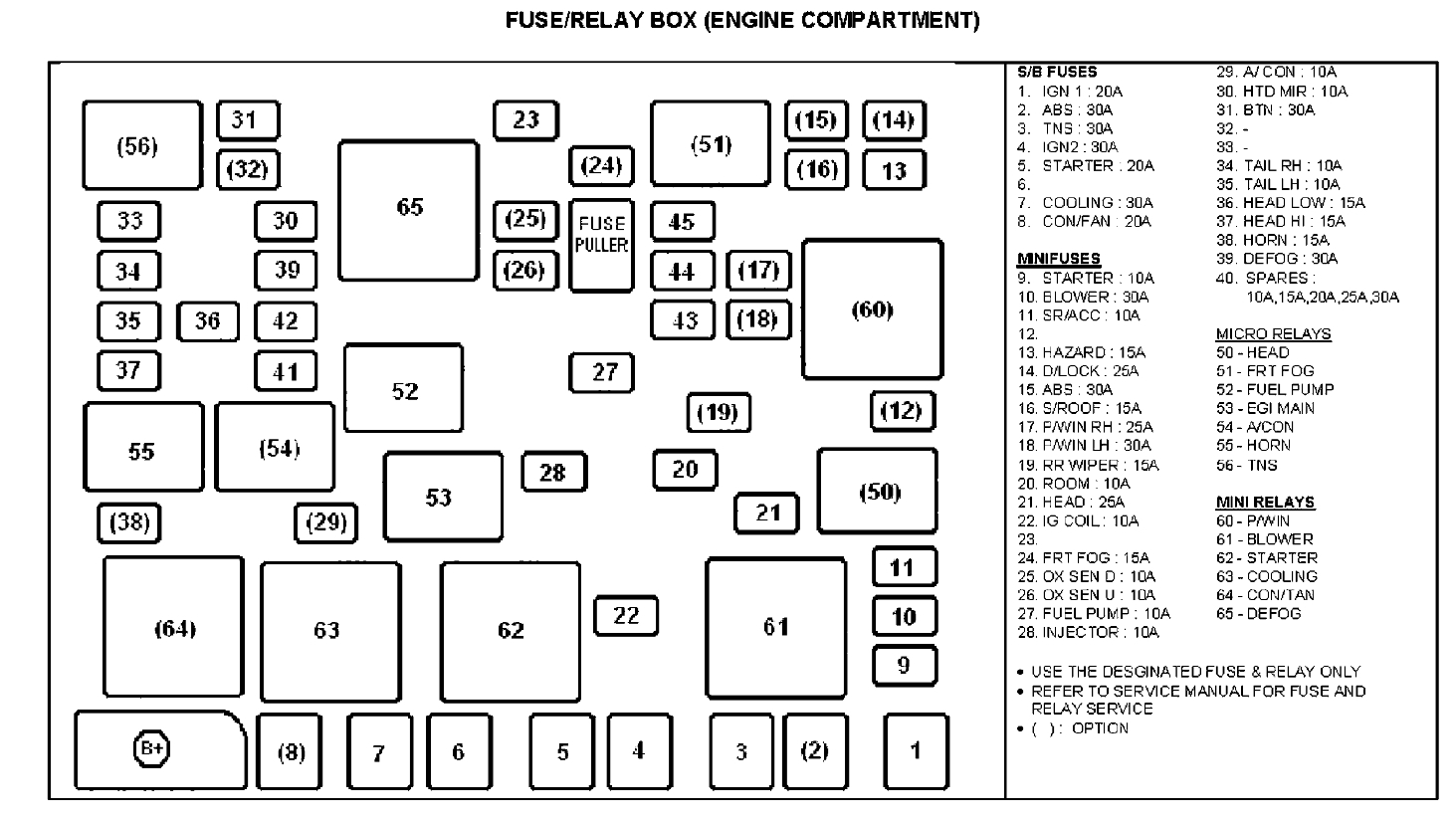

Power windows not working, interior lights not working, taillights, heat not working and blower not coming on.
Nov 29, 2022 at 10:19 PM
  • 55,433 POSTS

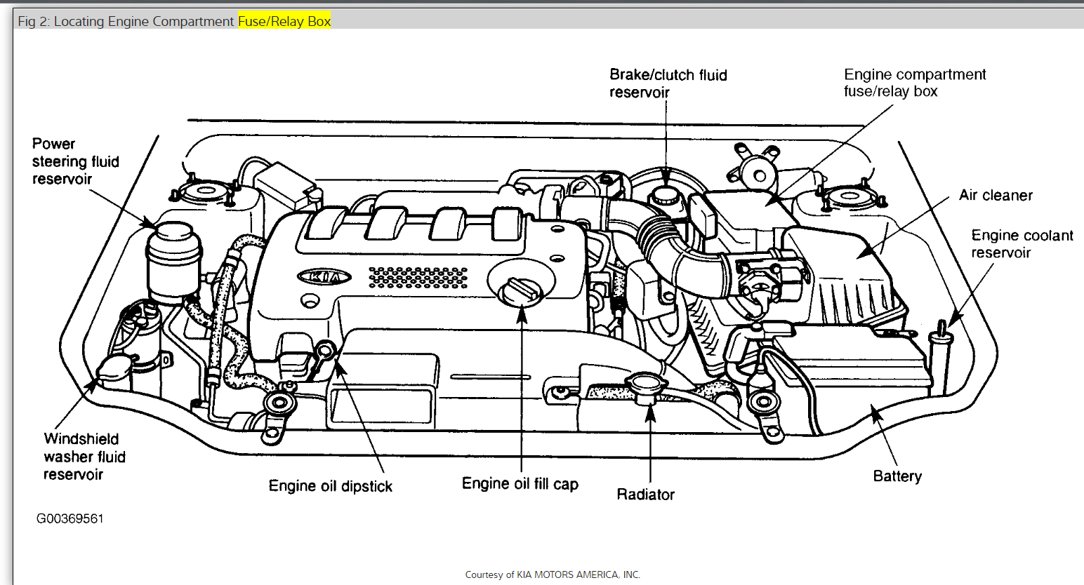

So, there is a TNS fuse 30 amp in the fuse panel #3 in the fuse panel under the hood that needs to be checked. here is a guide to help and the fuse location as well. If the fuse is okay the TNS relay #56 needs to be swapped out:
Check out the images (below). Please let us know what you find. We are interested to see what it is.
