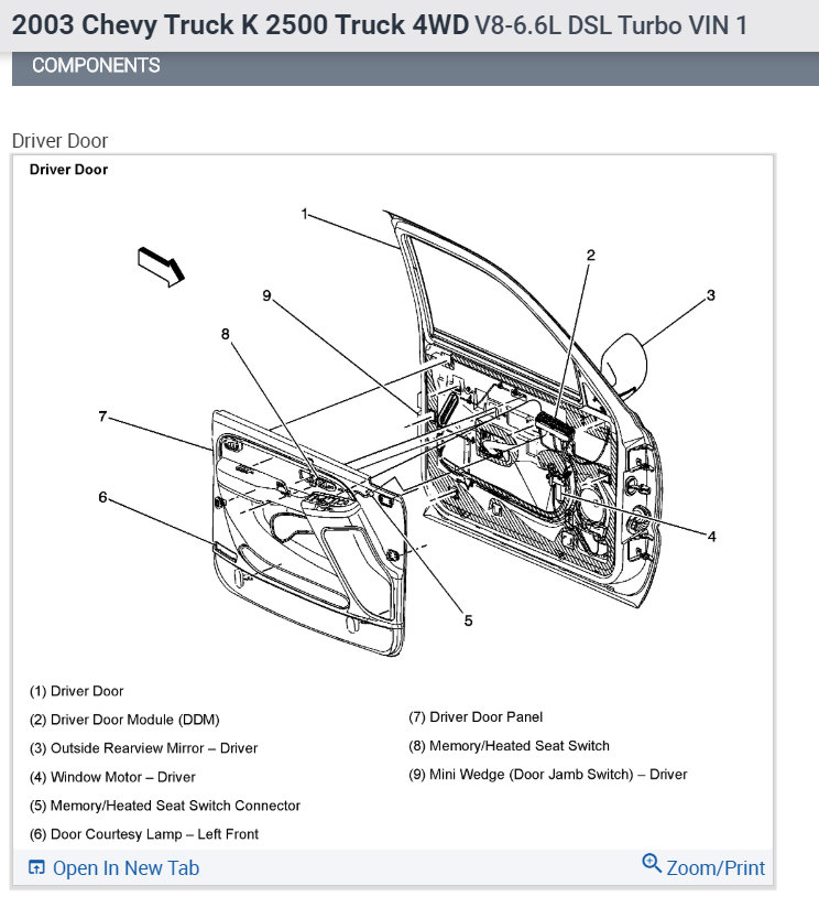

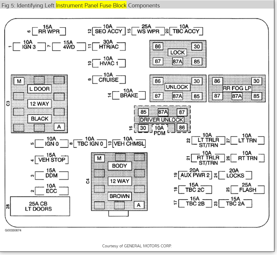

I have the truck listed above 3500 dually. the interior lights quit working, the radio quit working. the only two gauges that work on my instrument cluster are the speedometer and the tachometer. power seats still work, cigarette lighter still works and my gauge lights still working. power windows won't even work. I checked the BCM and according to the shop it's still good. For the life of me I cannot figure out what's going on.
May 16, 2020 at 12:26 AM
  • 55,333 POSTS

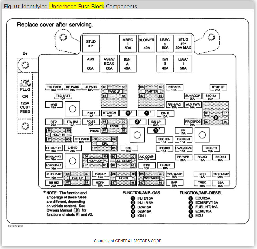

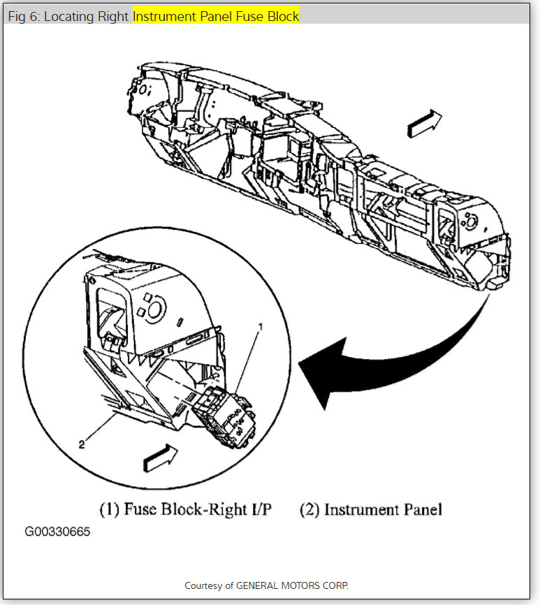

We should check the fuses first to see if there are all good. here is a guide and the fuse locations in the diagrams below as well:

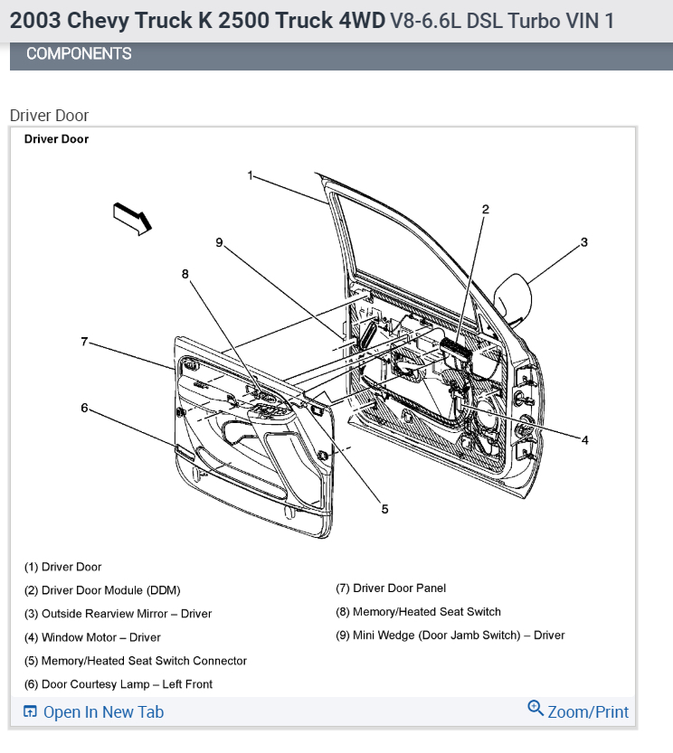

I have seen the drivers door module cause this issue. Here is the location and how to replace it in the diagrams below. Check out the diagrams (below). Please let us know what happens.
