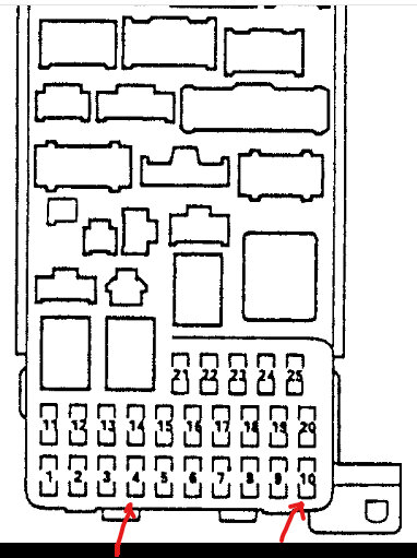

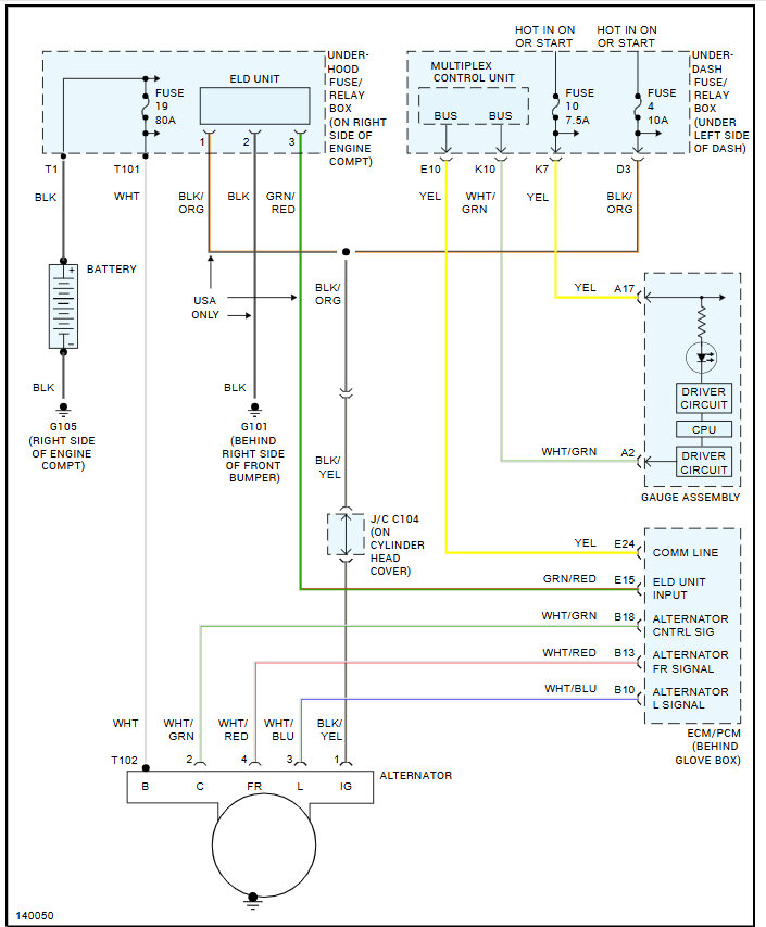

gauges randomly drop to zero, the lights dim and flicker?
2001 HONDA CIVIC
221,060 MILES • 2WD • AUTOMATIC
SJCLEM
I've already replaced the battery, alternator, and radiator, but the issue persists.
The car's gauges randomly drop to zero, the lights dim and flicker, and I eventually lose all power. I need someone with experience troubleshooting electrical or other potential issues with older Civics.

It sounds like the positive battery cable could be bad. Can I ask if the alternator is charging the battery when the engine is running? This guide can help us see:
If it is not charging let's check the fuse #10 and #4 in the under-dash fuse panel, this guide can help, and I have included the fuse locations as well.
Here are the wiring diagrams for the charging system as well so you can see how it works. Check out the images (below). Please let us know what happens.
