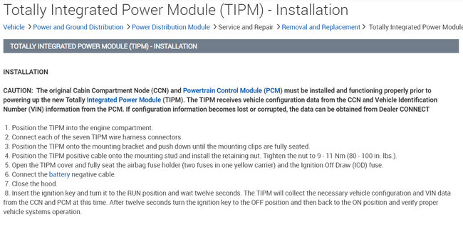

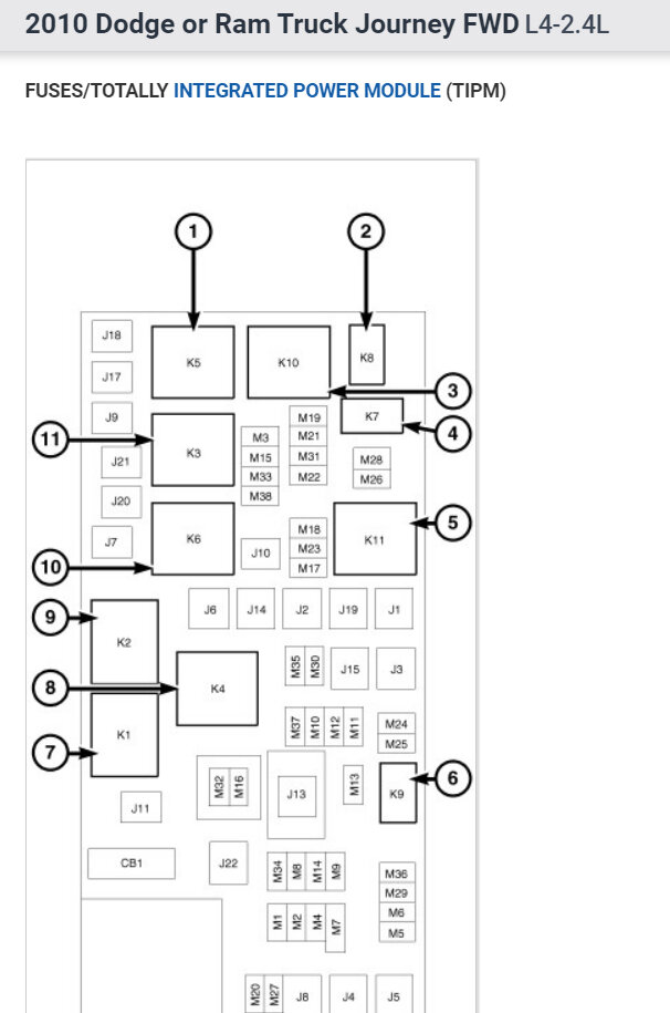

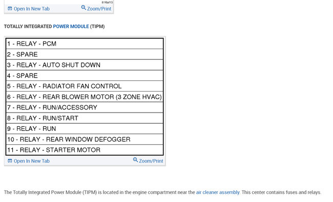

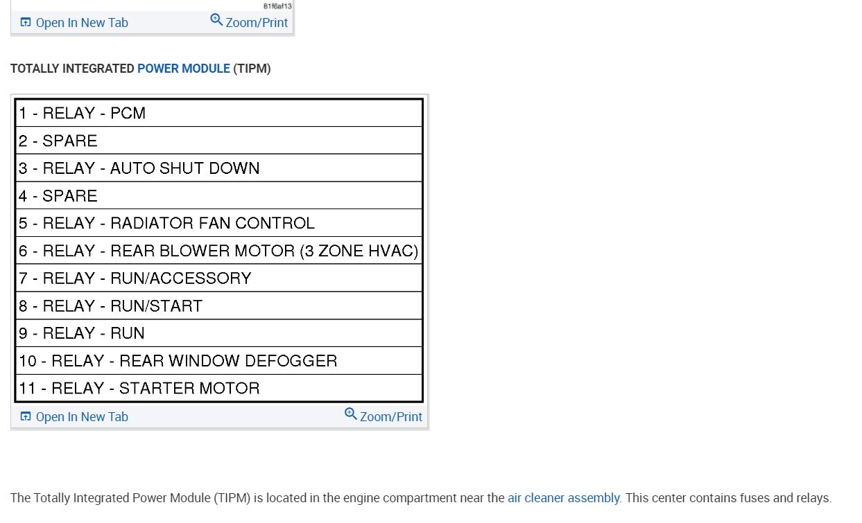

I have seen the TIPM go out and cause this problem, but to be sure we should do a CAN scan, you can get a CAN scanner (Controller Area Network) which will work on most cars from Amazon.
here is a video to show you how:
https://youtu.be/u-4syLc-ifQ

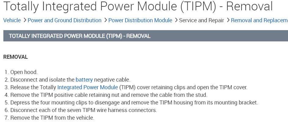

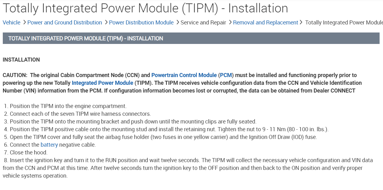

Here is how to change the TIPM out which is easy because it-self learns in the images below. Check out the images (below). Please let us know how it goes.
