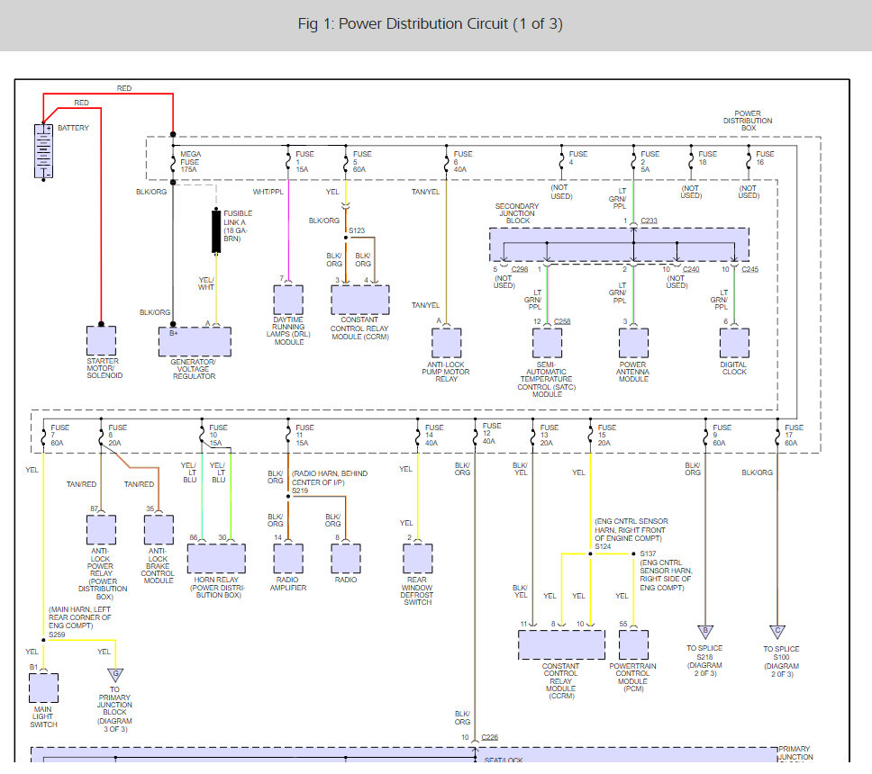

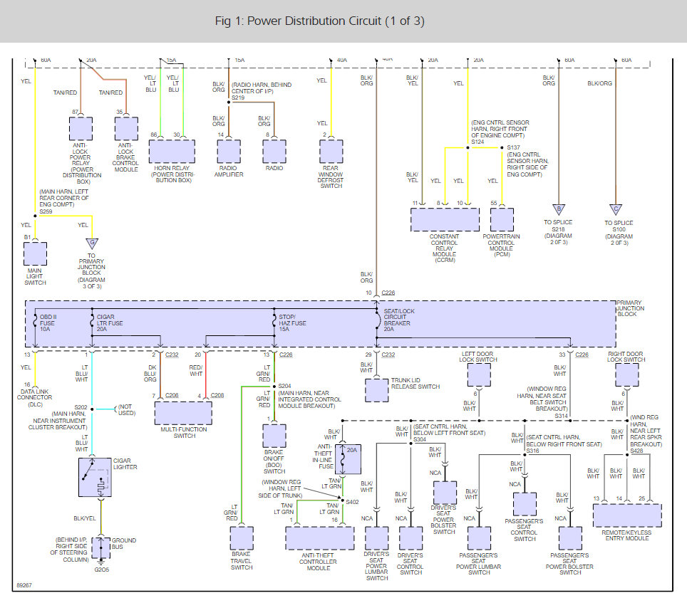

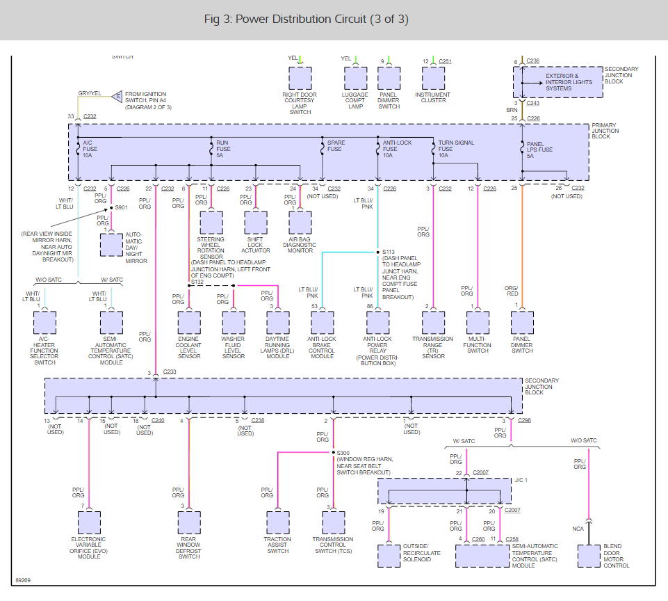

Dash lights do not work. climate control stopped working. heater fan stuck on high even with climate control removed. blinkers only work par time. no coolant fan. ready to junk it. replaced temp sensor, CCRM, integrated relay module. fuses look okay. checked fan by jumping with battery it is fine. checked ground wires. checked power supply.
Sep 29, 2017 at 11:27 AM
  • 55,433 POSTS

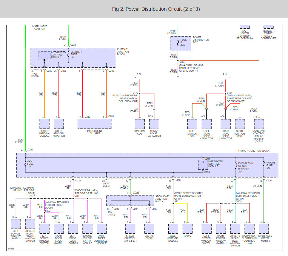

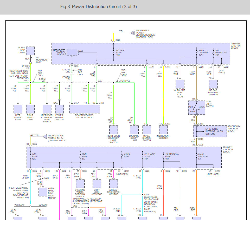

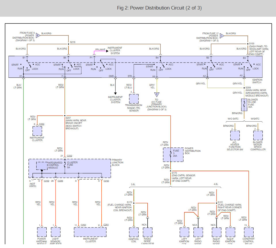

It sounds like you have an ignition switch that is out.
Here is a wiring diagrams so you can do some testing for power at the red and light green wire while following this guide:
Let me know if you don't have power at the wire with the key on then I will send instruction on how to replace the switch.
