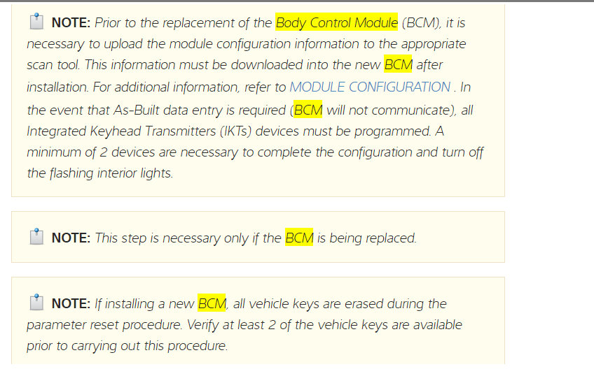

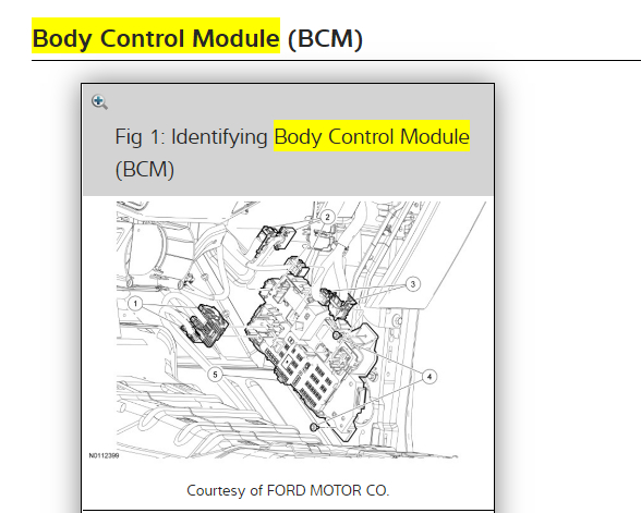

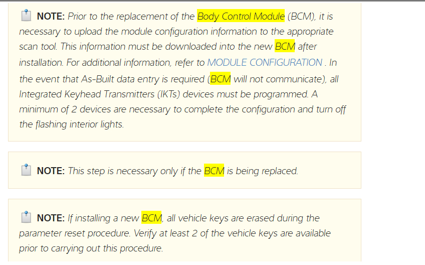

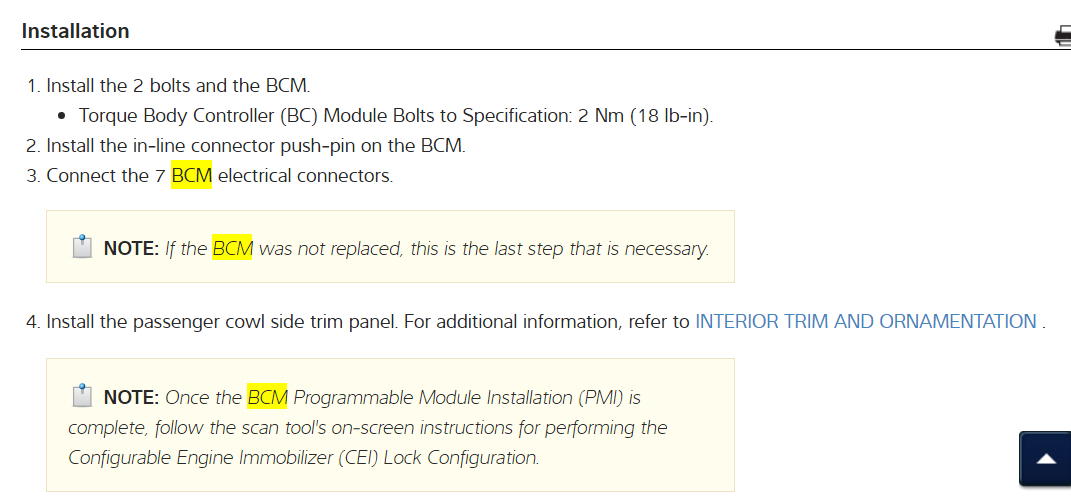

Driver and passenger side door ajar warning lights came on and they don't turn off. Check brake system warning light came on and wont turn off. Power door locks don't work at the interior door switch, but work on the remote. Dome lights won't turn off causing batteries to drain.
Oct 4, 2019 at 10:07 PM
SCGRANTURISMO
  • 4,897 POSTS

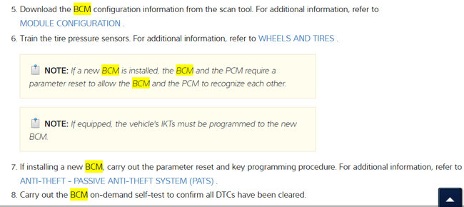

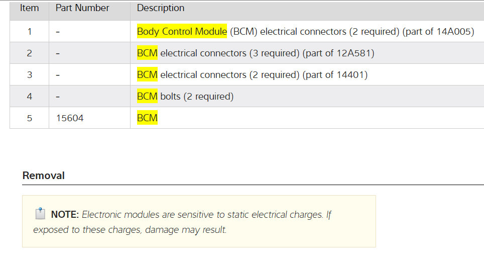

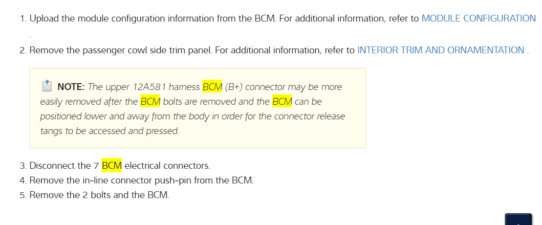

This sounds like you could be having a problem with your vehicle's Body Control Module (BCM). In the diagrams down below I have included instructions from the vehicle manufacturer on the removal and installation of your vehicle's BCM. Please go through this guide and get back to us with what you find out. The BCM will need to be reconfigured afterwards and will require special tools to do this. We have the instructions for how to do this and can send them right over to you if you wish.
