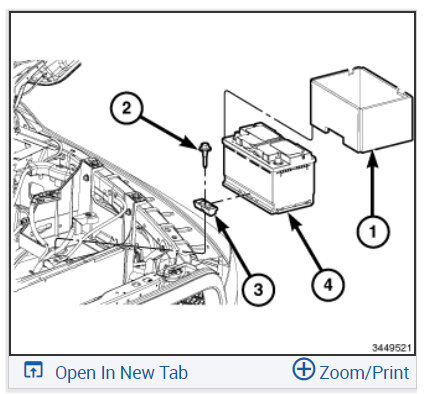

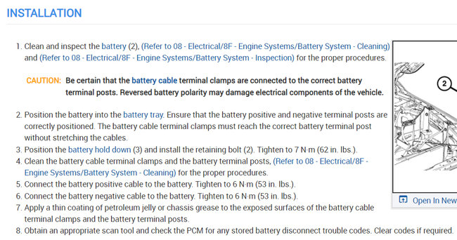

The battery can still be bad even though it looks good, I would remove the battery and take it to the auto parts store where they can test it. Is this the original battery? If so, it is very likely the battery needs to be replaced. Here is a guide to help you test the battery yourself, but I would try charging it first, here are 2 guides to help us fix the problem:
https://www.2carpros.com/articles/how-to-charge-your-car-battery
and
