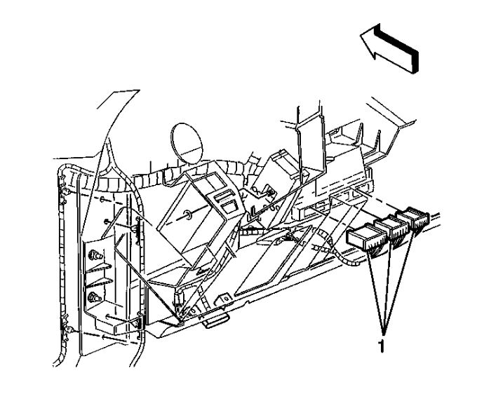

With my Z71 SUV shut down, ignition switch off, the rear window wiper comes on even with the rear window wiper switch in the off position.
While driving at night the headlights will shut off with the headlight switch in the “Auto” position. Cycling the switch off then on will turn headlights back on.
Drivers side door unlock switch works intermittently. Passenger side door lock switch works normally.
Drivers side seat heater will turn on randomly while the switch is in the off position.
Dec 16, 2018 at 1:57 PM
Good morning,
The one thing that all these components have in common is the body control module.
It is very possible you may have a bad connection or the actual module is the issue. If you have a scan tool, you could monitor the operation of the module and see if any codes are stored in the module.
It is under the drivers dash. I attached a picture for you to view.
