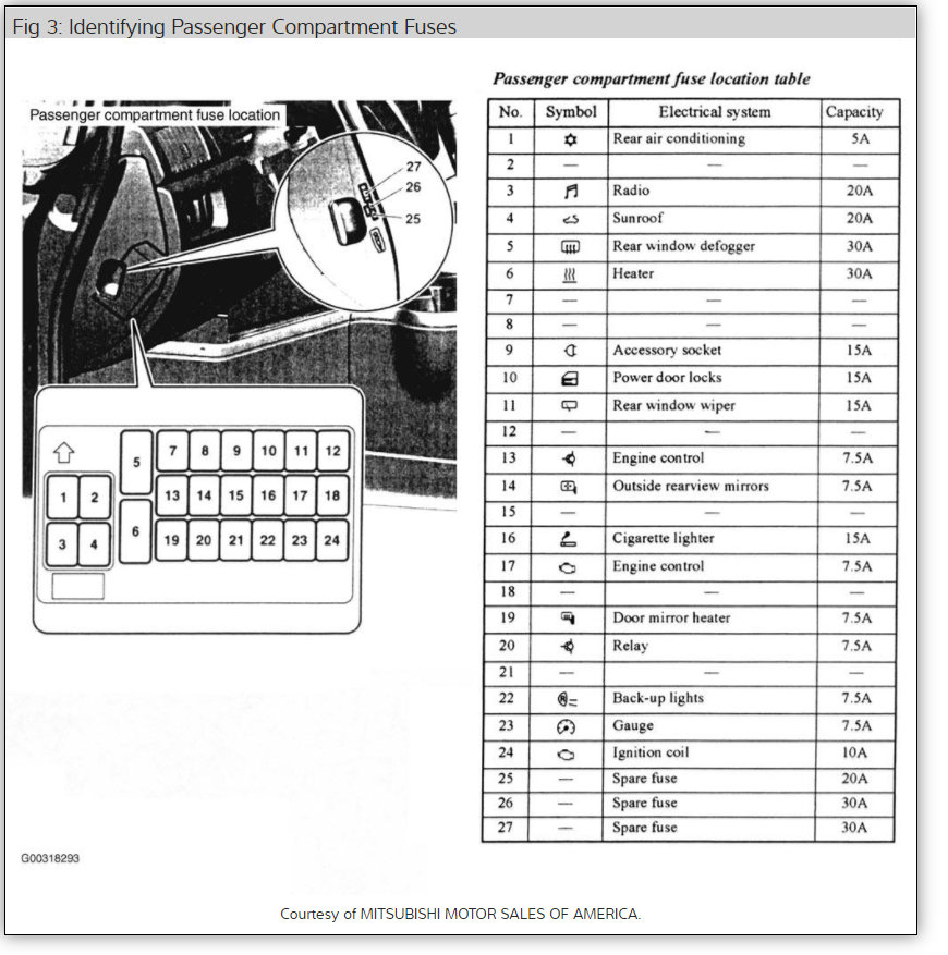

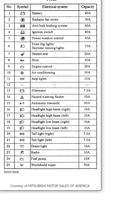

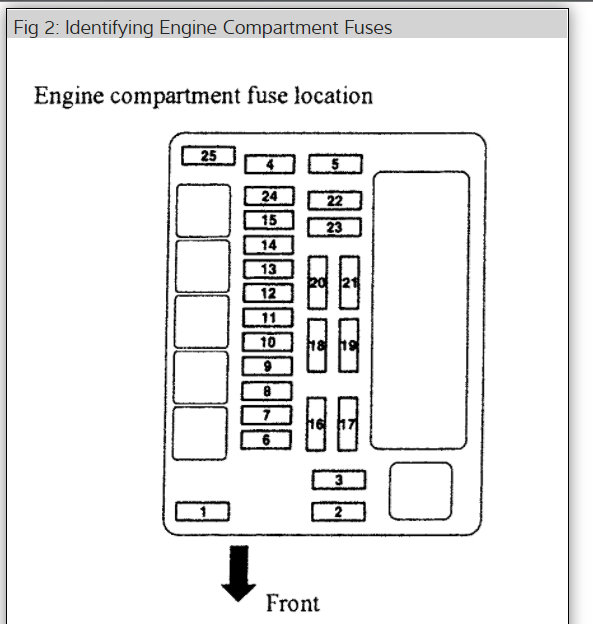

Windows don’t go up. You can’t hear the music on the radio or any mode. the only button that works is to lock and unlock the car. this randomly happened as I pulled into my house.
Mar 25, 2019 at 9:49 AM
  • 55,682 POSTS
It sound slike fuse #22 is out under the hood. here is a guide to help you check for power and the fuse location as well:
