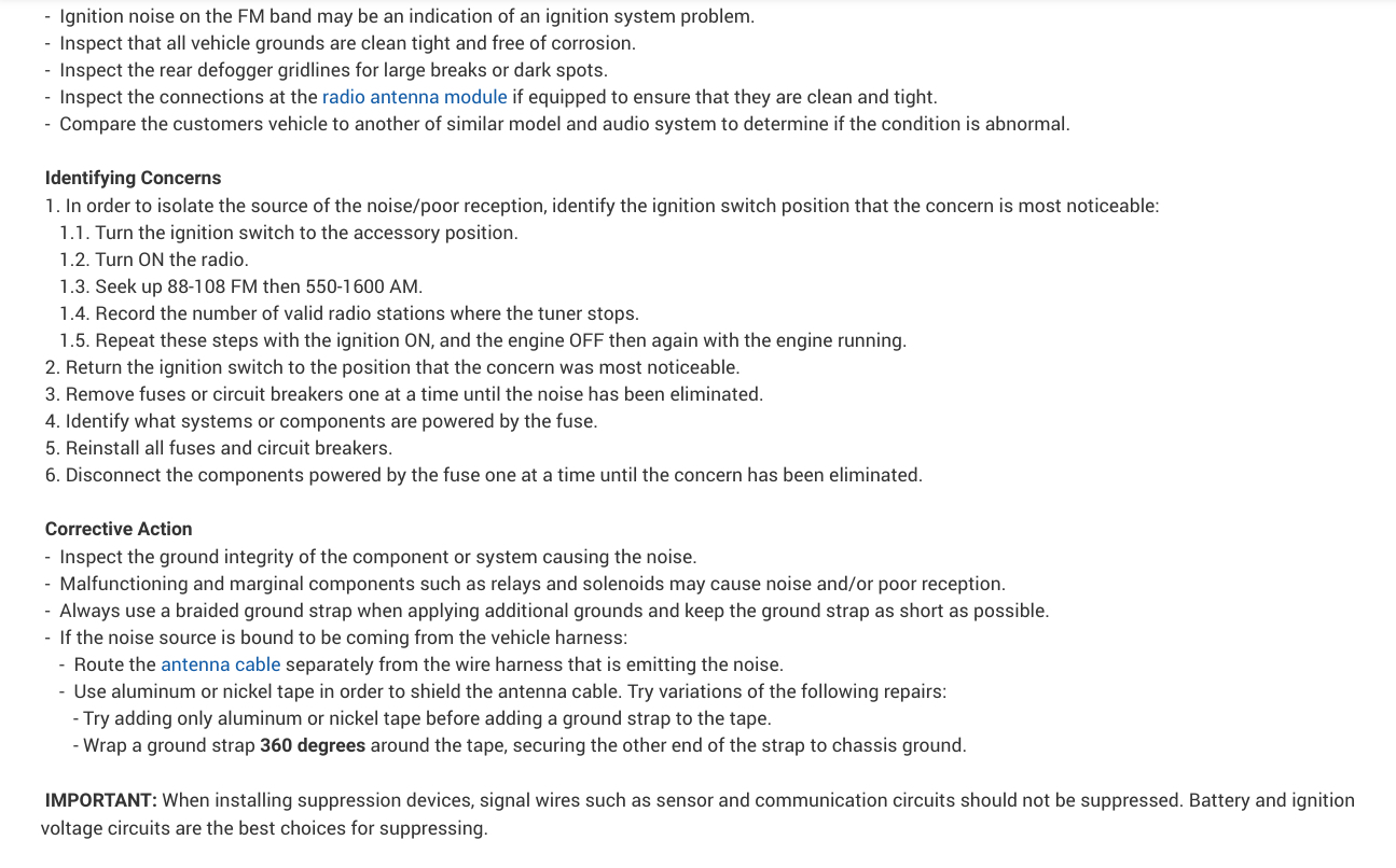

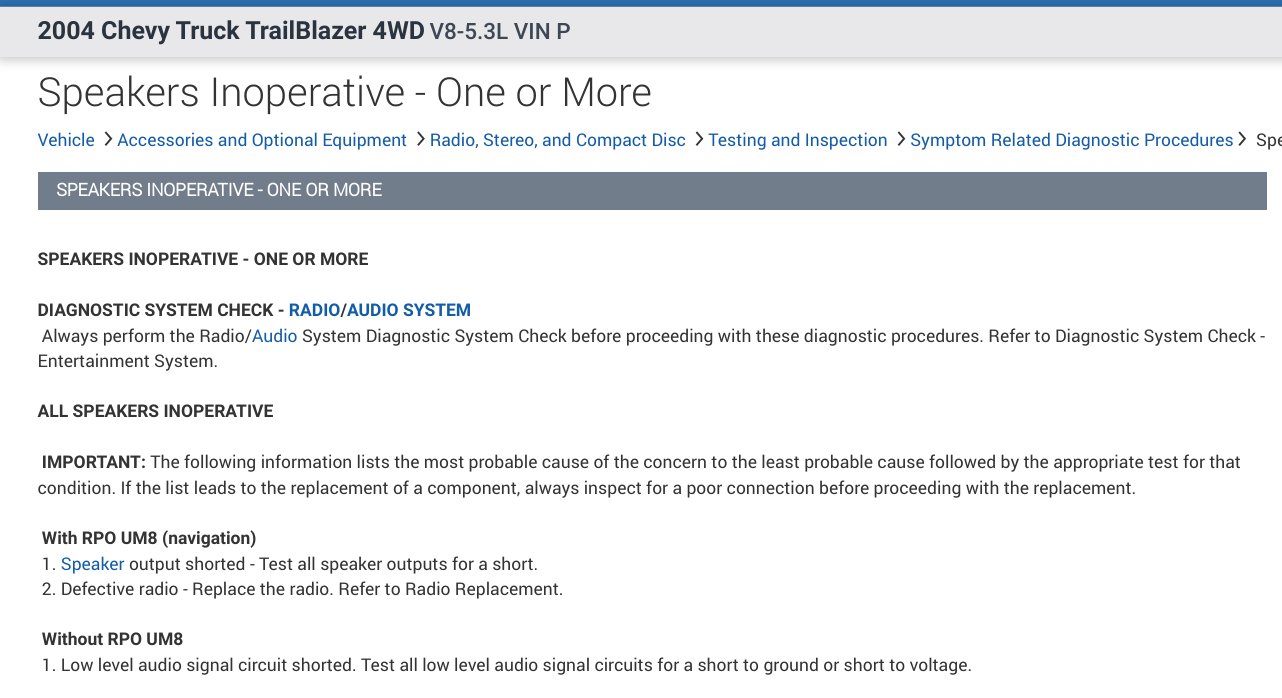

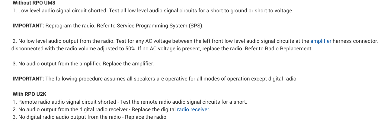

The chime of my vehicle listed above EXT model doesn't chimes and the radio doesn't make any sound. but it's on and you can see the stations or CD are working, just no sound at all.
Jan 25, 2020 at 4:50 AM
SCGRANTURISMO
  • 4,897 POSTS

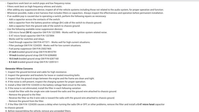

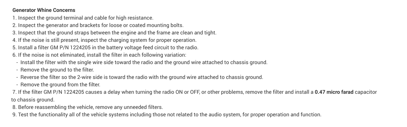

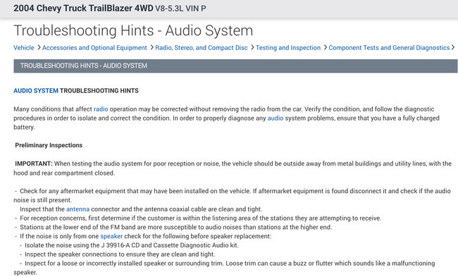

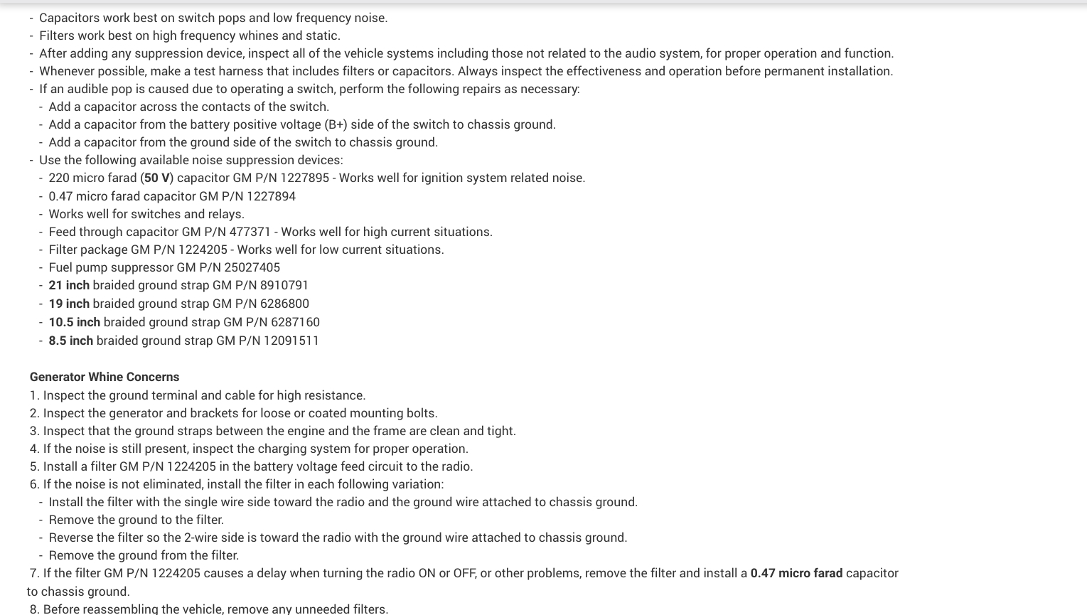

In the diagrams down below I have included the diagnostic troubleshooting guide for the Ausio system on your vehicle from the vehicle manufacturer. Please go through this guide and get back to us with what you are able to find out.
