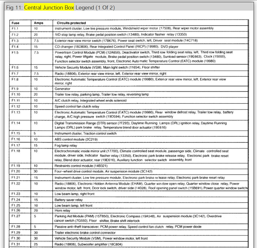

The sunroof, windows and radio are not working after I removed and reinstalled the instrument cluster. What did I do wrong and how can I fix it?

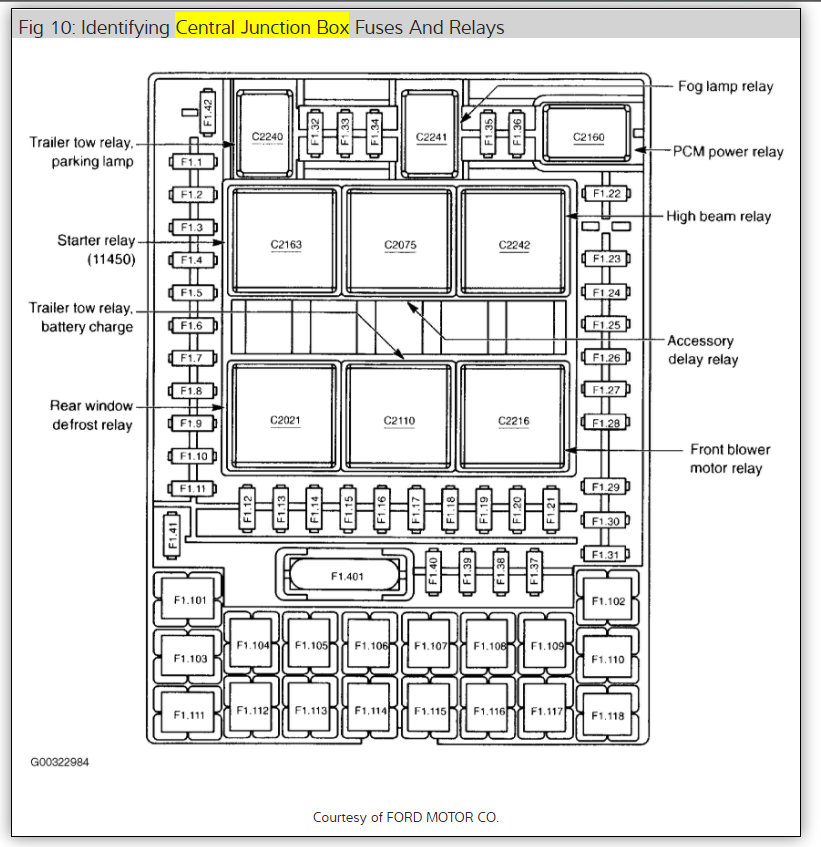

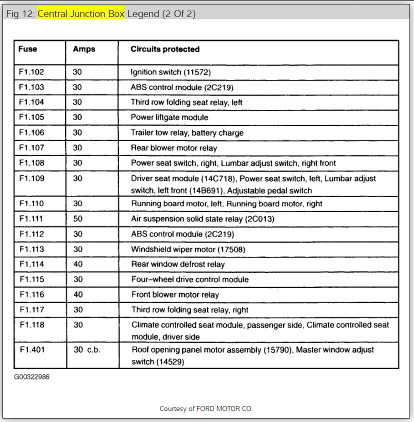

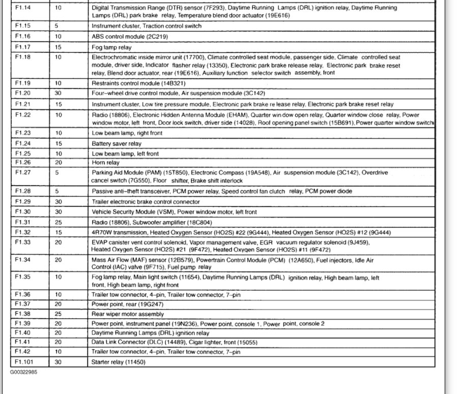

Can I ask if the instrument cluster was used or the same one? If used you will need to have it initialized (programmed) to work with the car. Can you see if you have power at fuse #f1.31 please? Here is a guide and the fuse location:
Check out the diagrams (below). Please let us know what you find.
