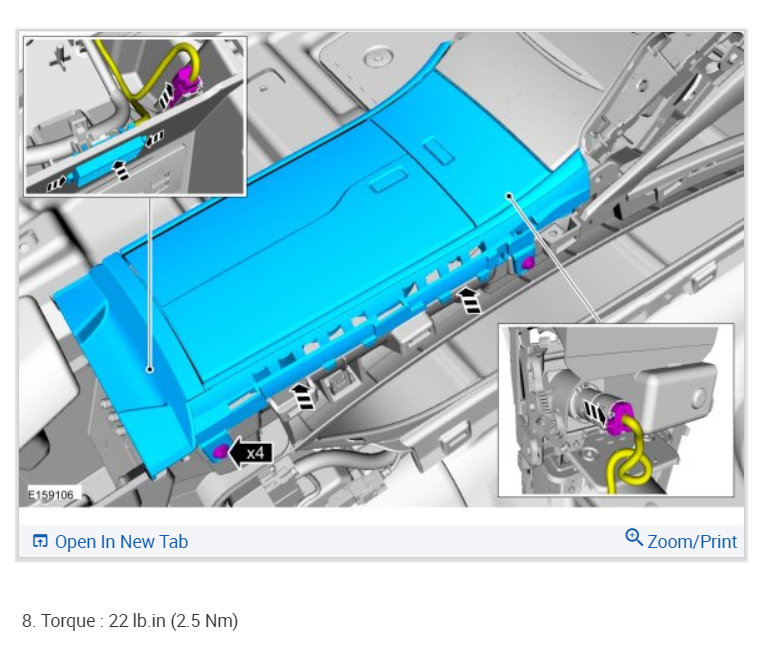

No climate control, and radio control, heater blower,cross trafic Gautier, blind spot system faulty, rear defrost, passenger power mirror, airbags. electric windows passenger side only works passenger side door front.
Aug 26, 2019 at 2:11 AM
  • 55,616 POSTS

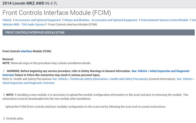

It sounds like the front interface control module is out. We should check the fuses first and run a CAN scan. here are two guides to help us fix the problem with diagrams below to show you how to replace the module if bad:

Here are the hybrid fuse panel, you can get a CAN scanner from Amazon for about $34.00:
https://www.amazon.com/gp/product/B007XE8C74/ref=as_li_qf_asin_il_tl?ie=UTF8&tag=2carprcom-20&creative=9325&linkCode=as2&creativeASIN=B007XE8C74&linkId=dc5e47e62fd1fb60fcb987399eb9edd0
Check out the diagrams (below). Please let us know what you find. We are interested to see what it is. Test with the key on make sure power is on both sides of the fuse.
